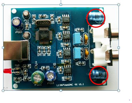

Your *4 DAC doesn't have any opamps, its using passive I/V. I suspect (but can't see clearly from the picture) that your I/V resistors are between the two capacitors near the RCA outs (a rectangular blue one and a yellow bead). Yes you've correctly identified the coupling caps.
I don't know what an 'SSMH amp' is, sorry. I think the answer will be 'you'll hear music' but of course you'd need to connect a USB source to it.
I don’t understand what you mean with the I/V resistor. I thought this is the opamp used to convert the current from the DAC chip into an analogue voltage. It seems to me the 4x TDA1387 doesn’t have one. Are the capacitors with the red circle the coupling capacitors?
What will happen if I just connect this DAC with an RCA cable to the input of my SSMH amp?
Just to be clear, two fairly different DACs have been discussed in this thread. The bulk of the posts (and the original subject) was not about the 4x DAC you pictured, but instead about a DAC with 8x tda1387 chips. I'm not trying to be the thread topic police, just trying to make it clear that you have to be careful about the context, i.e. are we talking about the 4x or the 8x.
So, indeed, the 4x DAC you're talking about does not have opamps. (That's a feature of the main topic of this thread, the 8x DAC.)
The caps you circled are the coupling caps, and I believe their purpose is for blocking DC (from preventing it from entering your amp). All the amps I've been working with have their own DC blocking capacitors, so technically I don't need them on my DAC. But I'm not sure about your amp, you'd have to check. Generally you don't want DC going into your amp, and if it reaches your speakers, it can damage them (presumably it can damage some amps too).

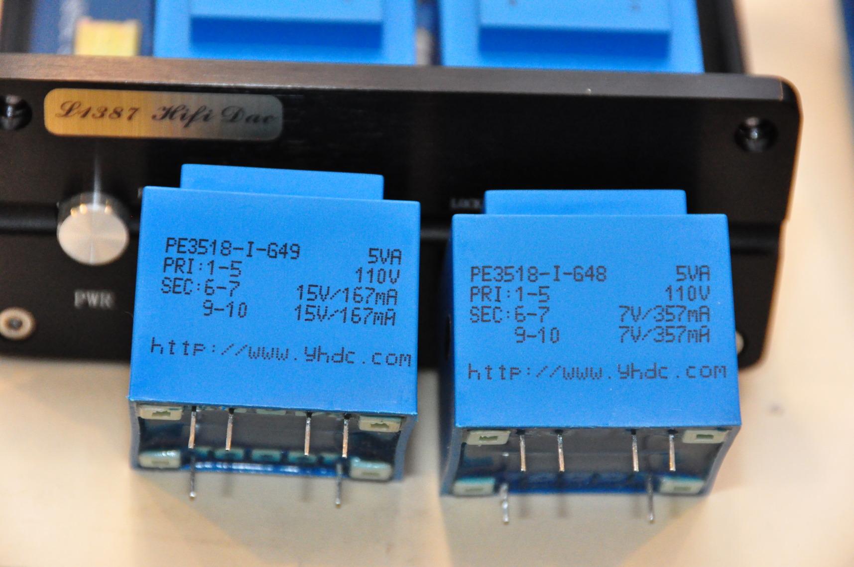

Received some goodies from China tonight: another one of these tda1387 x8 with stock 110v transformers, and two additional 110v transformers. Listening to the stock 110v version as I type this. Not as refined as the modded one, but not offensive. In fact this one sounds better than how I remember the stock 220v sounding. Maybe there's some goodness in avoiding the 110-to-220 external transformer I have for the other one? (Or maybe it's just because I'm forced to keep the volume down with the kids in bed.)
In the pics below are the standalone 110v transformers. Note the 220 version has 7.5V for the digital side, while the 110 version has 7.0V. Doesn't appear to be an issue...
The other pic is the stock 110 on the left, with my modded 220 on the right. New stock version has electrolytic caps for DC-blocking, oh no! 🙂

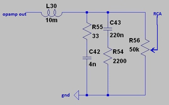

I'm reviewing post #24 and #25 on page 3 for the NOS droop filter:
I've been listening now for an hour or so and this filter's definitely for keeps. The rise in HF response makes it sound just a tad more transparent and I'm getting more of an 'in focus' sound, closer to my reference DAC. Here's a hasty sketch of how to connect the filter (pink lines although only one RC network is shown in the sketch). I took out the square blue coupling caps as I already have input caps on my active speakers. If you need to preserve AC coupling move these caps to the output of the LC filter board - the Coilcraft inductors sit (face down) on my board where these caps used to be.
The circuit in post #24 seems quite straightforward. But I don't quite understand the pink lines in your drawing in post #25. Looks like you have a line (in series with the cap+resistor) going to one leg of the yellow capacitor (which you X'ed out). It looks like that leg goes right to ground. But I don't see a ground in your circuit diagram in the previous post.
I think once I get this straightened out, I'll be ready for the next mod(s). What do you suggest? Might as well start preparing.
Thanks again!
The ground is there, just LTSpice turned it through 90degrees (pointing left).
The X'd capacitor is to be removed.
Ahh, that's the triangle, right? Guess I expected ground to be three parallel lines in decreasing length, but a quick Google shows different types of ground have different symbols. 😱
Is the attached pic correct then? (I understand that 50k resistor is optional, for volume control.)
Yep - the 50k is part of the next box in the chain, not required in the DAC.

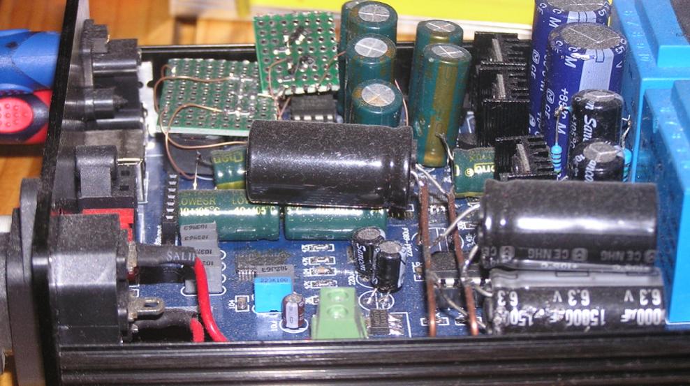

Here's a picture of the first generation mods (opamps still extant) applied to my first DAC. The small green perfboard pieces are doing the LC filtering (that's the one to the left) and the smaller of the two boards has two current sources on it which counteract the offset current out of the DAC chips.

No link to case at all, just brought RCA's ground back to supply and no more after opamp's filter one.
Hi Malefoda, if you're still following this thread, this is from post #53, back on page 6:
Is that black wire on the bottom of the board for what Abraxalito mentioned back in post #6 on page 1:
And on the topside of the board, it looks like you cut that big trace between the blue and yellow caps, right?
Rather than cutting the trace, would it make any more sense to cut the RCA ground lead, and directly connect that to the transformer ground? Can that be run to chassis ground? Or the the earth pin of the mains?
Also, what are those little SMT capacitors on either side of the black wire on the bottom of the board?
