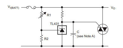

Yeah - you'll want to check that the AC is coming in fine to the rectifier, which is the middle one of the three on the reverse side of the PCB.
Then check the DC on the cap being fed by that rectifier. Then check the 47R resistor is in circuit - in normal operation it should have 5 or 6V drop across it. Seeing as you're getting 0V on the 5V test point it indicates either a short to GND or an open of the 47R or rectifier.
The shunt reg schematic can be found in the TI TL431 datasheet - the one I have is 'revised Jan 2015' its fig 31 on page 26 'High Current Shunt Regulator'. R1, R2 are 3K and the unnamed resistor at the transistor B-E is 300ohm.

Just checking on the rectifier tests, is this the diagram you were referring to?

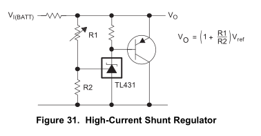

The circuit you're showing is fig32 in my DS, fig31 is below.
2.5V on the DAC supply is just enough to get some current out but will give about half the output (so 1VRMS rather than 2VRMS). 2.5V might also lose you some dynamics as 3V is the minimum recommended working voltage for the DACs.
Given you're getting 2.5V check for a short across R1 (from the fig31 schematic) or perhaps the wrong value (should be 3k, its on the underside on my V1.1 board here). 7.43V across the resistor seems reasonable for only 2.5V output, the 2SA940 should just be getting warm.

Thanks abraxalito, you just beat me to it. Found the issue with the 3K resistor on the underside of the board, solder a new one in place and now getting 5V on the dac chips.

Count yourself fortunate it was R1 which had the issue and not R2 🙂 If R2 was shorted the shunt wouldn't draw any current at all and would likely have taken out your two DAC chips through over-voltage. You do though have 6 spares so you'd have survived that scenario 😀

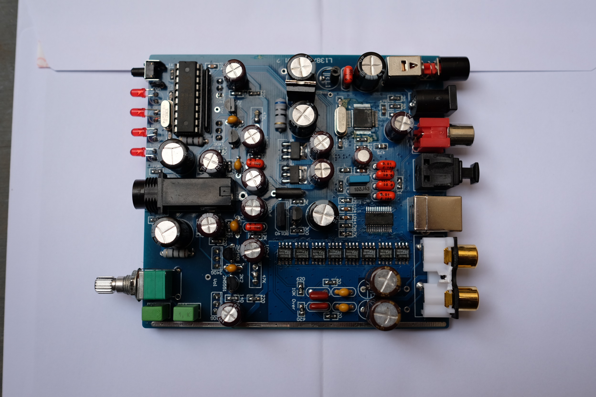

L1387A DAC 8X V1.2
Someone tried this dac? sold as "L1387A 8X decode 1969".

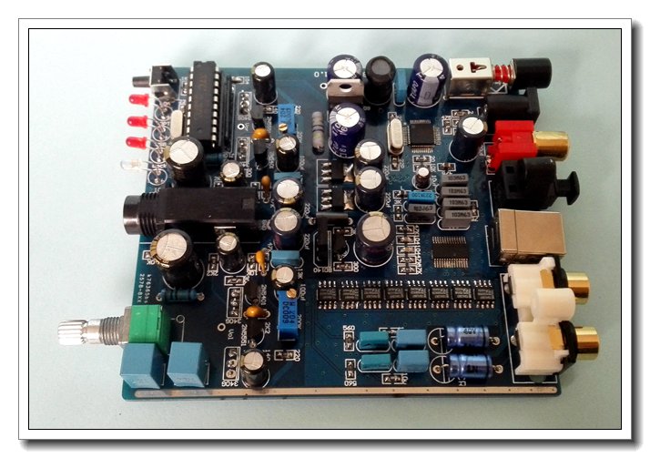

I just replaced the ouput caps out of curiosity as I had a pair of Elna Silmic II 33uF 25V.

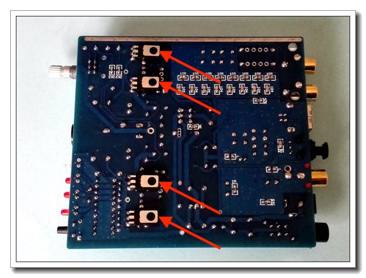

It "sounds" not bad at all (to me, at least..) but quickly gets hot.. see picture with red arrows.
I wonder if it is the headphones section, if that's the case I would like to completely disable it as I don't use it. But don't know where to cut the trace.
From memory - I've modded one or two of these - those 'hot bits' are the output transistors for the headphone amp. If you don't need that functionality simply unsolder or snip out those transistors.
BTW there is one potentiometer - that green plastic thing with the splined metal shaft, bottom left in your photos.
Done, thanks! it runs a lot cooler now.
I removed the pot and jack socket too.
