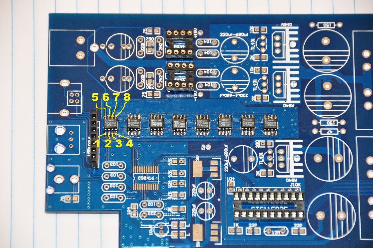

Emphasis added. To which eight underside caps are you referring? My PCB has 16 caps on the underside, directly beneath the tda1387 ICs. Half are labeled "104" and half are labeled "105". Looks like "104" corresponds to pin 8 (right channel output) and "105" corresponds to pin 6 (left channel output). I don't see any caps on the bottom that correspond to pin 7.
I'm waffling between hacking on the pre-assembled build, or leaving it stock, and applying hacks to the bare board, as I build it up. I'm not sure if I can pull of soldering the cs8416 chip though. As best I can tell, it looks like the connection between the cs8416 and the tda1387s is like this:

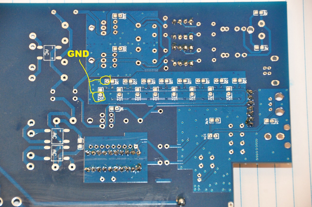

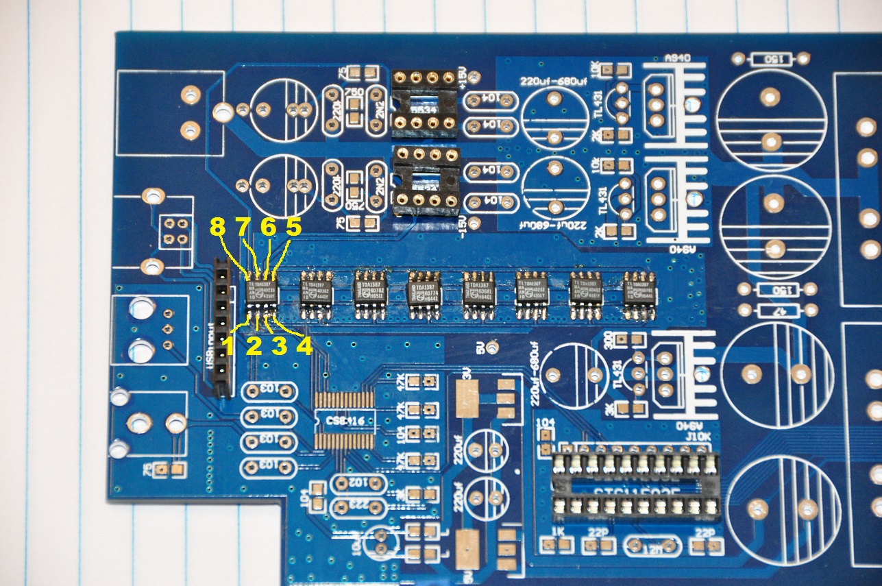

Perhaps you're getting disorientated from flipping the PCB over. The caps I'm referring to are those marked '105'. The '104' caps are wired to decouple the power to the TDA1387, so between 4 (GND) and 5 - there's a via visible leading to pin5. The '105's also have a visible via leading up to pin7. No vias exist for pin6 or pin8 - the tracks paralleling those outputs are on the top side. By all means create a simple PCB - kick off a thread and if you have layout questions I'll chip in.
I'm working off the mostly bare PCB, where all I've done so far is solder on the tda1387 chips. I was using my ohm meter to try to get a feel for what goes where.
I just double-checked: if I put a probe on pin 8, and a probe on one of the '104' pads on the other side of the PCB, I get 0 ohms (probes are basically pointing at each other). Same goes for pin 6 and the '105' pads. None of those pads seems to have 0 ohms with pin 5. On '105' I get about 1.7k ohms and pin 7.
I'm part-way through modding one of my PCBs which I've pulled the trafos and main 'lytics out of. I get continuity between the legend side of the '105' cap and pin7 for the TDA1387 nearest the trafos. Also pin5 gives continuity to the side opposite the legend on the '104' cap for the same chip. Pin4 connects to the other side (legended) of this same cap. No continuity to either pin6 or pin8 with those pins. So if both of us are correct our PCBs are totally different.
Maybe we're referring to the tda1387 pins differently? I attached a picture showing my understanding of the pins. I think that might be the source of our confusion. As labeled, those backside caps are tied to pins 6 and 8. However, if you imagine IC rotated 180 degress (but the labels stay in place), then the caps are tied to pins 5 and 7.
That comment doesn't make any sense.
What I should have said is: if you reverse the numbering on the analog side, i.e., 8-7-6-5 (instead of 5-6-7-8), then we are in agreement.
I'm almost positive my labeling of the digital side is correct, because those tie to the pins of that digital receiver chip, as I described a few posts above.
edit - I just reviewed the data sheet, indeed my labeling is incorrect. It should be 8-7-6-5.
Now it all makes sense. Sorry for the noise and confusion!
OK, here are updated pics with the pins correctly labeled, both on the front and back.
I apologize again, total reading comprehension failure on my part.

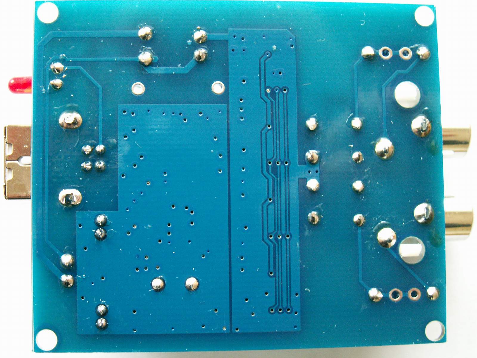

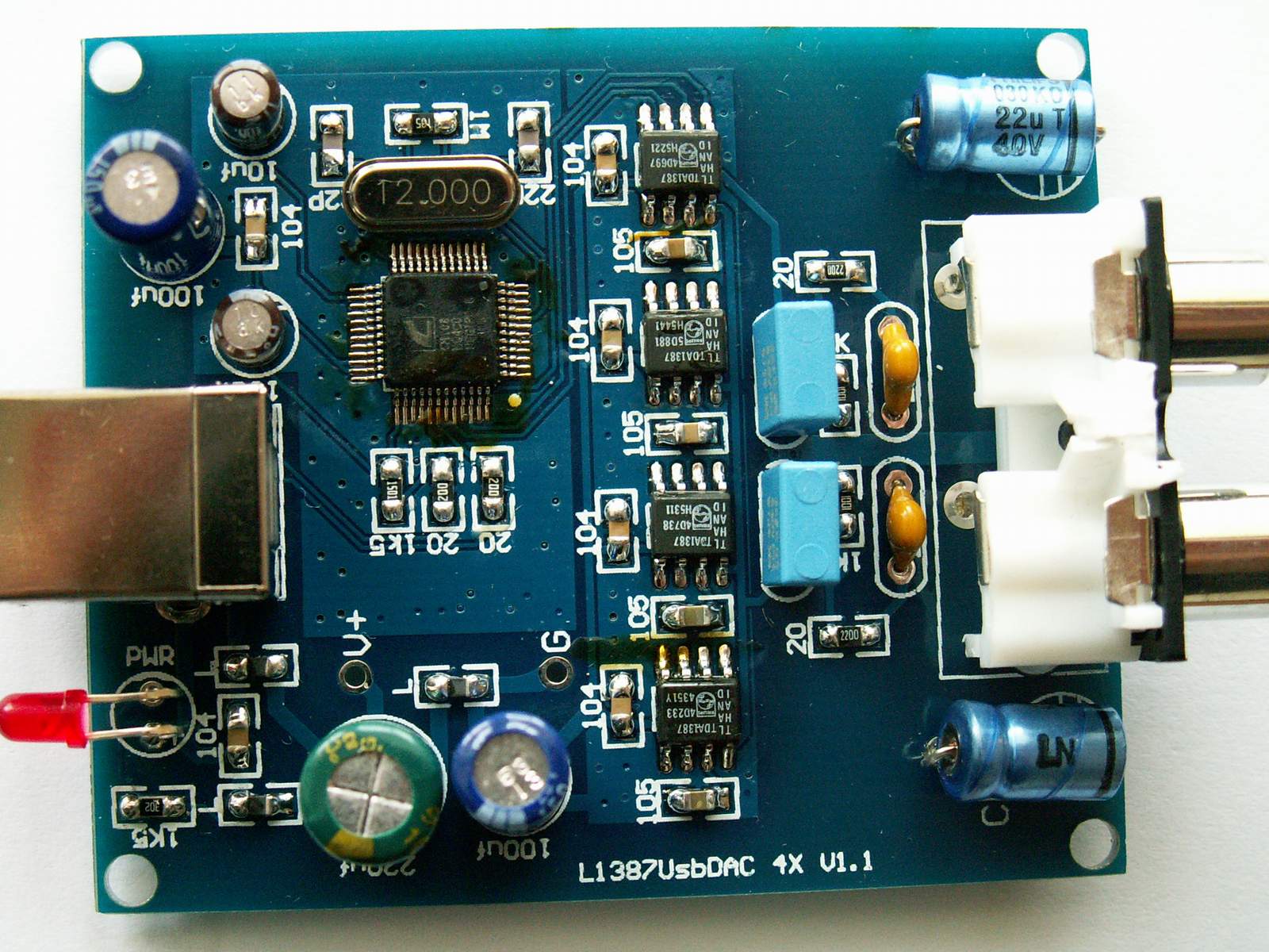

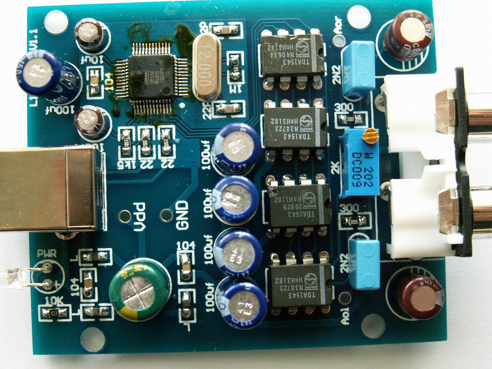

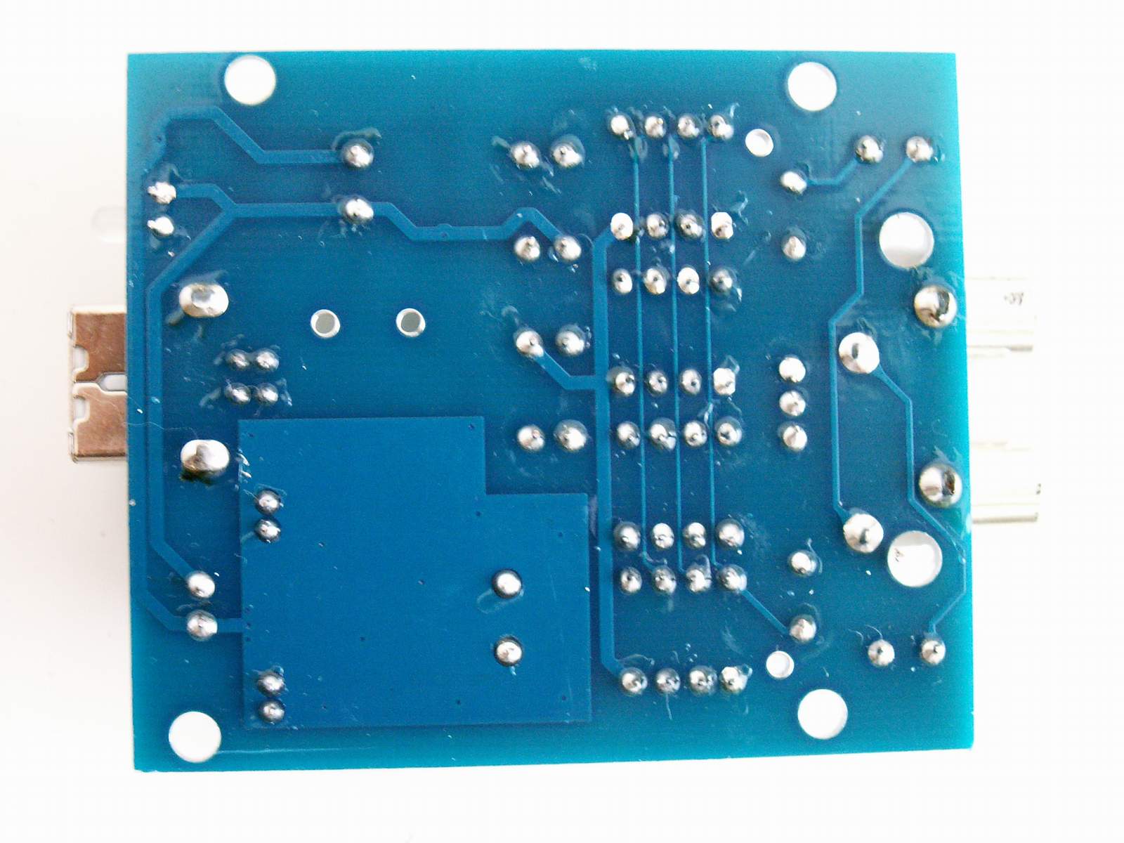

Here are 4x tda1387 and 4x tda1543
Also, here's another tda1387 DAC. Same seller, only $39 (free shipping). Obviously much simpler: 4x tda1387. Appears to be USB-powered, and direct-out from the DAC chips?
Abraxalito, what are your thoughts on tda1387 direct-output versus having a buffer like the x8 we're talking about in this thread?
I have bought both, 4x tda1387 and 4x tda1543.
(Same ebay seller, link in previous post)
Both are very cheap, and sound great.
Very pure, no false detail, a joy to listen to, also for longer periods.
But I have to admit, USB power is coming from a good linear PSU.
Any simple mods to these dac's ?
(output capacitor’s or clock)
