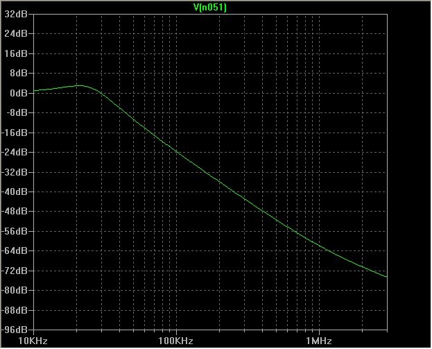

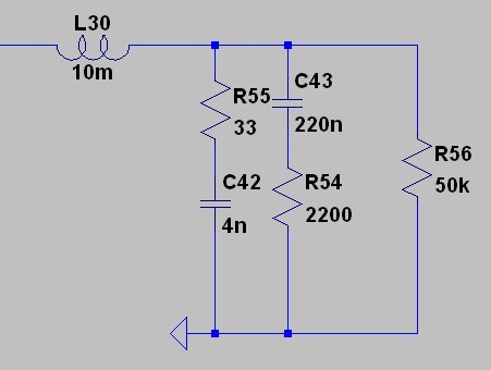

Here's a filter I'm going to try after the opamp - its designed to do two things. First correct for the NOS droop and second attenuate OOB images produced by the DAC. The filter that's currently on the opamp output (220R, 220pF) has a -3dB over 3MHz so isn't doing much (if anything at all) to tame the DAC's images. My filter's 2 pole and it provides 24dB attenuation at 100kHz. The inductor's a Coilcraft MSS1210. The 50k resistor isn't part of the filter itself, its my volume pot :)

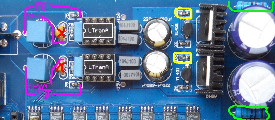

I've been listening now for an hour or so and this filter's definitely for keeps. The rise in HF response makes it sound just a tad more transparent and I'm getting more of an 'in focus' sound, closer to my reference DAC. Here's a hasty sketch of how to connect the filter (pink lines although only one RC network is shown in the sketch). I took out the square blue coupling caps as I already have input caps on my active speakers. If you need to preserve AC coupling move these caps to the output of the LC filter board - the Coilcraft inductors sit (face down) on my board where these caps used to be.
The resistors ringed in yellow are those to reduce to get a reduced supply voltage to the opamps. The green marks indicate the resistors feeding the shunts which are to be increased - add a 1W 100R in series with those already there by standing the existing Rs up vertically and placing the new Rs alongside.

Lower C42 sounds good to flatten the peak. Any counter-effect?
Why do you want to flatten the peak? Are you running at 192kHz?
The peak is there intentionally because when running at 44k1 the DAC chips don't give a flat frequency response, they 'droop' about 3dB by 20kHz. There's an old post on my blog about this. So this filter is specifically designed to undo that drooping effect and give a flat response overall. If you really want a flat filter then I'll design one for you - just increasing C42 will certainly flatten it but might lower the corner frequency too, so you lose the highest freqs.
I omitted to mention that this filter's only suitable for use with RBCD source material - i.e. stuff sampled at 44k1. If there's interest I'll design one for 88k2 too.

I've just put a dent in one remaining weakness of this DAC - the bass. Its a very simple mod to add capacitance to the TDA1387's supply. I soldered some 1.5mm copper wire to the two pads for the lytic (just beneath the chips in Matthieu's pic) and used that wire as 'bus-bar' to solder across 4 * 15,000uF 6.3V Panasonic NHG caps in a horizontal position. This tightens up the bass nicely. While I was fiddling I couldn't resist tweaking up the supply voltage slightly, to almost 6V (the max for the DAC chips).
Tried it stock today (LT1028 in my case). Better than I've expected as-is, not as harsh and strident as was a Ha-Info based one (and more exepensive AFAIR), yes a bit nasal and not that smooth on highs, but very listenable already. Can't wait to hear it finished even if I'll go for a bit less capacitance in the end. In stock form on our set-up its main quality was it's joyfull presentation.
I'm lazy (and ill!) so I'll need to be spoon fed ;) What value of resistor you changed at the TL431 Richard? Maybe safty (caps...) calls for 5.5/5.8V? Thanks!
The TL431 I was lazy and put another resistor in parallel with the existing 10k - it was 13k because I happened to have a reel of them nearby. Then I added another 13k a bit later in parallel with those two. You could just slap down a single 6k8 on top of the 10k already there. Oh perhaps you're meaning the DAC's TL431 haha - let me see I also paralleled another resistor there (3k is fitted in mine) and I needed a value of about 2k2 (for 5.9V) so I put on top of the 3k a 9k1 (erring on the side of safety). Note the resistor here is the (logically) lower one - the one connected to 0V, that's on the top of the PCB I think. The upper side resistor is below.
About caps and their working voltage - a few years back I got bitten with some Taobao caps not being the advertised voltage in reality and some blew up. So now I test all caps for leakage at above their rated voltage before I use them. These Panasonics I've put on the supply went well above 6.3V very consistently (actually to 9V before leakage climbed significantly).
If you were only to do one mod, the most significant one I'd say for listening pleasure is deleting those feedback caps (2n2s) around the opamps. That kills a lot of the harshness and improves the depth. After that upgrade the opamp supply caps with ceramics and bias the output with a resistor to -VEE (I'm using 2k2 with rails about 8V). Then change the pin7 caps on the DACs which kills most of the nasal quality and improves the LF clarity.

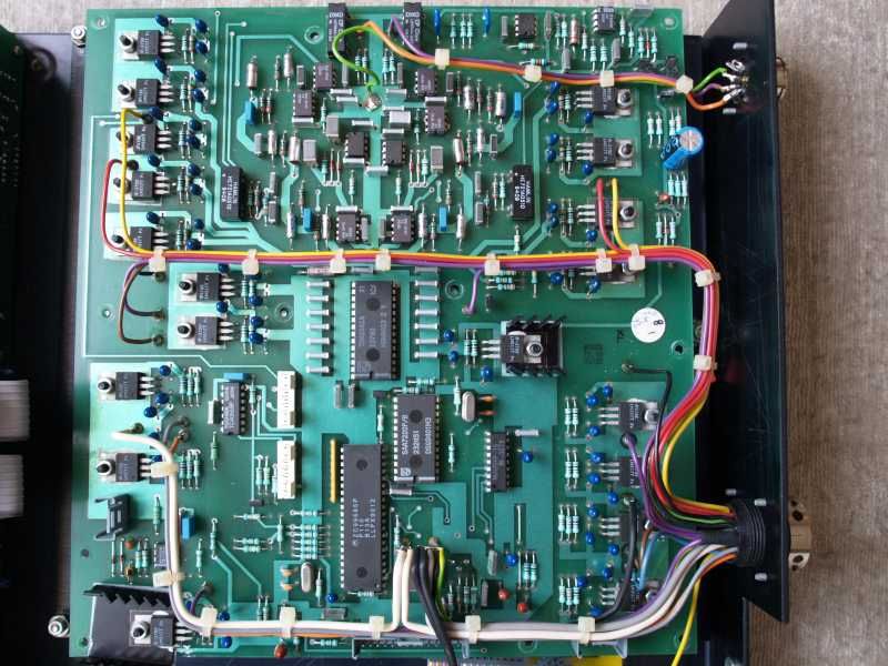

Oversampling redux
Of all the classic Red Book designs I've tried, Naim's TDA1541A/SAA7220 is the one I liked best. There's a reason why they located the 7210/7220/1541 I2S tracelines super close. ..
