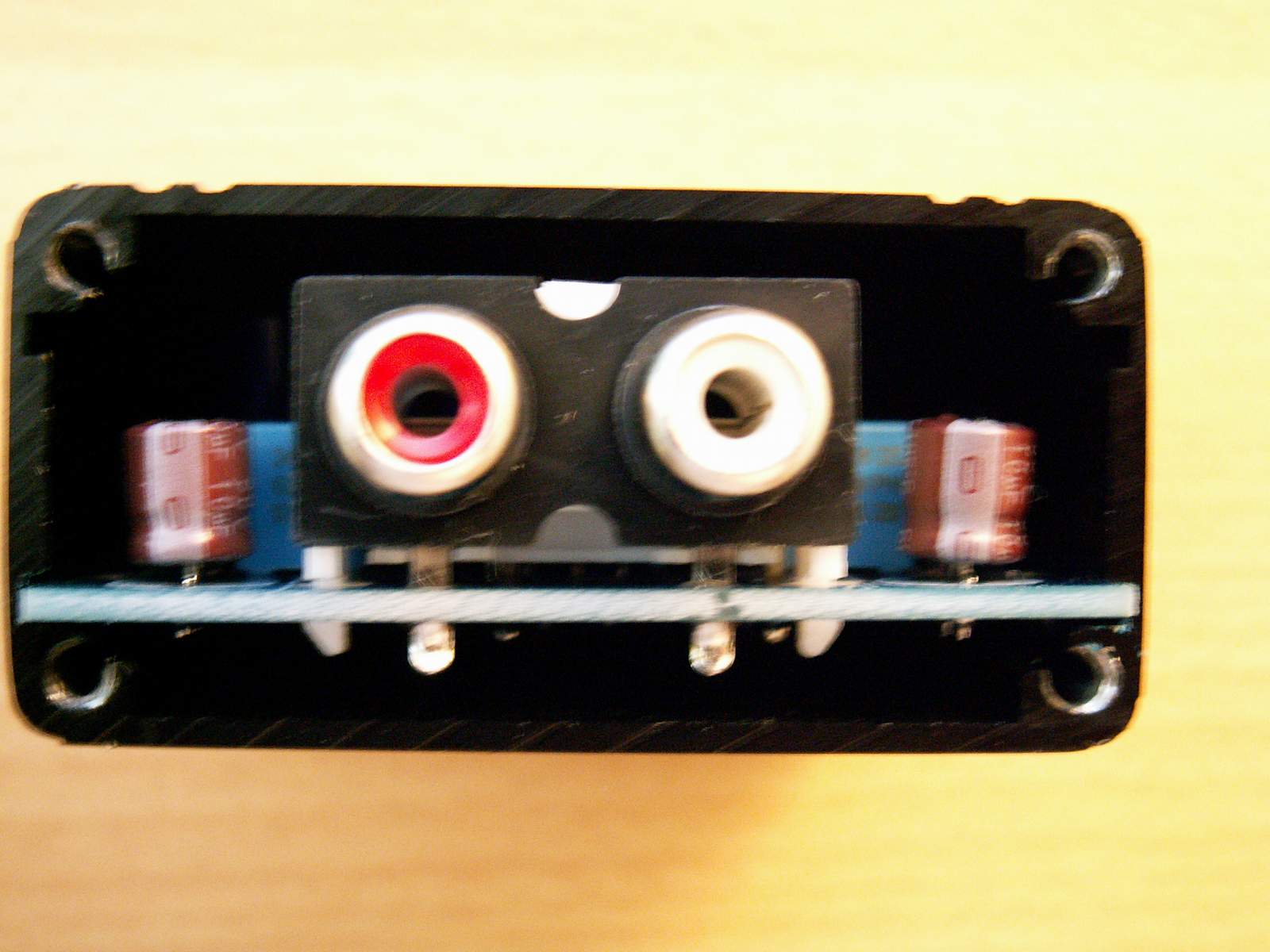

Case size is limited, so that will be a challenge.

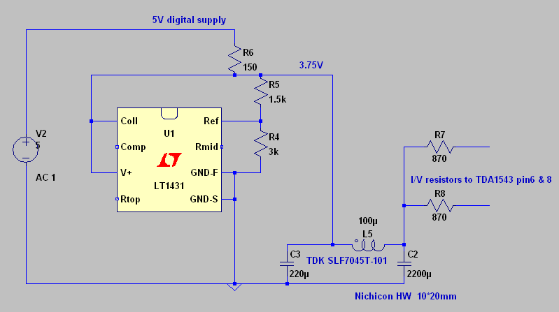

I've reflected on that schematic on my blog some more and figured it can be improved by simplifying to a 2nd order LC filter. I've chosen a commercially available TDK inductor and Nichicon capacitor to make it easier. Here's the schematic (only for the TDA1543) - its using LT's LT1431 as they don't have the TL431 :

I've reflected on that schematic on my blog some more and figured it can be improved by simplifying to a 2nd order LC filter. I've chosen a commercially available TDK inductor and Nichicon capacitor to make it easier. Here's the schematic (only for the TDA1543) - its using LT's LT1431 as they don't have the TL431​
Thanks for the schematic, very clear now.
If I would like to get 2V or more at the output when using your schematic, what would my I/V resistor value then be ?​
When you say '2V or more' do you mean 2VRMS? Or just 2V peak, or 2V peak-peak?
For a 5V-supplied TDA1543 the max output voltage is limited by the allowable output compliance, which is from 1.8V to 3.8V. That's just 2V peak-to-peak. If you want more you'll need to run the DAC from a higher voltage. The suggested I/V resistor value in my schematic of 870ohms gives the 2V maximum swing.

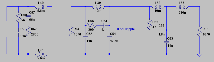

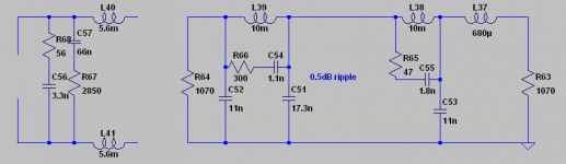

My second of these DAC boards is currently undergoing a more radical mod - using some Coilcraft inductors I'm implementing a more substantial filter than the one I put into my first set of mods. Pic attached.
The anti-imaging filter is made up of two elements - a fifth order quasi-elliptic LC filter (made from 10mH coils) and then a 2nd order under-damped low-pass (using 5.6mHs) where the ringing compensates for the NOS droop. In between these two filters are a balanced pair of discrete classA buffers. Transformers at the output do bal-SE conversion and no voltage gain stages are needed as the I/V resistance is just large enough to create a swing between 1 and 2VRMS, balanced. I'm running the full 8 of the TDA1387s from 6V. No listening reports so far as its not running yet.

Here are the filters you can see in the photo using the Coilcraft MSS1210 inductors (available from Mouser). Since they're balanced, stereo there are four complete circuits of the filter on the right. The left one is for NOS droop correction of which two are required. In between go the buffers which I'll draw up later. Inputs are on the right btw.

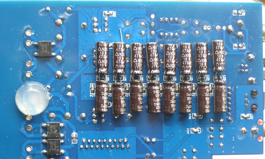

Here's what I've done to the pin7 caps - now two 470uF/10V in parallel, original ceramics removed, chosen for a slim profile so hopefully if I ever get a case for this board they'll fit snugly between PCB and case.
