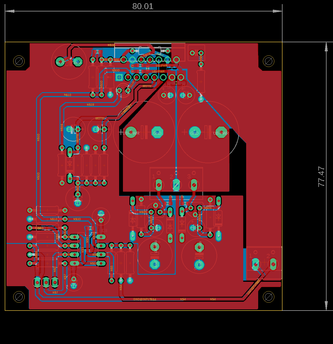

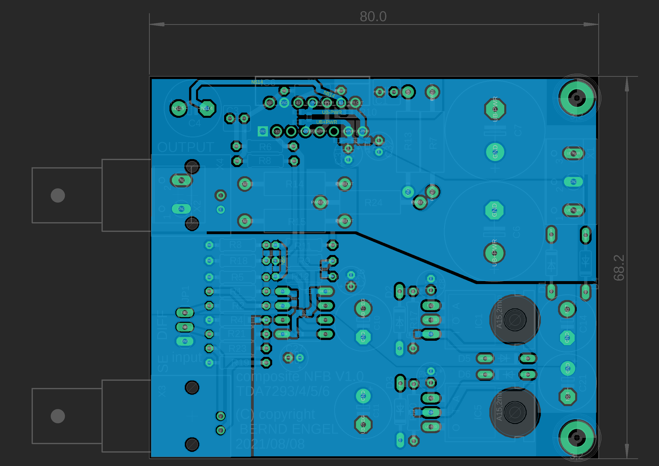

a new board
I did some work...
this should do better than the last one.
again: comments welcome

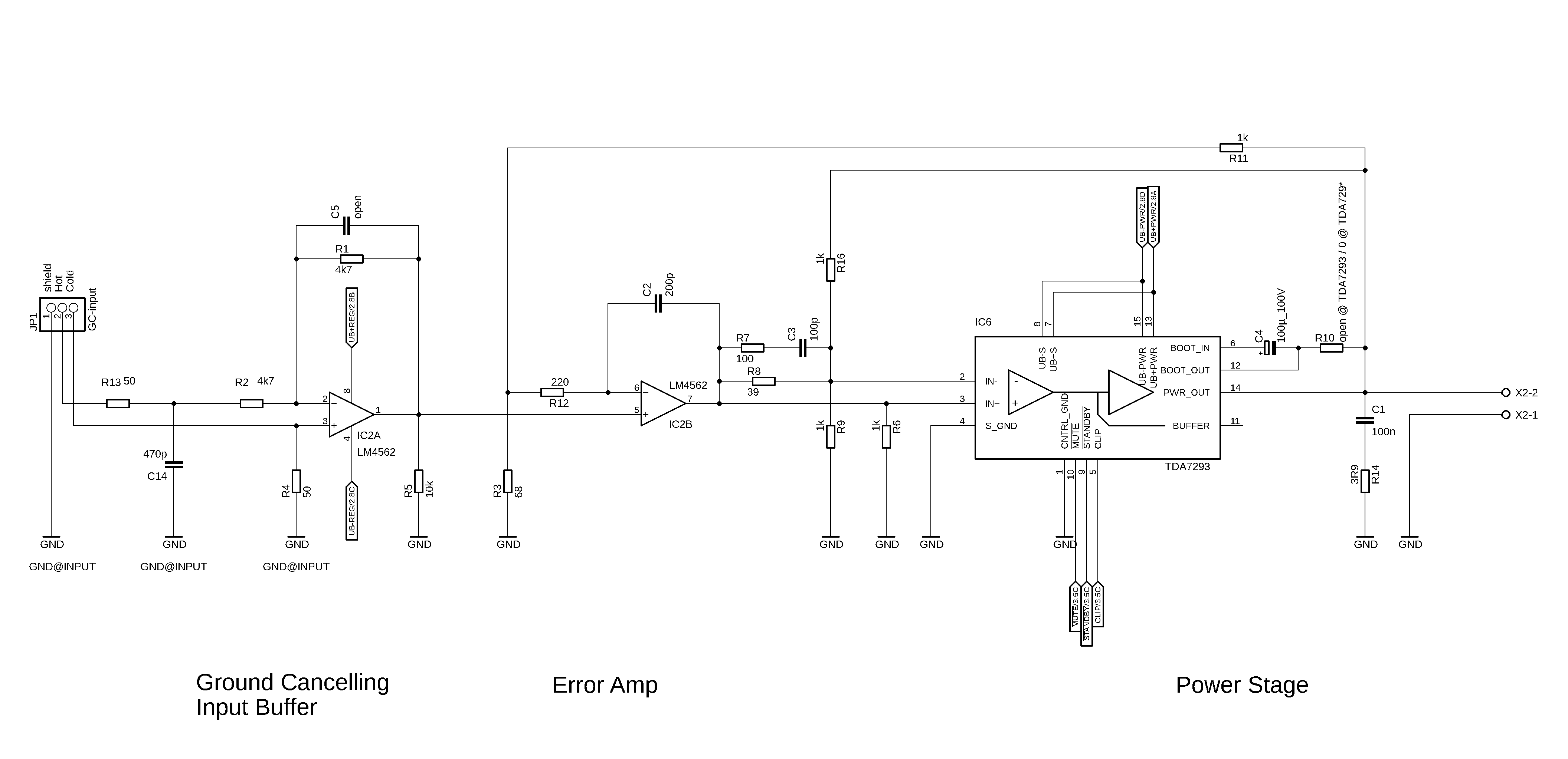

values updated
the configuration shown in the last post works! Attached the schematic with the actual values.
But still the startup is problematic. The time for the TDA to come out of standby/mute is too long, therefore there is a DC-Level of 20V at the output for a few seconds...without the Cs at the standby and mute input the time is much shorter (several ms), but is still too long. I took the standby/mutes supply from the regulated voltage and think this should be changed to the TDAs supply. Hopefully this unmutes the TDA before the regulated power comes up and the error amp can work into a closed loop. I will see if this works...
This problem should show up with all composite amps where the error amp is connected as an integrator, and probably someone has already solved this problem....hints and ideas welcome:worship:
TDA7293 Stby & Mute
Try using the R-C circuit for Stby and R-(R//D)-C for Mute as prescribed in the datasheet and powered from the amp supply instead of regulated supply. The start-up should now be silent. If your circuit exhibits noise during shut-down, then let us know, we will take that up separately. I hope that this helps.
TDA7293 Stby/Mute
It is possible that the feedback loops need an un-muted TDA7293 to settle down. The output DC could be the result of the loops setting down. So we may need to think of using a relay at the output to keep the speakers disconnected till the loops settle down. The NC terminal can be connected to a dummy load to absorb the turn-on transients while the speaker be connected to NO terminal. Need to think if we need anti-parallel diodes at the amplifier output to ensure that the amplifier output never exceeds the supply rails due to load impedance. I hope this helps
Connecting the standby and the mute pins directly to the positive power-rail is a solution that works (for me). As the TDA no longer mutes when connected that way, the feedback loop is closed right up from the start. The measured artefact on the output is now much smaller and short in time and well above the audible audio band. A connected speaker is quiet at startup and shut down with the input shorted.
That works for me, espacially as it saves boardspace - all parts for the standby and mute circuit are no longer needed

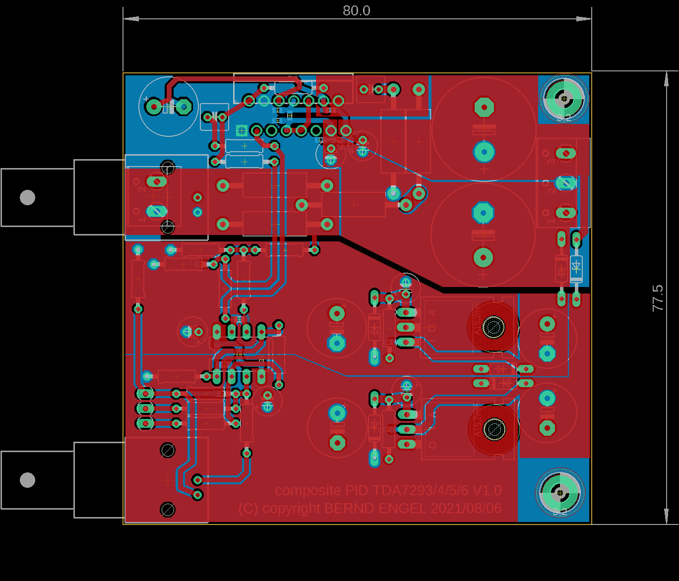

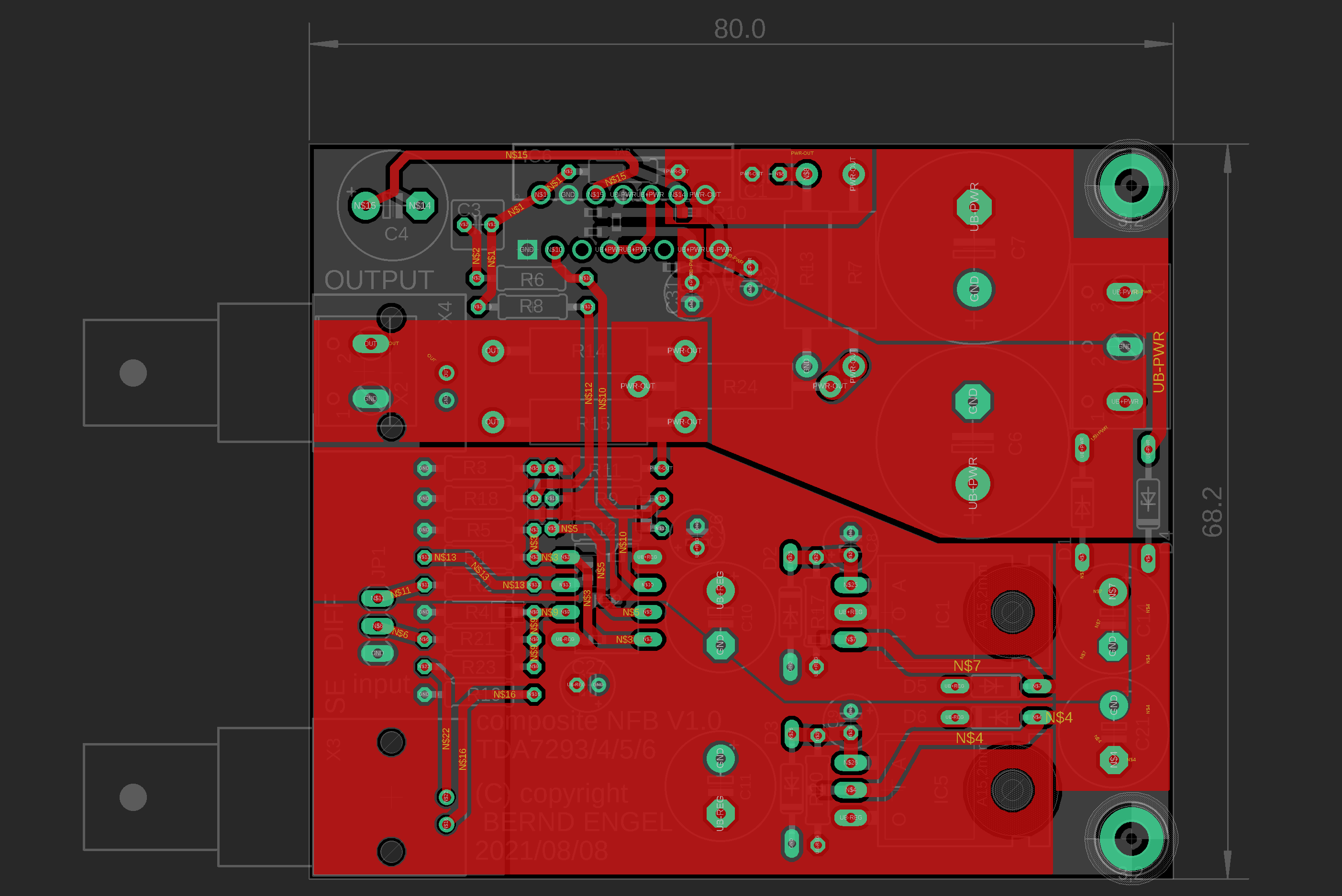

sometime it helps to look at a circuit in another way.
As the step responses signal shape from the amplifier, especially when Cs are connected at the output, reminds me on the typically step response of an PI-Regulator, one can see the composite amplifier as such. Having in mind, that the step response of an PID-Regulator is even better (the step sill is a step), this should be tried. Could this work? The simulations i ran so far say: yes, this will work. So it is time to do another prototype - this time hopefully the final one...
The Cinch connector for the input i want to use has the same pinout, at least i hope so.
And the BNC for the output is for some speaker-cable test. BNC is specified for 3A continuous (at least by some of the manufacturers) and will therefore fit to my standard listening levels. But if this don't work or doesent sound good for my ears there is also the possibility to change the output to a standard connector (terminal with screws).
Yes I am interested in your comment, but as i wrote "this is intended to be..." i just want to do some minor work on the board - moving the parts a bit to get the board a little smaller - and to separate the input ground from the regulator ground will be a good idea, iguess...
