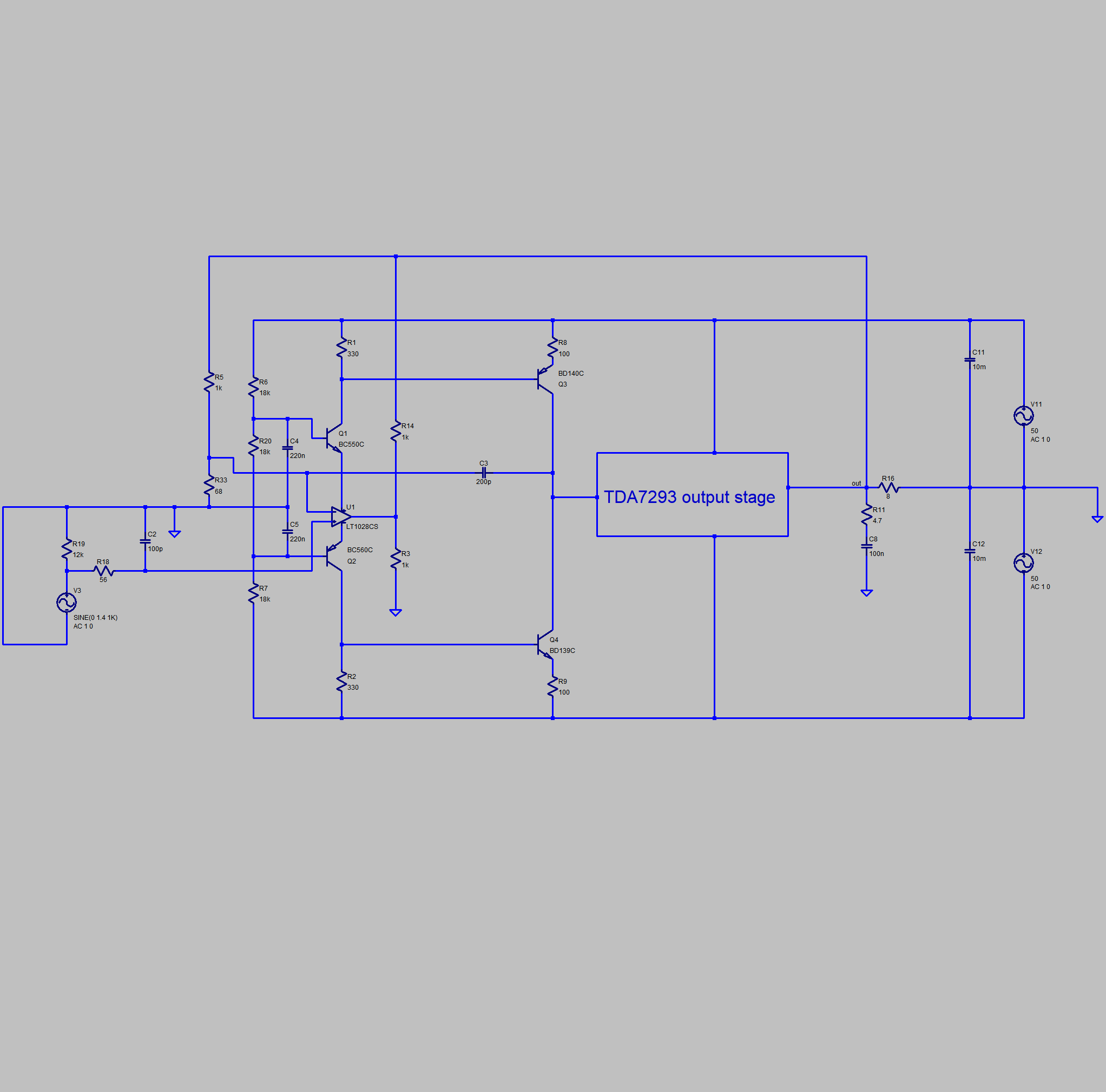

Thank you Bernd , this is great news for me. While I am able to design circuits unfortunately I AM NOT able to optimize them , partly because of insufficient knowledge and partly because being retired I have limited instrumentation when it comes to fine tuning.
My idea is to take a good opamp , at plus minus 15 volts , take its output to the negative rail level by means of say a BC546 which can handle 60 volts , then a complementary VAs based on said BF471/BF472 to drive pin 11 of one or more TDA7293.
I think one can try this with the very VAS stage from that crescendo , of which I have the circuit diagram and exhaustive explanation in the original ELEKTOR magazine. Greetings
here is my idea - just an idea. But this will surely work when the TDAs output stage has the gain of ~1. If you look at the values....R14 should be at least 2k.
And for sure some more finetuning will be needed.

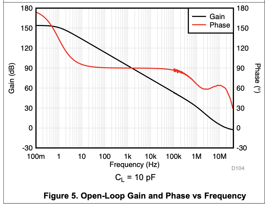

I hope it are recent LM4562 you have as mine had a large quantity having popcorn noise.
Yeah. Those were annoying.
OPA1642, OPA1656.... better choices.
The OPA1642 is quite a bit higher noise than the LME49720, though. Higher distortion too. The OPA1656 is solid, though. It should be noted that while the typical specs for the OPA1656 are on par with those of the LME49720, there are hardly any test limits on the OPA1656. Basically only offset, offset drift, CMRR, AVOL, and supply current are guaranteed specs for the OPA1656 whereas the LME49720 adds THD+N, output noise, slew rate, and gain-bandwidth product to the list of guaranteed specs.
Guaranteed specs are those with either a minimum or maximum (or both) defined in the spec table of the data sheet. These values are tested in production. Typical specs are derived from device characterization.
The OPA1656 also has this really annoying phase wobble in the 1-10 MHz range that can make compensation a challenge in a composite amp.
Tom
Analyzing the TDA7293 and studying its data sheet there are several things that jump to the eye.
Actually it is a double chip with separate input and output stages since the output of the input and vice versa are freely accesible on pin 11.
1.) the first possibility and the more obvious one is that by putting the chip into slave-mode one has a complete and independent mosfet output stage which has its own biasing circuitry , protection circuitry etc all built into the chip and so can be used with any circuit feeding it a signal provided the output is included in the feedback-loop of said circuit.
2.)The signal available at pin 11 can not only drive another TDA but any other external output-stage as long as the current needed to drive that stage does not overload the circuit inside the TDA which feeds pin 11. This opens up possible external output-stages driving loads as low as one or two ohms using discreete mosfets.
in short , using ones imagination there is a lot of things one can try and develop based on this chip-amp whose V.A.S ouput and powerstage-input are accessible.

Hi bepo .
I like the circuit idea from post 65 though I think that a LM49720 for the input opamp is plenty good enough. You get that for 2,50 euros instead of the almost 11 euros of the LT1028.
The pair BD139/BD140 though are too limited voltage-wise as they only go to 80 volts , not enough for 50volt-rails what do you think about MJE340/MJE350 for example?
post 65 shows only the topology i have in mind - i actually have something similar (discrete CFP-MOSFET-output stage) to hear my music with. But as i want to build an active dipol- speaker, similar to Linkwitz LX521 with one amplifier for each chassis, i no longer want to adjust anything and so i found my way to the composite amp.

Hi Bernd ,
Thats precisely my point Bi-Amping , Triamping and even 4 channel-amping needs 50volt rails for a 12"bass so if the circuit is designed for that to begin with one can always use it with lesser rails wheras the opposite is a no-go.
A composite amp with the layout for three TDA, can be used with only two or even only one ! And the boards from china , say JLCPCB , do not cost so very much. The work is practically the same , the pcb a little more expensive but good for all purposes downscaling then is easy.
