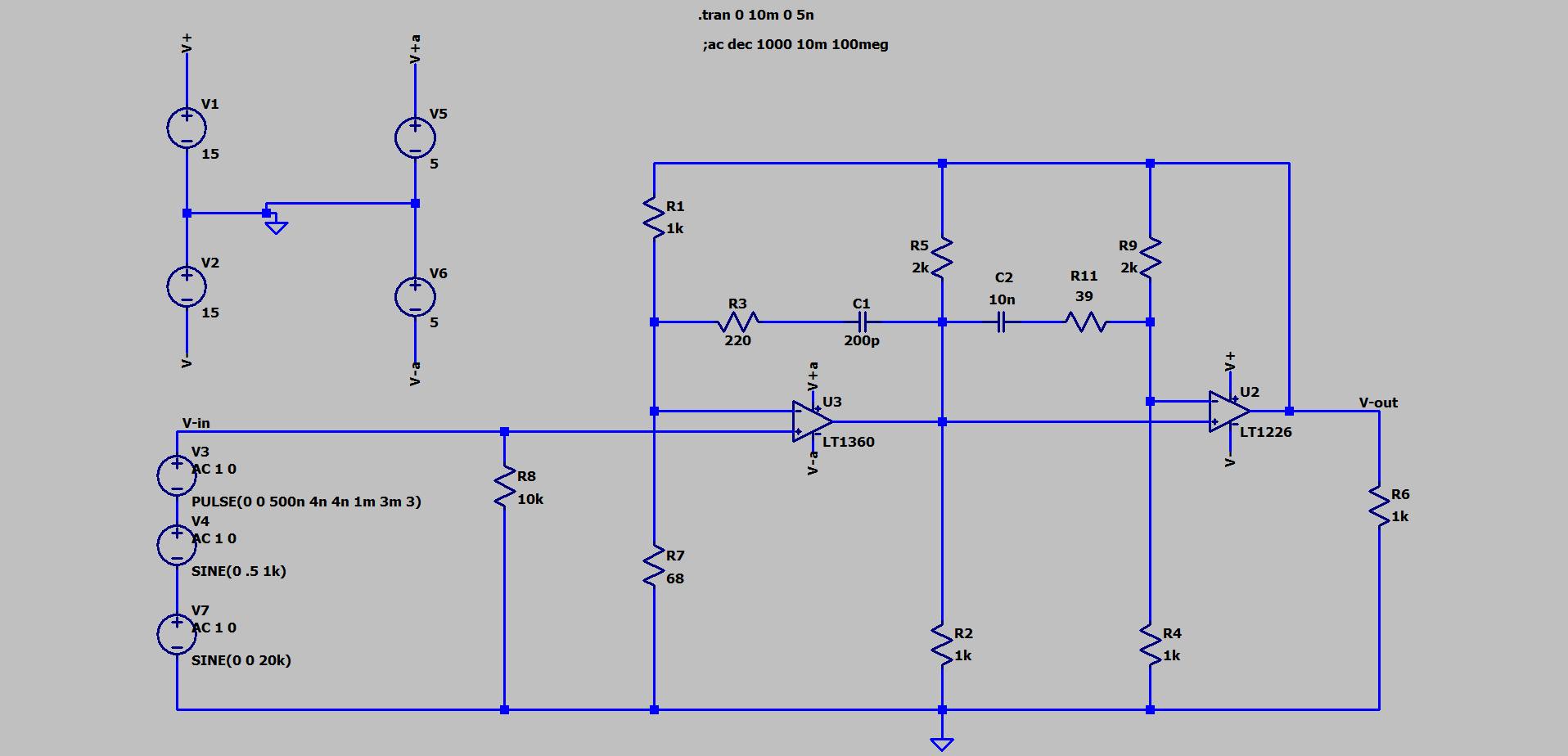

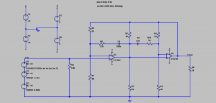

my variation of the my_ref-circuit
here is my variation of the my-ref-circuit you have linked, MalleMike.
it shows more a promising result to me than the original circuit in the link - at least in simulation... so this were the curcuit to test for me!

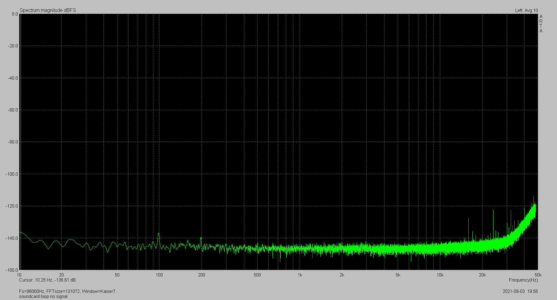

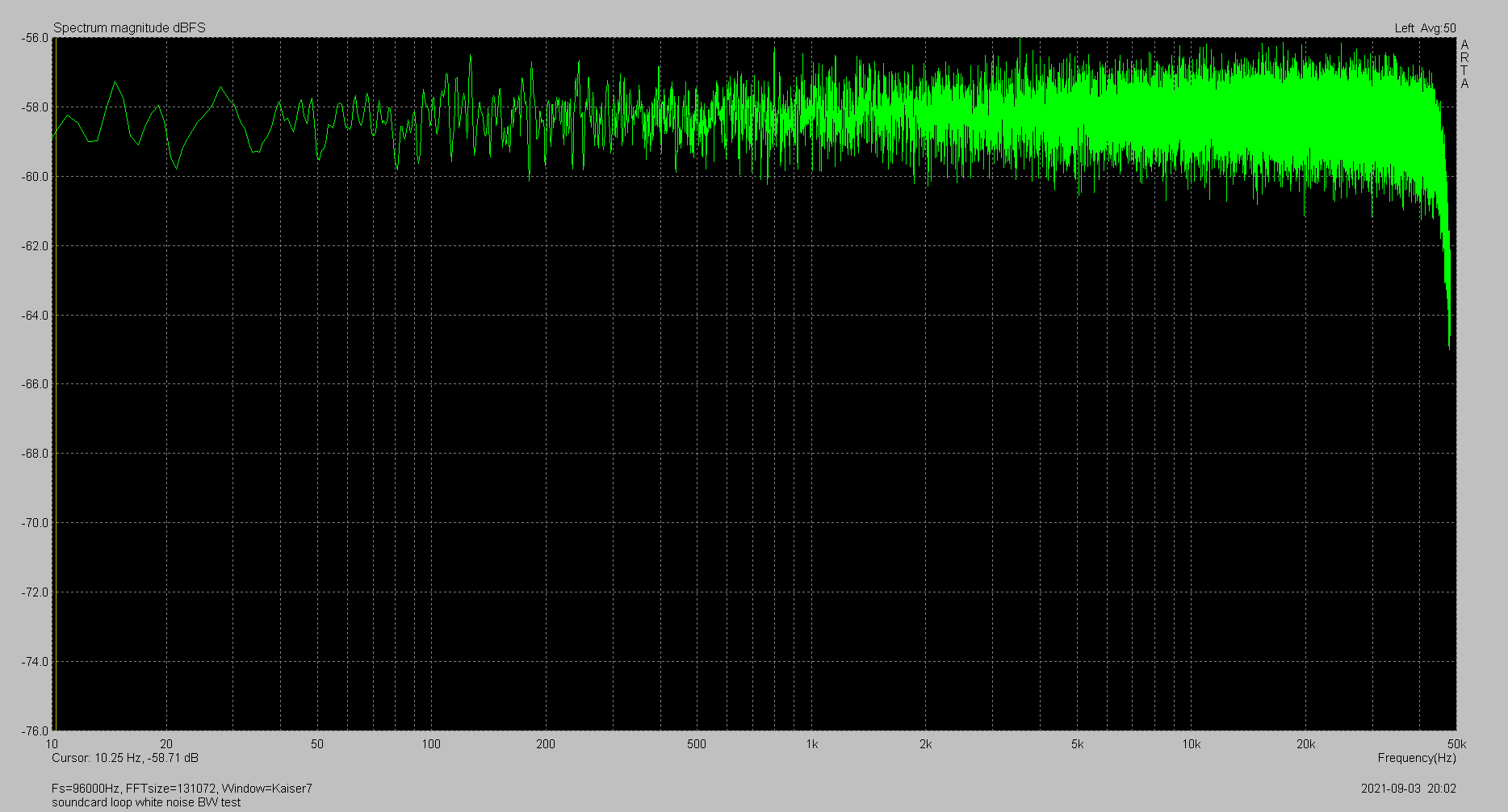

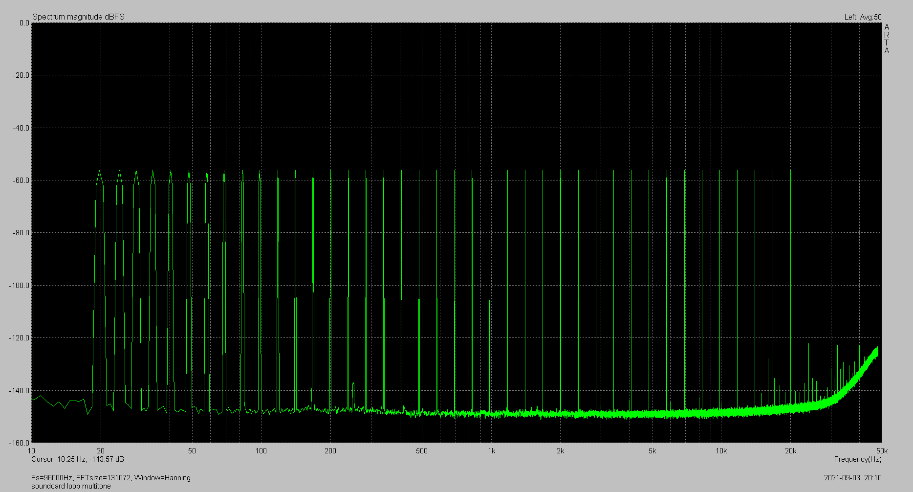

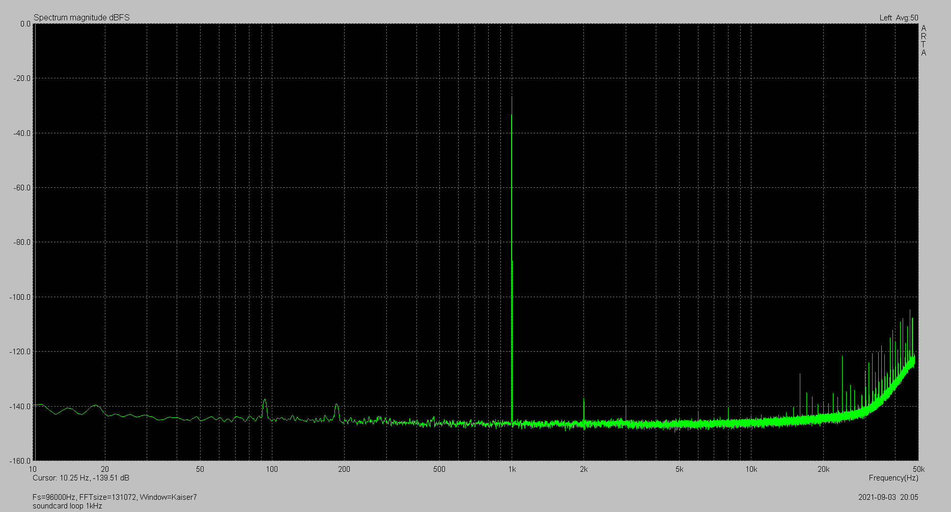

here are some measurements for my composite NFB design, the first thing that I show is the test of the soundcard quality:
terratec phase X24FW, used sample rate 96kHz, resolution 24bit
Attachment 1:
soundcard loop with white noise to see the soundcrds bandwidth - it is 48kHz (souncard has the same bandwidth when using 192kHz sample rate, so this is the hardware limit)
Attachment 2:
soundcard loop with no signal to see the cards noise

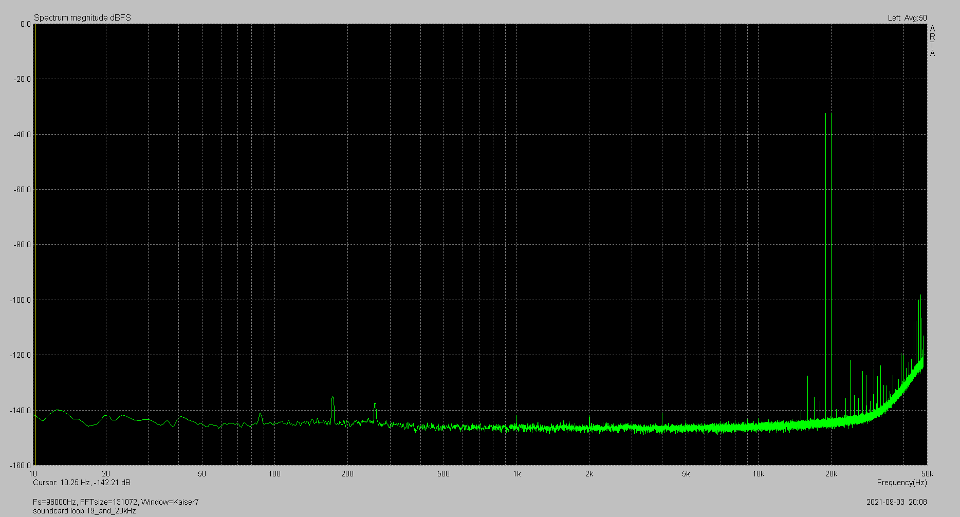

Attachment 3:
soundcard loop with 1kHz testtone to see the soundcards response to this signal
Attachment 4:
soundcard loop with a dual sine testtone 19kHz and 20kHz (1:1) to see if the soundcard shows intermodulation artefakte
Attachment 5:
soundcard loop with multitone testsignal to see the soundcards answer to this signal
as the soundcard has symmetrical quarter inch connectors the loop was done symmetrical
conclusion so far: this soundcard can be used for testing the amplifier

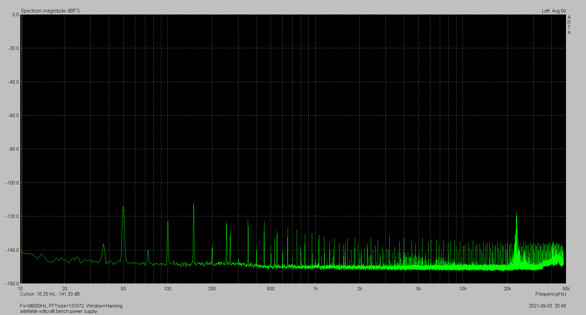

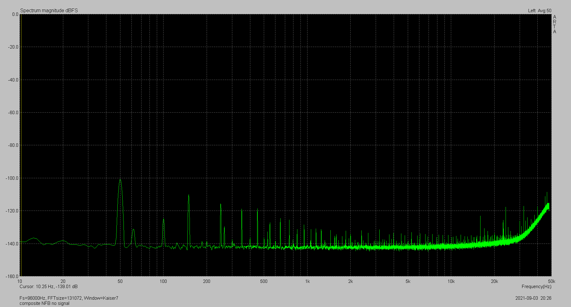

power supply artefakte
the power supply used to test the amplifier was a fourty year old regulated bench power supply (2x30V, 2x2,5A), connected to the supply 2x20mF and the amplifier, the shown signals are taken from the amps output.
Attachment 1:
power supply artefakte with the amps input shorted
Attachment 2:
power supply and measurement loop artefakte, loop connection is single ended, no signal is applied
conclusion so far:
a switched mode power supply will put the supplys artefakte out of the audible band and a symmetrical signal connection will avoid groundloops

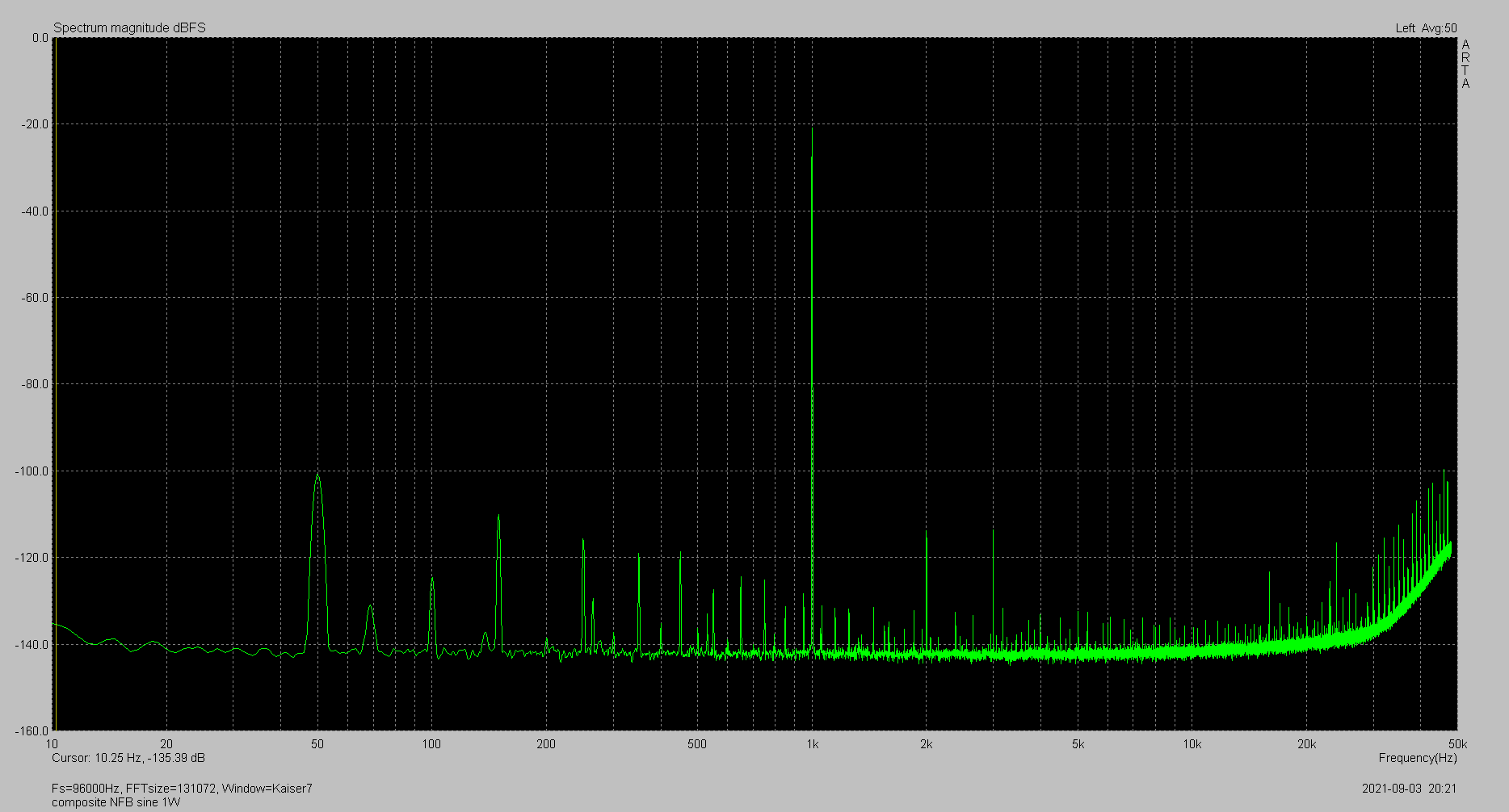

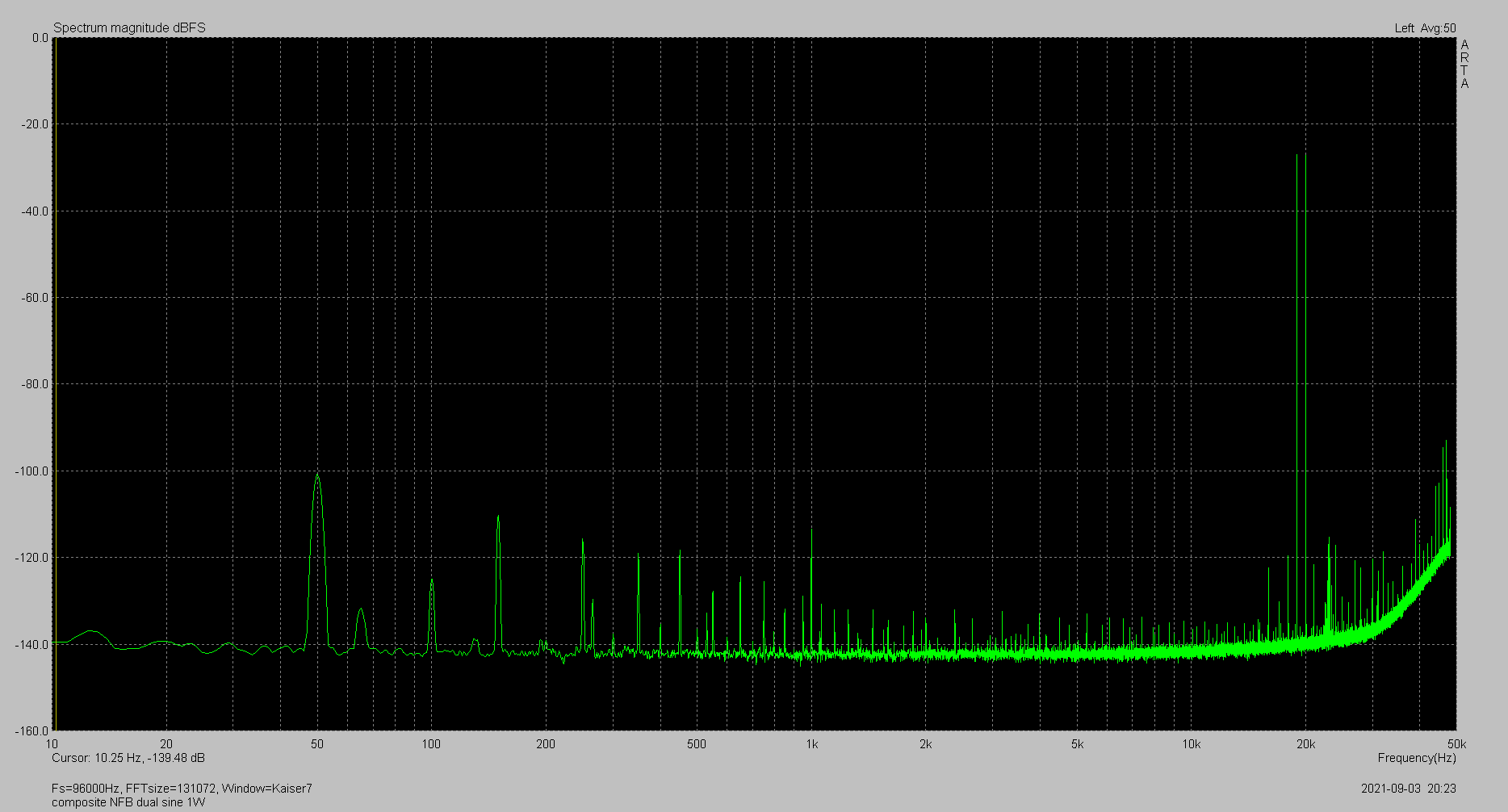

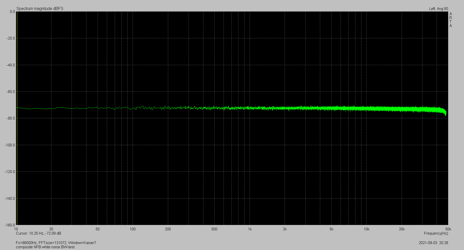

amplifier test with 8 Ohm resistive load, 1W
here are some measurements of the amplifier, just mounted on a heatsink, no further surrounding
Attachment 1:
1kHz testtone, one can see the typical k2 and k3 fingerprint of the TDA
Attachment 2:
19kHz and 20kHz dual sine testtone, one can see some intermodulation artefakte well below the signal
Attachment 3:
multitone test signal, a signal that comes close to real music in my eyes, the only thing disturbing is the power supplys artefakte
Attachment 4:
white noise bandwidth test, one can see that the bandwidth is the same as for the soundcard loop test, so the soundcard is the limiting element, as the 1W bandwidth measured with tone-generator and oscilloscope is 350kHz
conclusion so far:
mesurements look good to me, but i did not expect to see the TDAs "fingerprint"
This does look very good and especially for a first test run . 🙂
The power-supply is a smps type with two very large filter-caps which are not good at veryhigh frequencies due to their ESR. I am sure the artifacts can be filtered out with two strategically placed small capacitors and two equally small chokes inserted in the supply-traces going to the TDA , just before the small decoupling caps of the TDA itself. In other words design the power-traces to the chip as if it were a class-D amp.
With these caps/chokes being on the amps pcbs the inductance of the wires from the PSU would help filtering a bit as well and the boards would be decoupled from each other too .
Just a suggestion I would make and of little cost. Should make the chips behave better at higher frequencies , too ???
And besides this particular setup , considering future trends concerning the increasing use of SMPS it will surely become necessary anyways.
Please let me know what you think. Cheers
Reactions: danielwritesbac2
The power supply used is a linear one using a transformer, the hint to a smps was triggered by the idea to bring the artefakte of the rectifiers out of the audioband.
(strong) filtering the power supply of a power amp looks not like a good idea to me, as the current drawn by the amp is not continuous and therefore the edge-frequency of the filter changes with the current drawn...
what could work for me is a circuit that is called "capacitor multiplier" - a RC filter is connected to the base of a power transistor, the collector connected to the power supply and the circuit connected to the transistors emmitter. So the circuit "sees" the C of the filter multiplied by the transistors hfe for the cost of a few volt of the power supply.

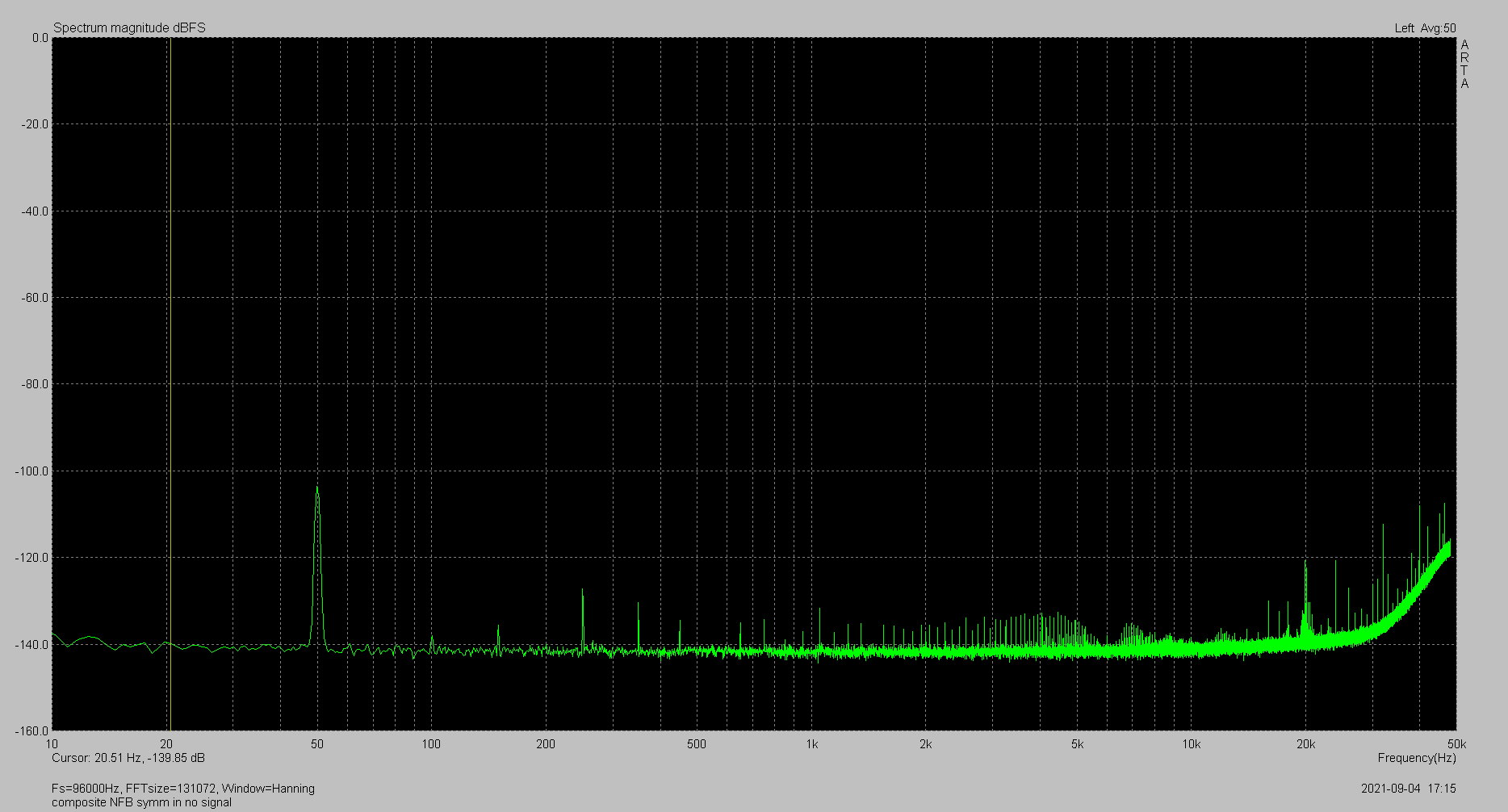

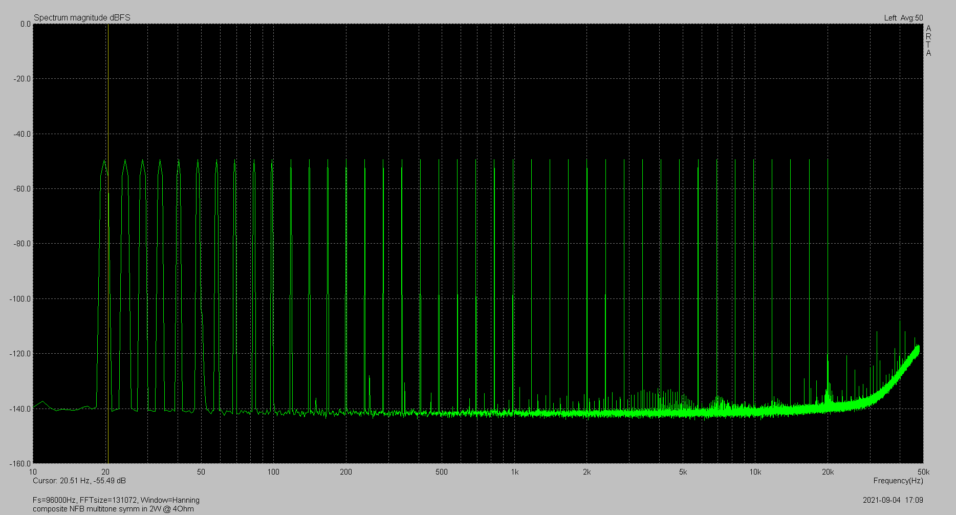

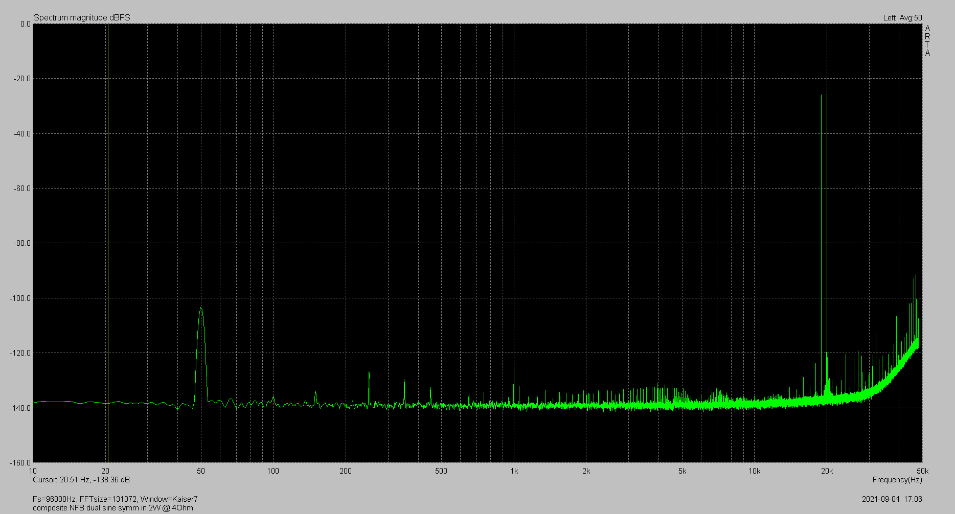

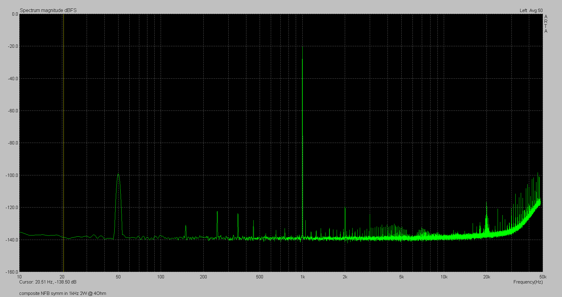

symmetrical input, 2W @ 4Ohm load
for the measuments shown i changed the input of the circuit to a symmetrical connection by using a standard cable for telephone installation (type: shielded 2x2x0,6mm in starquad configuration) and changed the load to 4Ohm. The rest of the connections are left unchanged.
Attachment 1:
symmetrical input, no signal applied. clear to see that the power supply artefakte are lower than before, but not the "distortion" at 50Hz - i have actually no idea where this comes from, as no 50Hz "source" is nearby and the first rectifier artefakte is to be expected at 100Hz...
Attachment 2:
symmetrical input, testtone 1kHz
Attachment 3:
symmetrical input, dual testtone 19kHz and 20kHz (1:1)
Attachment 4:
symmetrical input, multitone testsignal
conclusion so far:
symmetrical connection is the way to go, it is clear to see that the signal arriving the circuit is much cleaner. looks like the single ended cable works as an antenna, even when the input pins are shorted.
With 50 Hz mains, you're surrounded by 50 Hz sources that will couple inductively into your circuit if you let them. That's likely also why you see the other mains-related artifacts. I'd look for ground loops and minimize their loop areas.
You can also try a faraday cage. Ideally a sealed and grounded metal box. I've had pretty decent luck with a "circuit burrito" (i.e., wrapping the circuit in antistatic bubble wrap and then in tinfoil connected to ground with a clip lead). Just be careful you don't short stuff out or allow stuff to overheat in the burrito.
-100 dBc THD is not bad. That may be the limit of your instrumentation. It certainly indicates that the error correction isn't fundamentally broken.

A faradays cage is a real good idea, because i had an eye on building NO groundloops - the "circuit burrito" described looks as an easy way to get a real cheap faradays cage, thank you Tom.
I did some work to find out what is going on at 20kHz as i have seen this "distortion" too. I am almost sure i found the origin of it - on the oscilloscope i can see a real small periodic signal as soon as the connection to the computer starts to work, its frequency is an integer multiple (6x) of 20kHz...so it has to be some kind of aliasing (not sure if this is the right word, but i hope it is clear what i meant to say). This periodic signal shows up on both soundcards i have acces to (one firewire connected, the other one USB connected, both cards terratec)
I dont know the exact limit of my instrumentation, but looking at the soundcards selftest (shown a few posts ago) you could be right that it is close to it, Tom.
The TDAs "fingerprint" is so far down in level that i dont want to make any effort to get rid of it, Mike, thanks for your ideas anyway.
while waiting for the components to arrive i did a quick test of my variation of the my_ref-circuit. The step-response test tells me it is working stable and the bandwidth (refering to my NFB circuit) is almost doubled (1W@8 Ohm), but shows a 15% peak in amplitude in the 400kHz region....
