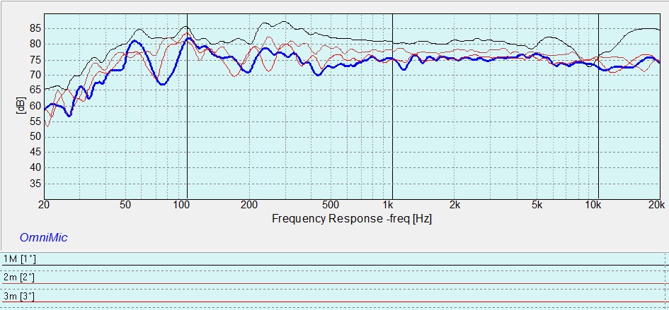

Here's a 70" tall array (6.5" 2-way) that has shading. Measurements taken at the center of the array from 1,2,3, and 4M.

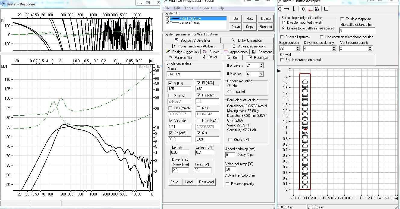

TMM, here is some contradicting evidence.
Here are some plots that compare a TC9 array versus a Jamo 6" woofer array. I have both these drivres (and in fact I have the TC9 array itself). This is BASTA, which is Edge's big brother. Top line in all figures is the TC9.
Clearly, the 6" array comb filtering starts approximately an octave lower. The second picture shows a closeup. Now, the driver density value in Basta/Edge has a big impact on the response smoothing. See the third picture, where driver source density has been reduced to one for both systems. What are we to believe?
In a real array, if we assume larger drivers, then the acoustic centers will be farther apart, and therefore, phase shifts that produce peaks and dips will start at a lower frequency. Pretty simple really. This has nothing to do with driver directionality, which I believe all models are ignoring -- our theoretical model and the simulators. But the conclusion is still the same: frequency at which comb filtering starts has nothing to do with the height of the array.
I don't know what is the difference between the Edge and Basta, both are developed by the same guy, but clearly, our sims are producing different results.

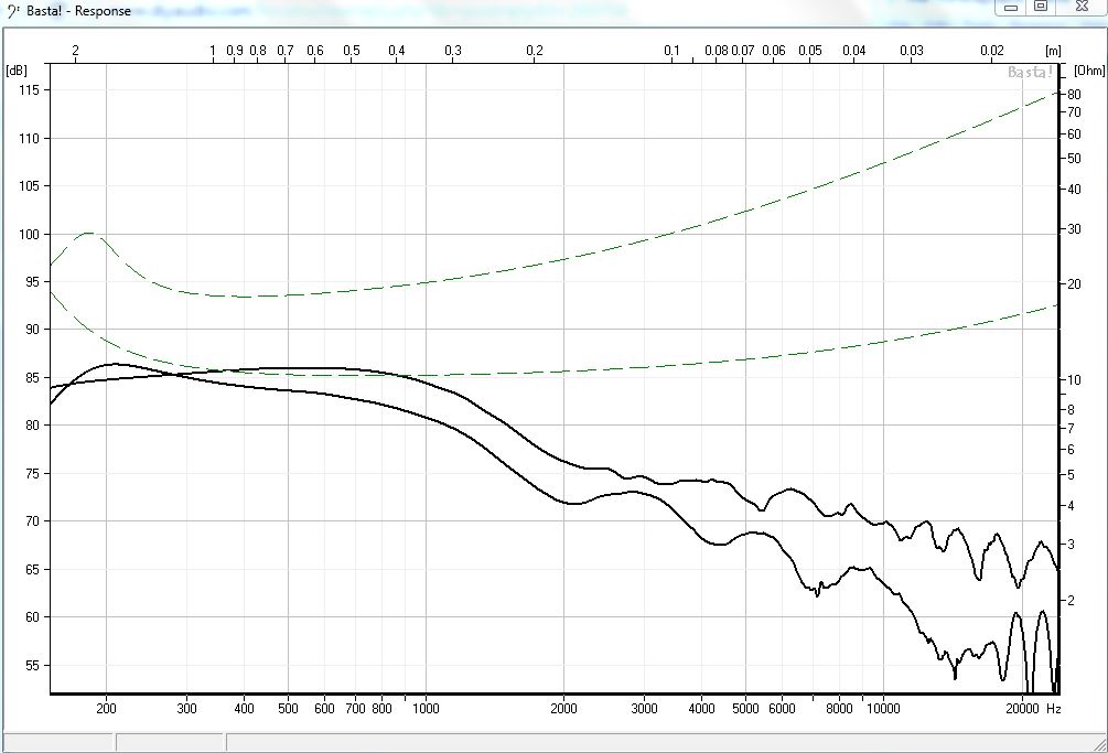

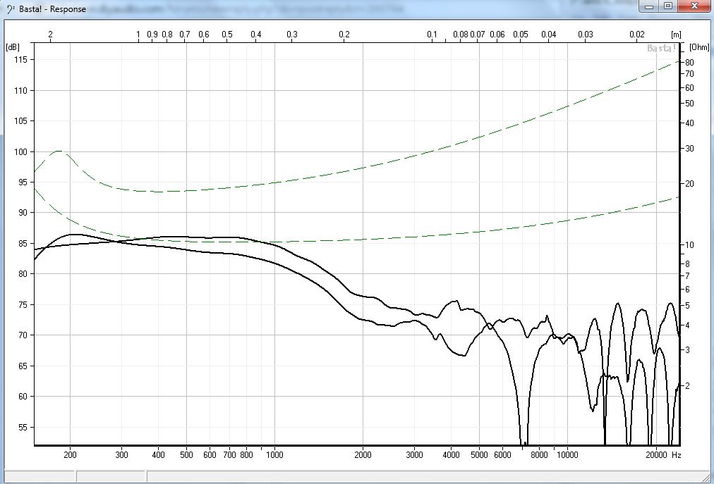

Your simulation looks closer to what I've measured in various arrays.
The graph where source density=1 is more believable in terms of modelling an array of circular drivers..

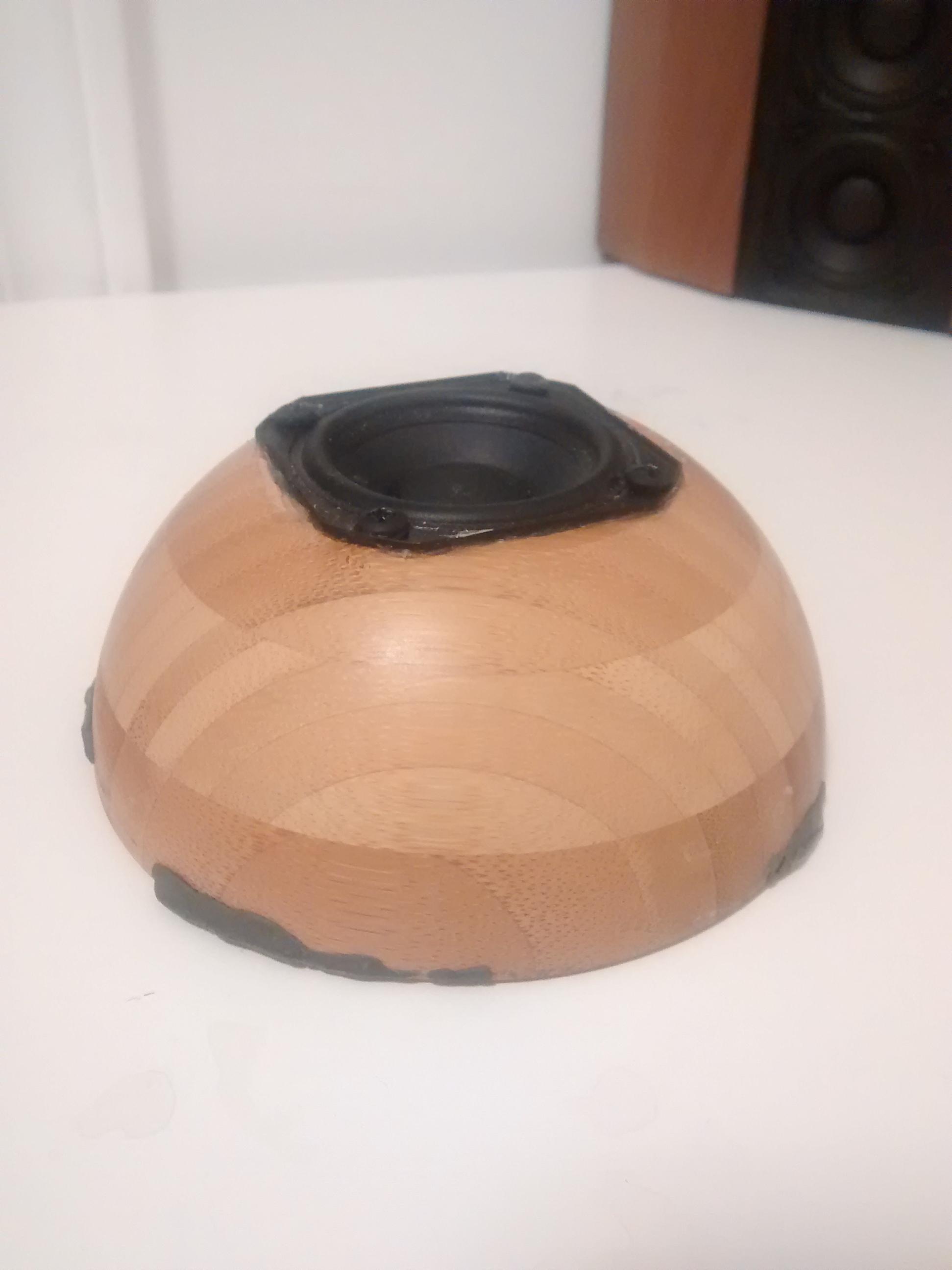

More measurements of the TC6 variants coming up. The test enclosure is a hemispherical IKEA bowl which will sit atop a pile of blankets, so the results should be pretty close to infinite baffle. A pair of these bowls makes a very nice sounding TC6 enclosure actually...
Also attached picture of the driver venting (for wesayso)

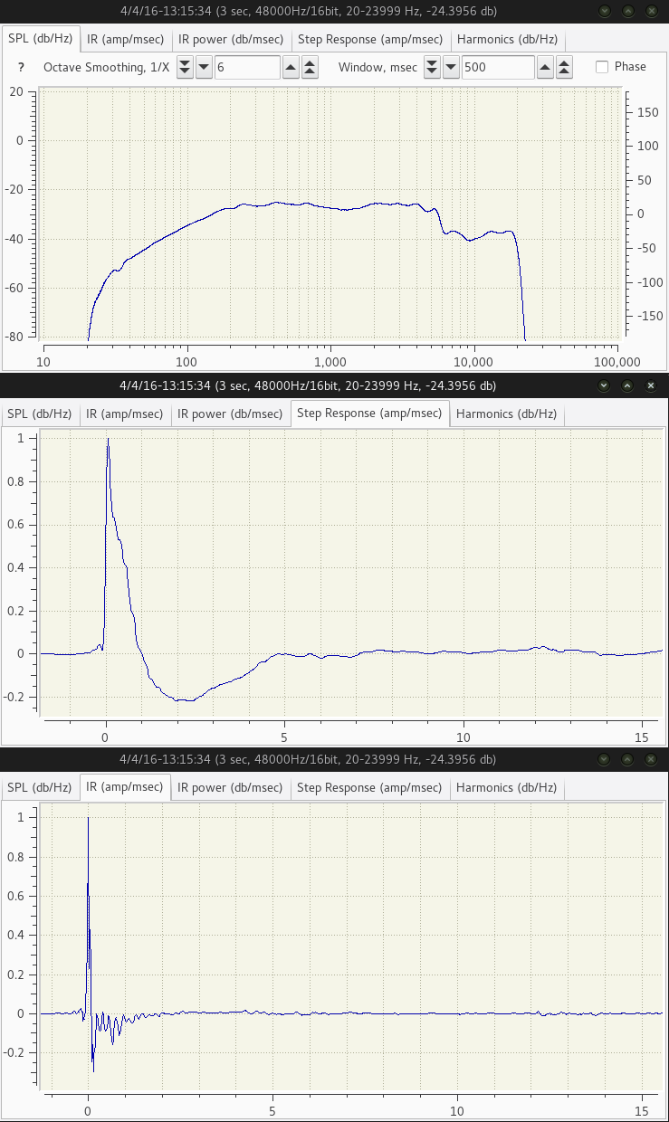

TC6WD mounted on IKEA bowl, open backed on top of a pile of cushions. (approximating infinite baffle)
Measurements match up with the published specs pretty well.
This is the WD mounted in the other enclosure, right? It's still a big drop at high frequencies (~5500 Hz). The impulse is relatively clean on first look, but not as clean as it's neo sister driver.
Any chance I can persuade you to start using REW? 🙂 An early waterfall plot might show some info on the ringing after the main pulse. Like I said, we get the driver that is used back on steroids.

Yes, its the same enclosure I used for the neo driver. Its a crazy steep drop, but that's what the specs show as well. Not sure if this driver is better/worse than others. I ran out of good drivers at some point during the build - ordered 20% extra for QC but 10% were damaged in shipping, so I basically only have the worst of the bunch free for testing individually. This one had a dented dustcap but otherwise seems fine.
If cost were no object, I absolutely would have used the FC00 or FD00 (or perhaps the 02 to get lower midrange distortion, at the expense of smooth FR..)
Sure, I'll install REW on my Windows setup. Seems to be necessary to get the next level of information from measurements.
