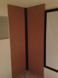

One thing I had in mind for my corner arrays right from the beginning was to put them all the way back into the corners as much as possible. But in my case, the walls and cabinets did not fit perfectly flush. So, I had to build these deflector panels to get rid of some reflections where there was a gap between the baffle and wall. Since installing these, there was great improvement in the cleanliness of the impulse response. I also had to worry about the projector screen, which was creating a massive reflection. The deflector panels are just 1/8th inch masonite panels you can buy at HD or Lowe's. I should probably finalize the exercise by damping the panels and making it a more permanent solution. Right now, they're held in place by thumb tacks 😀
Of course, horns are resonant devices. There are bound to be some reflections. But the proof is in the pudding, as they say, and the pudding tastes pretty sweet. The sound is marvelous.

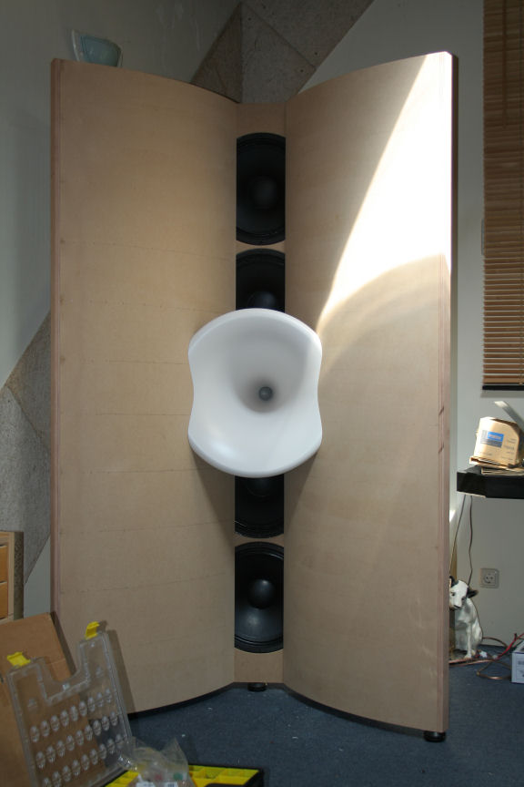

tell me more about these deflector panels! close-up at driver side and wall side?
Looking good ra7! I had often wondered what adding a "waveguide" like that would do for an array... Of coarse the corner was supposed to do the same but this shows it's important how the transition is done.
I had a picture saved for inspiration to do it like this:
attachment.php
(from BD Design)
But without the added horn 🙂.

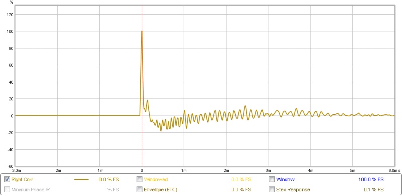

550404d1463717776-tc6wd-pe-buyout-line-array-lessons-learned-right_corrected_5-19-16.jpg
What is ringing in your impulse response, and where (at what frequency)? That looks, um, bad. Can you post the uncorrected frequency response?

Hi Charlie,
Actually no, it is not bad. It is very good. Fantastic, in fact. Impulse response can be misleading. For starters, that is a line array. Each driver contributes to the response and the amplitude at a given frequency is a function of the driver distance from the listening axis. If a driver is exactly one wavelength away, the response adds in perfect summation (and so on). So, while the impulse response appears like a train of ringing impulses, it does not generate a traditional peaky frequency response. If you observe carefully, the first pulse in the IR is actually nearly like a perfect dirac pulse. And that is measured at the listening position. More in my line array thread here:
http://www.diyaudio.com/forums/multi-way/284371-corner-floor-ceiling-line-array-using-vifa-tc9.html
Post there if you want to discuss further. All I can say is that I'm not building new speakers looking for better sound (I am building them because its fun). And I haven't touched the EQ since February, partly for a lack of time but partly because it sounds so bloody good. I am just enjoying the music.
