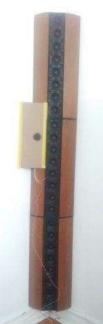

One thing I had in mind for my corner arrays right from the beginning was to put them all the way back into the corners as much as possible. But in my case, the walls and cabinets did not fit perfectly flush. So, I had to build these deflector panels to get rid of some reflections where there was a gap between the baffle and wall. Since installing these, there was great improvement in the cleanliness of the impulse response. I also had to worry about the projector screen, which was creating a massive reflection. The deflector panels are just 1/8th inch masonite panels you can buy at HD or Lowe's. I should probably finalize the exercise by damping the panels and making it a more permanent solution. Right now, they're held in place by thumb tacks

tell me more about these deflector panels! close-up at driver side and wall side?
^Me likes! Very nice impulse. HOMs are not so bad as LOMs and MOMs
I assume this is horn-speak... translation as it relates to the "corner horn"?
Looking good ra7! I had often wondered what adding a "waveguide" like that would do for an array... Of coarse the corner was supposed to do the same but this shows it's important how the transition is done.

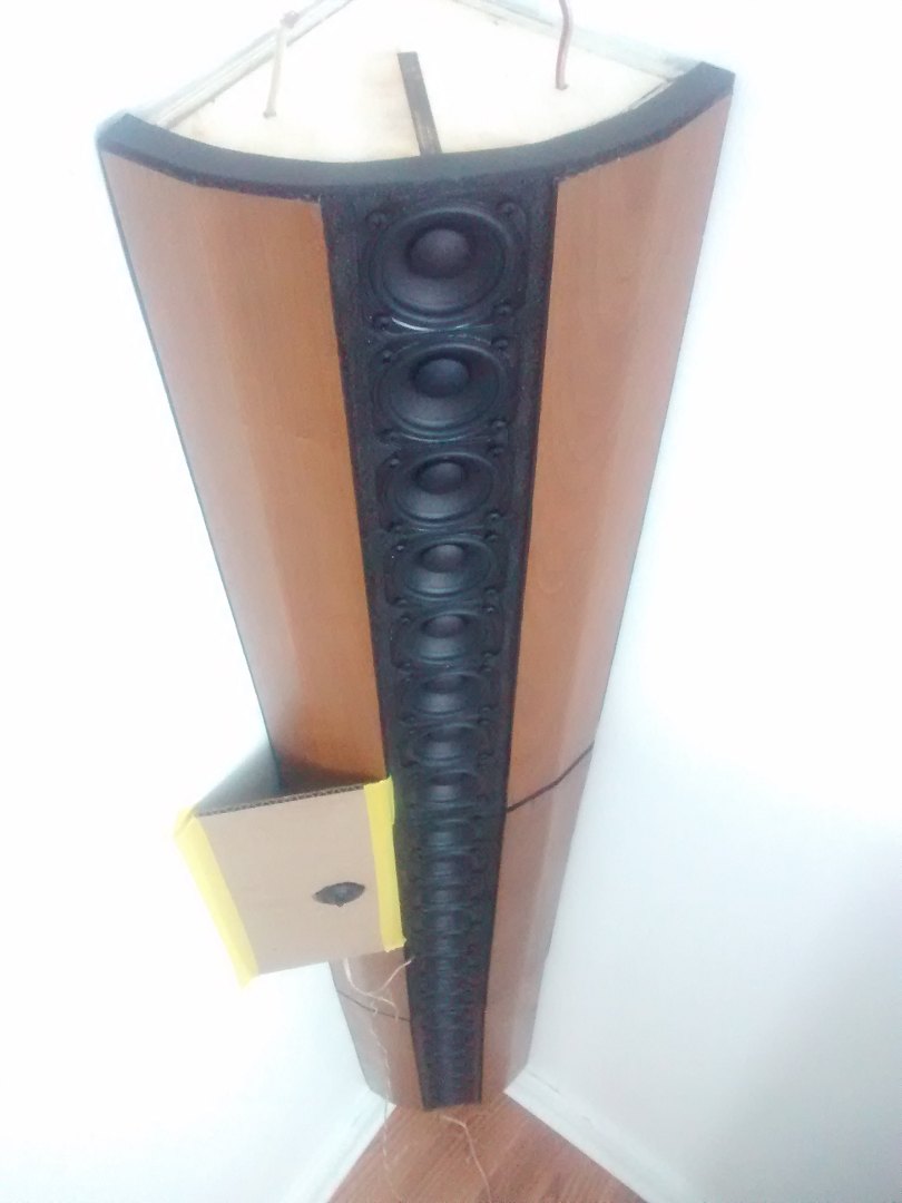

I had a picture saved for inspiration to do it like this:
(from BD Design)
But without the added horn .
(from BD Design)

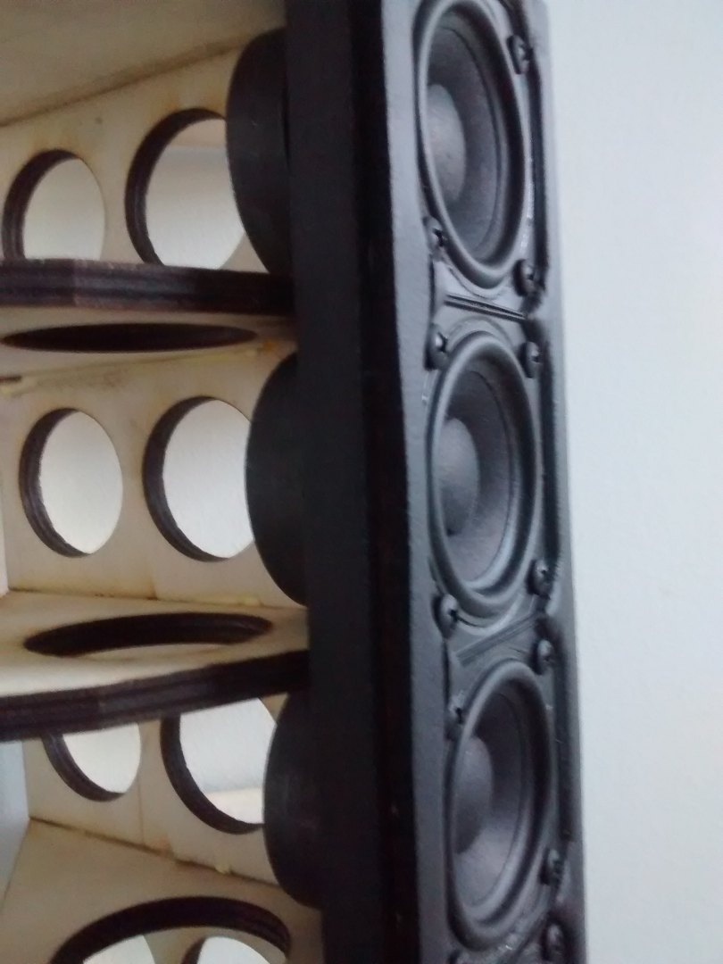

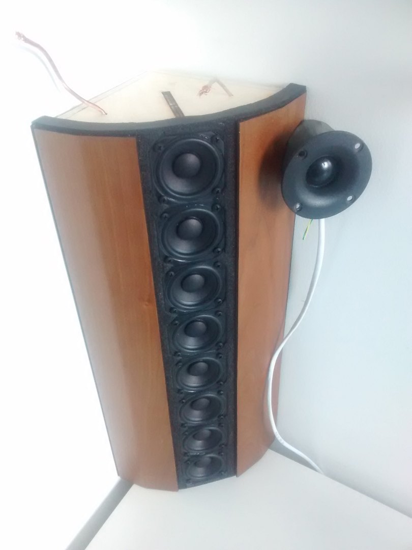

This is a very interesting project. Any news since the last post? Have you got the line arrays sorted or did you just scrap the project dynomike?
Also a short question, I'm pondering on building corner line arrays for myself, but the problem is my room measures just 3130mm to 3700mm. Maximum listening distance from front wall would be just about 2,7 meters. Is this just begging for trouble with line arrays?
Hi Mayuri,

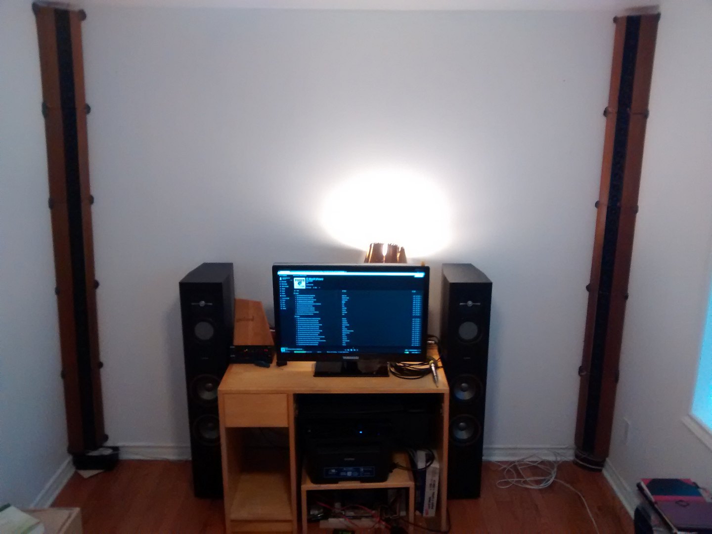

No I haven't made any progress. There are a few things that need to happen for the project to proceed:
1. Floor to ceiling absorption surrounding the arrays (in the corners) in order to catch the extremely early reflections that are clouding things around 4kHz. (I posed about this before but still haven't dealt with it properly).
2. Even vertical distribution of absorption in the room. The image pulls up because the room is more reverberent at the top (due to normal furniture objects in the bottom half).
3. Properly integrated woofers. Infinite baffle built into the front wall would be ideal, but I can't do that. A very shallow but wide or tall enclosure could work with say, Dayton RS-225's (2-4 per side).
4. Full absorption on the back wall. Because it is a small room (like yours), the listening position is close to the back wall and the reflection there is a problem. Probably a heavy curtain with (ideally) rockwool / rigid fiberglas underneath.
Basically, I was surprised to find that they require more, not less, room treatment than conventional speakers. I also made a poor choice trying to economize on the drivers (vs. getting the TC7 or TC6Fx00), and if I were to do it again, I would use the TC9's like everyone else and therefore skip the separate woofer cabinets.
So yeah, basically a failed project. They are still mounted in my corners just because I don't know what else to do with them.
