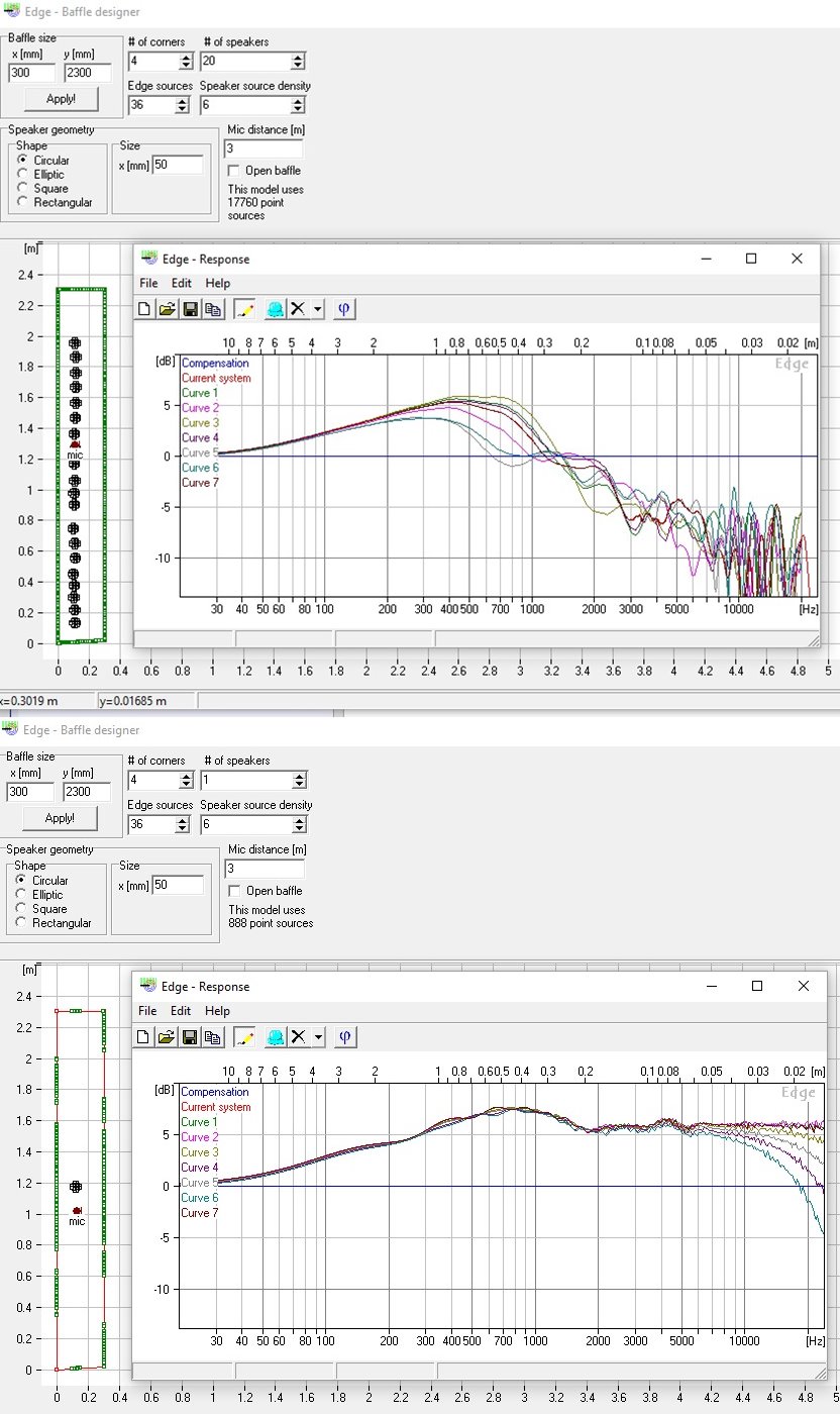

I should have pointed out before, TMM, that I get some of your points but not sure about all of it... fully agree with quote below, which I believe is what causes the downward slope in general from line arrays:
TMM said:summing of two equal amplitude incoherent (arbitrary phase) sources is +3dB and summing of two equal amplitude coherent (in-phase) sources is +6dB.
I just can't see how distance to the array (within reason) would cause HF dropoff. I will absolutely measure when I get home.
Thanks for the advice, there's a lot to think about. The difficulty with learning empirically about line arrays is they take so damn long to build (and so many parts!)
Why would the physical center-to-center spacing matter for an array with a large number of drivers?The first analogy is accurate only at frequencies close to the wavelength given by the height of the array. The second point is true but does not address comb filtering due to center-to-center spacing, which is absolutely a real thing with conical drivers.
Combing due to the center-to-center distance in a smaller speaker (e.g. a conventional 2 or 3 way with 2-3 drivers) is exactly the same mechanism as combing in a large array.
The reason the distance from one driver to the adjacent one in a large array no longer becomes important is because combing between drivers which are much further apart completely dominates at the listening position. i.e. if you have 20 drivers in a vertical array, the combing between two adjacent drivers around the center of the array is going to be insignificant compared to the combing created between the drivers in the center and the ends of the array.
Effectively the dominant CTC distance at the listening position becomes somewhere about half the length of the entire array.
Because the phase relationship at the listening position is going to be chaotic between all the drivers at HF. The phase between every driver is going to be somewhere between 0deg (in phase) and 180deg (cancelling) because the drivers at the ends of the array are physically further away from your ears, giving you an average of 90deg of phase. 90deg out of phase between two noise sources sum to +3dB, where as in-phase sums to +6dB. Thus you get in-phase summing at low freq and 90deg out of phase summing at HF causing a 3dB shelf (not 3dB/oct, it doesn't get any worse than -3dB) in the HF response. Note that unless you have a huge number of drivers you will still experience peaks and nulls (i.e. combing), but smoothed out you will observe an average 3dB drop in level.I just can't see how distance to the array (within reason) would cause HF dropoff. I will absolutely measure when I get home.
With time alignment (curved baffle or DSP) to get all the drivers in phase at the listening position, you don't get this problem.
Why would the ends of the array "dominate" the combing? All drive units contribute equally to the summed response at the measuring point. If the interunit spacing causes a phase shift of 360 degrees, you get perfect summation, 180 degrees gives you perfect cancellation. The ends of the array (and all other drivers in the array) will have some phase shift between 0 and 360 degrees; it does not matter how tall the array is.
You are correct in that the summation is somewhat random along the front of the array, which gives rise to the +3db addition, unlike the +6db addition in lower frequencies. Now add one more thought to this thinking: phase shifts caused by interunit spacing are related to frequencies and interunit distances. Phase shift at 20 kHz is going to be twice the amount at 10 kHz. Similarly, phase shift between two 4" drivers is going to be twice as much as between two 2" drivers. What this does is it pushes the frequency at which comb filtering begins up or down. So, if you held everything constant, and doubled your interunit spacing, comb filtering will start one octave lower. If you doubled the listening distance, comb filtering will start one octave higher.

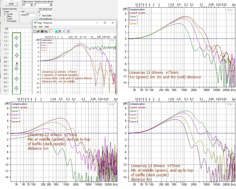

ra7: That's how I understand it. There is little (no?) relationship between the effects we are discussing and the height of the array - that high frequency combing effect is determined by the CTC spacing.
There are for sure measurable combing effects related to the height of the array which would occur in an anechoic environment even at lower frequencies - we just don't perceive them as such in a normal room. This would be where I agree with Murphy (or Toole) 100% that yes, there is combing but no, you can't hear it.
A lot of ideas about line arrays seem to relate to their far-field usage, thinking about off-axis lobes and narrowing at long distance and high frequency... in the near-field and in real (somewhat reverberent) rooms its a bit of a different beast. I do agree that the CBT elegantly solves a lot of these theoretical problems, and having not heard one I can't say whether the straight line vs curved line has anything to do with the effects I'm hearing... nor has distance been a real factor, nor has the length of the line.
Aah you guys really should learn the Edge!
Here a collasche of four changing parameters
- numbers of drivers and spacing 1/2/6/12 drivers versus a single driver
- mic distance 1/2/3/4m (12 drivers)
- mic height center to top at 1m distance (12 drivers)
- mic height center to top at 4m distance (12 drivers)
