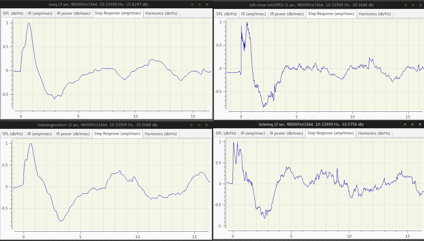

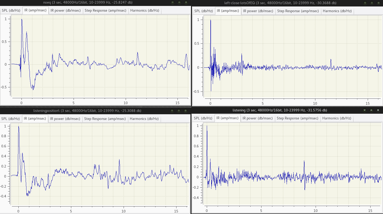

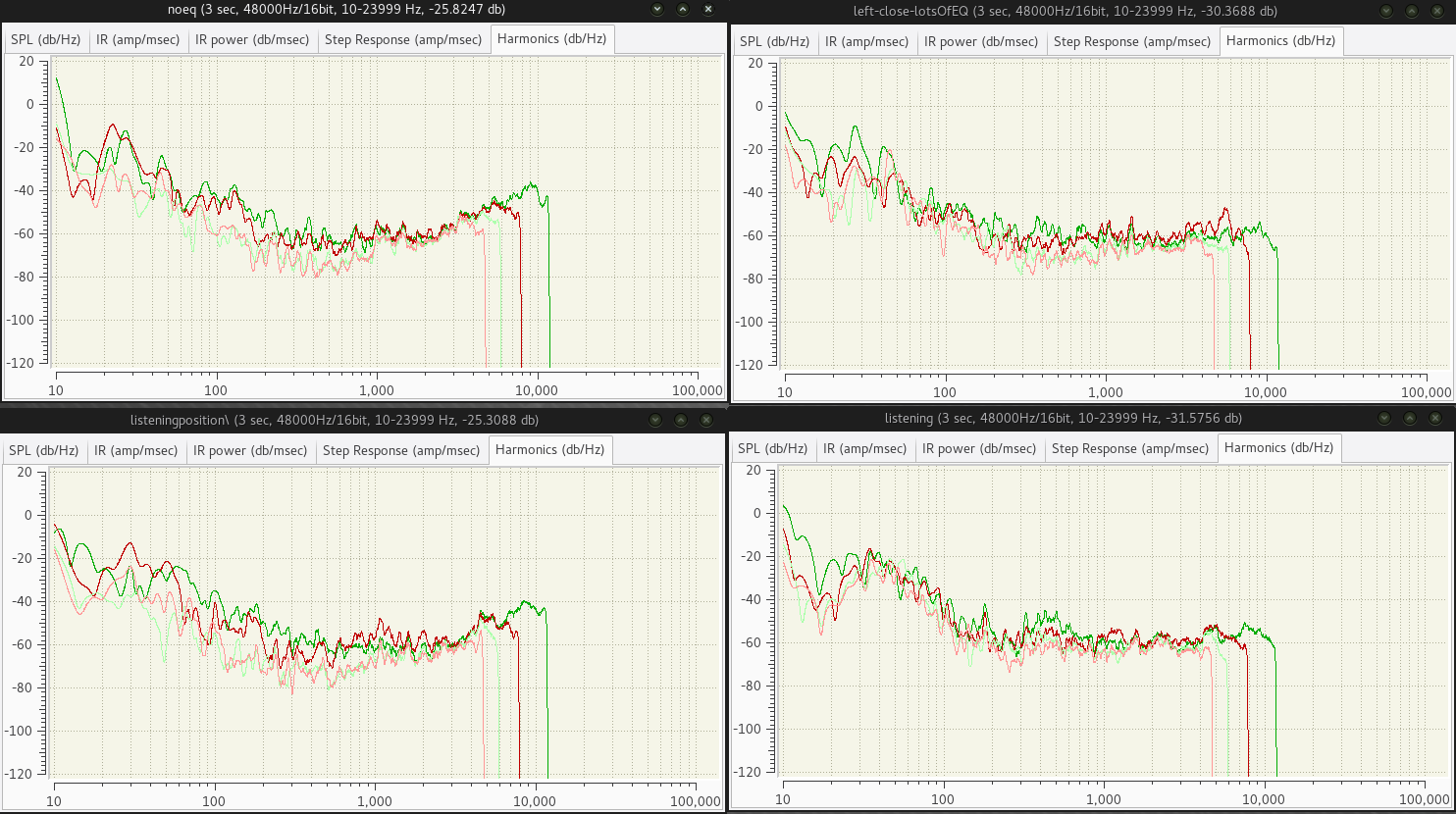

I've done some measurements with Qloud today. I don't know how to use REW though I would be happy to learn, if it will help.
Here are the graphs. No averaging, just a single point. Vertically, all measurements are taken from the center of the 3 module array. No crossover, just the line array.
Legend:
1.0m no eq | 1.0m w/ eq
2.5m no eq | 2.5m w/ eq
Well I don't know how Qloud renders an IR so it's a bit harder to judge for me. There are a lot of choices for the software to show an IR. I'm pretty used to seeing the REW ones.
This was a single speaker? To judge it we need a single speaker. If this is a single one there are some strange things going on.
No thats the whole array. I'll try to do a single speaker tomorrow. I agree, that would be horrible for a single driver!
Yes, this was a single "mini-array" from the floor (not to ceiling, subjectively worse sound with the speakers going to the ceiling) of 24 drivers.

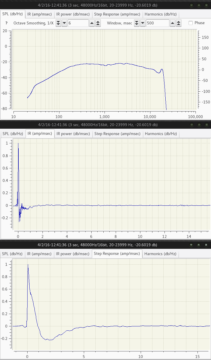

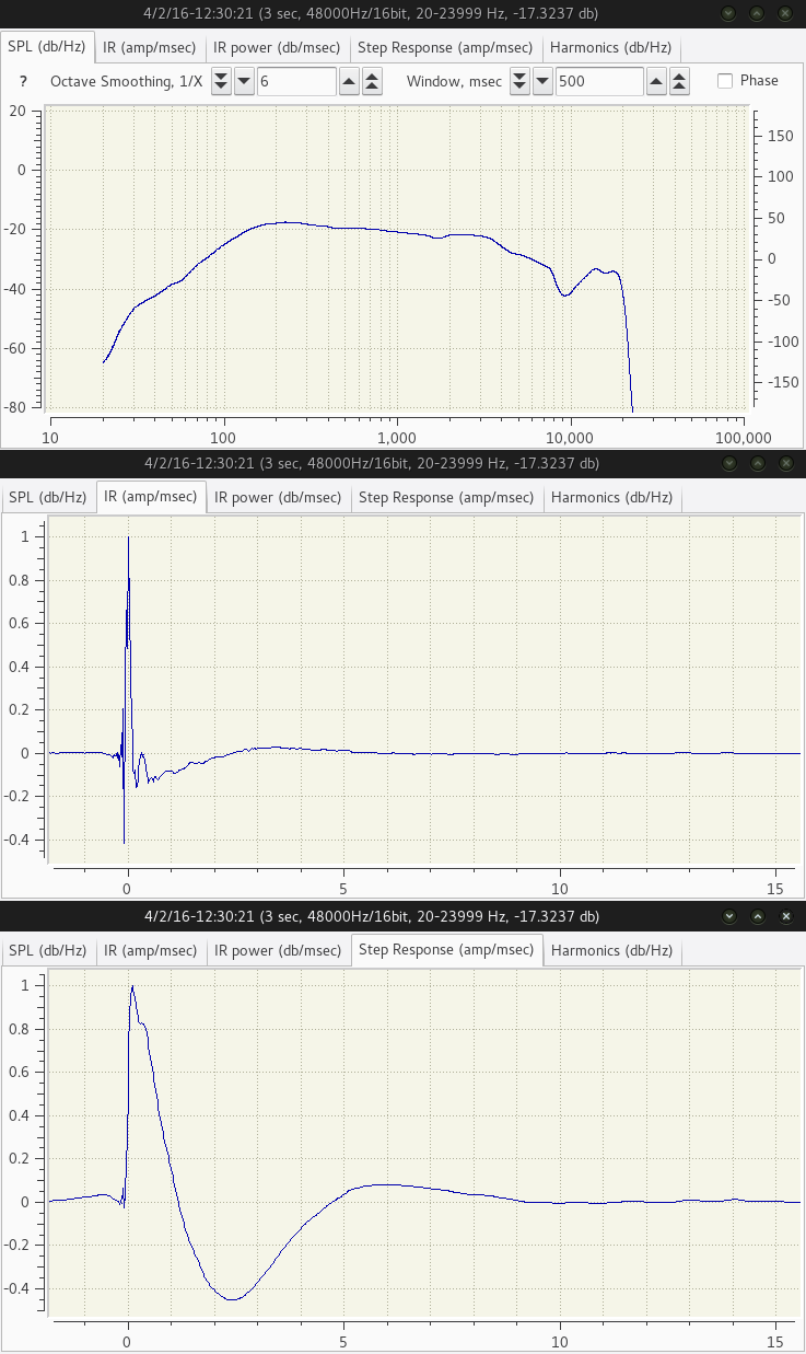

single driver measurements
tc6wd (used in the arrays - cheap one) vs tc6fc00 (neo expensive one, my fave of the tc6)
both measured at around 2"... think the crazy dip on the tc6wd is an artifact of the close measurement (baffle diffraction?), yet it didn't show up on the other one.. different enclosures though (fc had a spherical enclosure)
