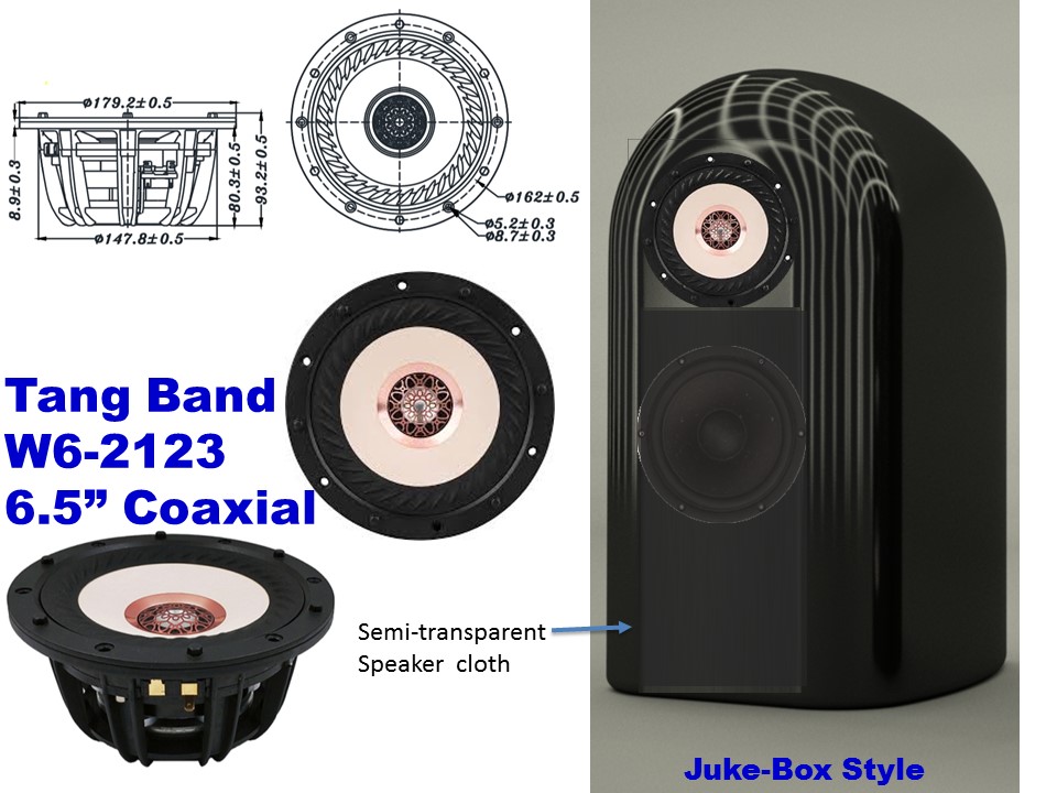

The only woofer I have hanging at home right now is a TB W8-1363SBF. I will try to put it under the coax and see how it goes.
Not a good idea - (that driver's an inefficient sub). You really need something that will fill/blend with the driver in the midrange for baffle-step compensation. That midrange head-shell on the 802 will probably start near 1 kHz for it's pressure loss (though it should be more gradual because of its spherical shape), so you'll either need something that compensates up that far up OR you'll need to shelve the coax (..and resistance sucks, literally). ..and realistically it will probably be a combination. 😱
Satori's are of course silly money.. it was really just an aesthetic thing. 😀
..now a couple of these in parallel, has possibility:
SB Acoustics SB20PFC30-8
Thanks ScottG, indeed, the W8 sub is very inefficient, and starts to drop after 100Hz... it was just for a small test, but I had no intention of using it for good.
I did notice that driver when I was looking at the SBA's website. looks like an ok driver at a very good price.
Two of them will bring me up to 93-95dBs... way above the 87dB of the 2313. I'll need resistance! 😉
So, maybe only one, down firing from under the jukebox shape.

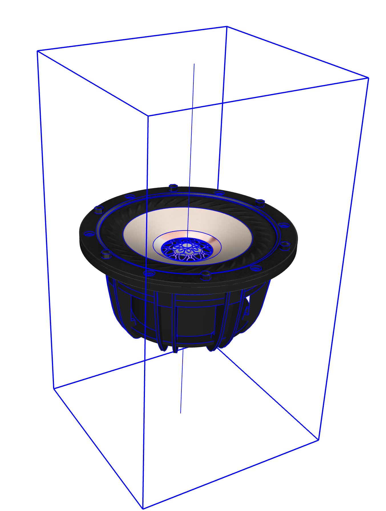

Tang Band W6-2313 3D model. Does not have all details such as connectors, but for mounting purposes all relevant bits should be in there.

Juke-BoxWith a woofer underneath, it's starting to look like a Minion.... Not exactly the looks I was hoping for!
A semi-transparent grill cloth could be used over just the woofer to allow the coaxial to visually POP without muffling the tweeter.
Juke-Box
