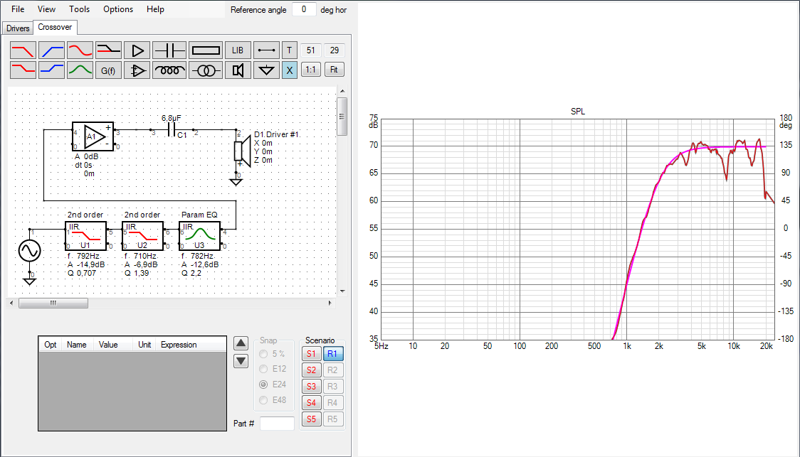

Guess best you can do is measure tweeter in situation and use free XSim or VituixCAD to massage the rest into 4th order LR target, because a 1st order capacitor divided driver impedance times drivers natural 2nd order roll off plus baffle in situation is hard to predict transfer into real target curve.
Below is dirty quick rough example from VirtuixCAD using ONNI's curve, it takes two 2nd order low shelves plus one PEQ EQ's combined 6,8uF capacitor, but its not good enough to copy because ONNI used another capacitor in his measurements for that curve and also baffle is not the same.

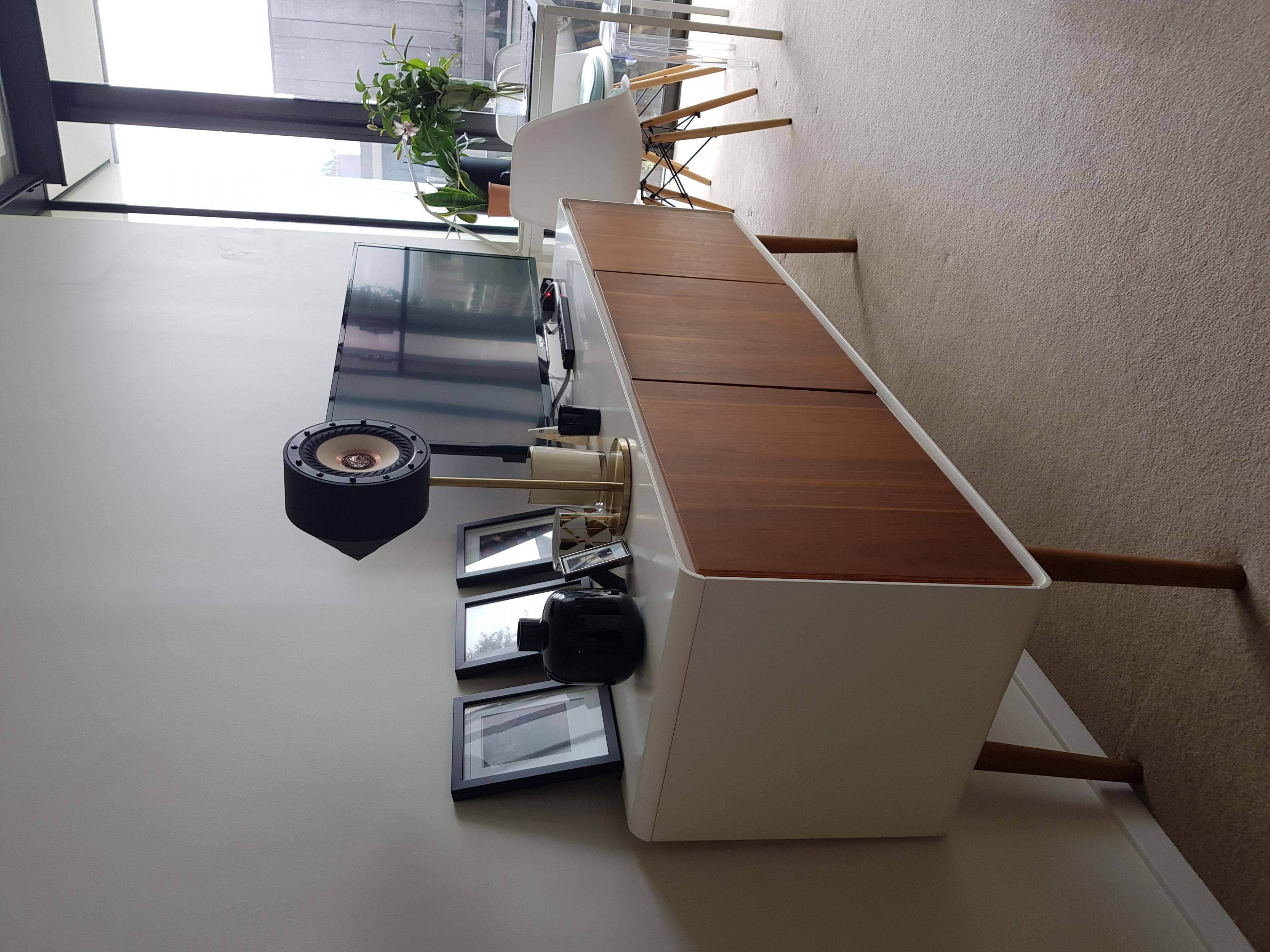

It is alive!

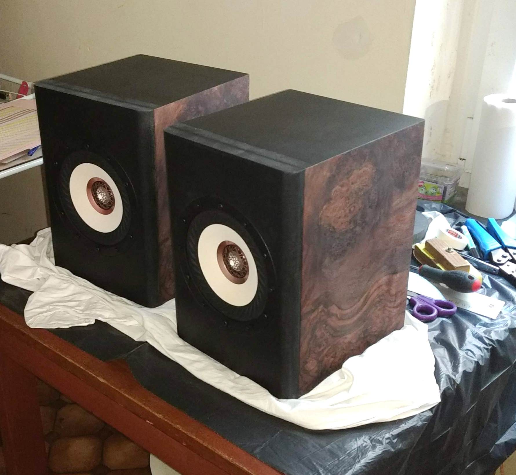

This is my first ever speaker build and I can't express how happy I am that it actually works and it sounds good!
Base is an Ikea lamp base and enclosure is 3D printed in carbon fibre PLA composite. Sounds fancy but it is not really. It is stronger than regular plastic though. Surface also has a really nice finish with a bit of a graphite like shine.
As expected, performance in the low end is missing. On to building a sub I guess. 🙂

Nice, but yes that minimal round baffle is not helping the bass at all, and driver's excursion is challenged. You will obviously need to cross around 200Hz, not just a subwoofer!

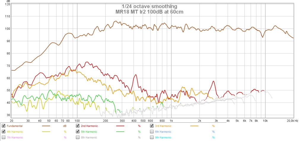

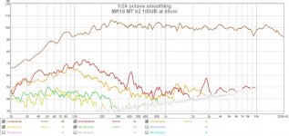

Can you show room response of a single speaker? REW's Distortion graphics shows fundamental spl representing room response, if measurement is taken at spot.
Here is my IKEA bowl with SEAS MR18 coaxial, no highpass, measured at 60 cm. It is easy to see where the woofer starts to have problems.
