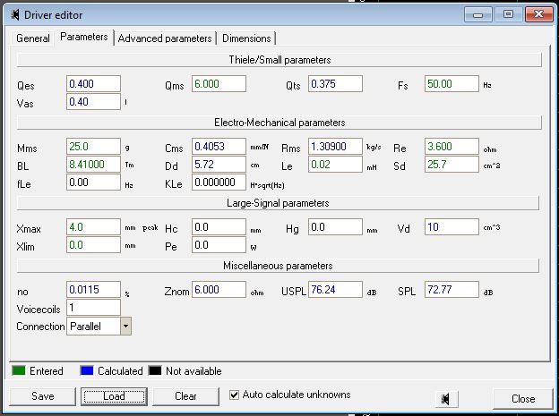

I spent some time calculating the BL62/RE of many based on the info on Parts Express for many. I'm not sure how useful this information is (I'm a DIY noob) but here it is.. .
TB 6.5” coax – 8.41^2 / 3.6 = 19.647 (4mm xmax with 87db sensitivity)
TB 8” coax – 7.459^2 / 3.6 = 15.455 (6mm xmax with 90db sensitivity)

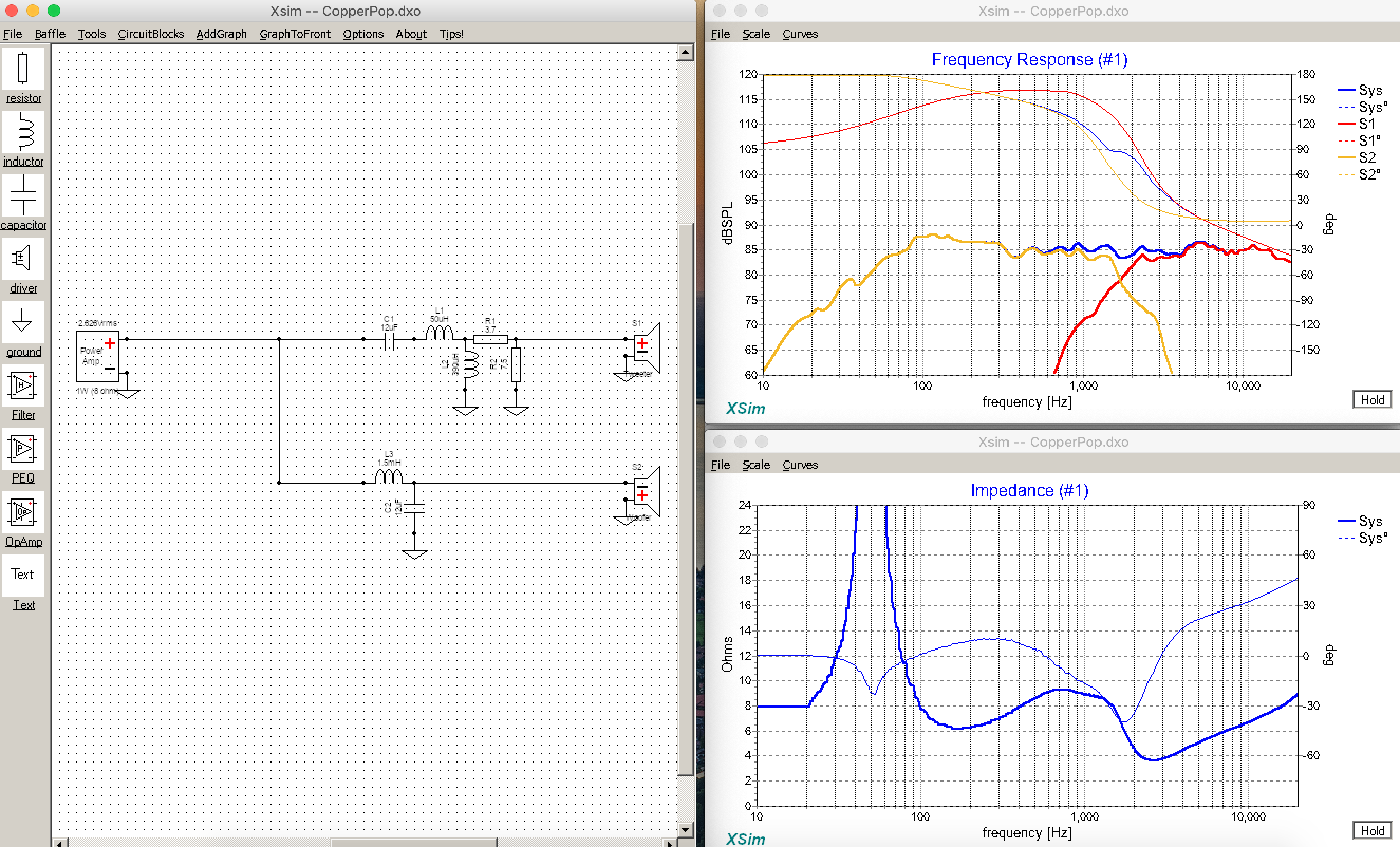

So right now I'm building a pair of these in 0.23cuFT cabinets with a simple port but a somewhat complex network that's a riff off the earlier ones on this thread.
I also have the ability to do these fully active with a MiniDSP, and may go that route depending.
Here's the crossover as it stands. Feedback is welcome. Parts arrive on Friday!

Too low cross-over frequency?
Do you have any indication, that the tweeter will sound good at such a low cross-over frequency? 40 years of expirience tells me, that´s it's too low. My units are en route, but I'm going to try various frequencies via DSP and then emulate that with the passive cross-over. 25oo Hz 18db/oct. would be my starting point. Possibly with a RCL network across the tweeter section in the passive version of the filter.

Perceval, what does the 20mf cap and 13 ohm resistor do?

Never mind. I see now they're a Zobel. Just not used to seeing them there.
