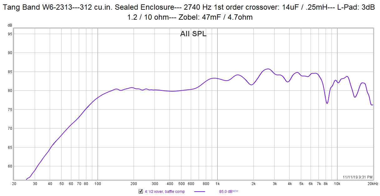

New crossover: (I could smell the frustration in your voices)
2740 Hz 1st order crossover: 14uF / .25mH
3dB L-Pad 1.2 / 10 ohm
47mF / 4.7ohm Zobel
This graph is merged near and far field, with a Baffle correction. 1 meter. And, yes, I'll pad down the tweeter some more. Xsim said 3dB would be enough.
I'm curious if the inbound replacement driver will have the same HF rollercoaster that this one has.

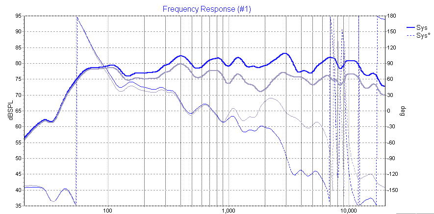

Your XO compared to mine (in grey).
I got a room node at 200Hz to fill in a little, and with listening to them a bit off axis, I have a nice gradual downslope.
In case you are wondering, my XO is from post 189
Your measurements match roughly mine, so yeah, probably. See here: https://www.diyaudio.com/forums/multi-way/331438-speakers-computer-desk-wall-6.html#post5858183
All coacial tweeters have troubles abovve 6-8kHz. KEF tangerine phase shield is the only really working remedy for that , that I know of.

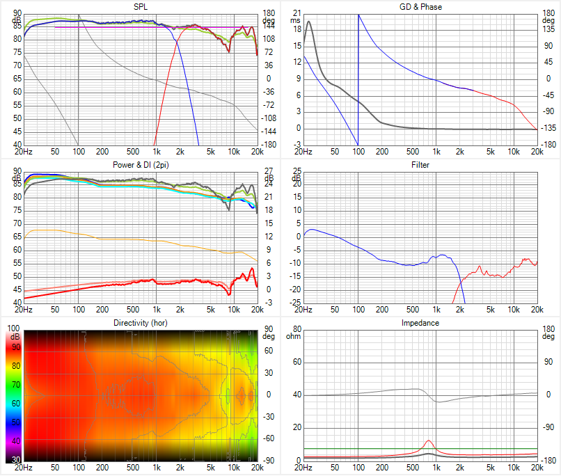

I just recieved mine a few days ago. here's my observations sofar.
As expected zero bass and what there is comes out distorted even at low levels.. 150 Hz 24 b/oct. active crossover makes miracles. Tweeter sound surprisingly good provided one aplies a higher order cross over frequency, so no 1. order ********, sounds absolutely horrible and strained. With the fully active setup 150 hz and 2500 hz LR 4 th. order and we are talking absolutely high end reproduction. The unevenness on axis i the last octave is not audible, but the advantage of having a point source is. Dispersion is better than expected.

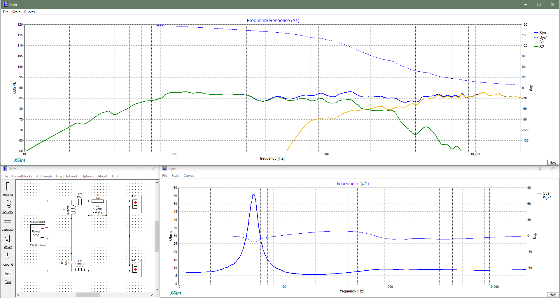

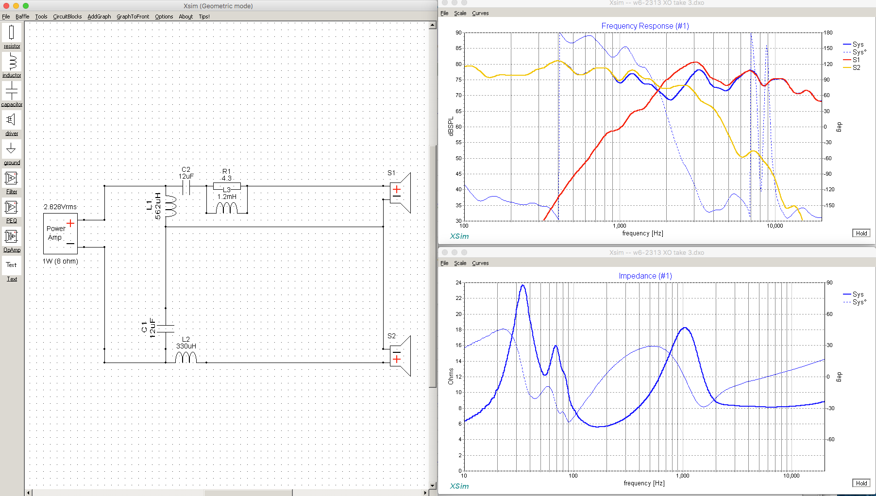

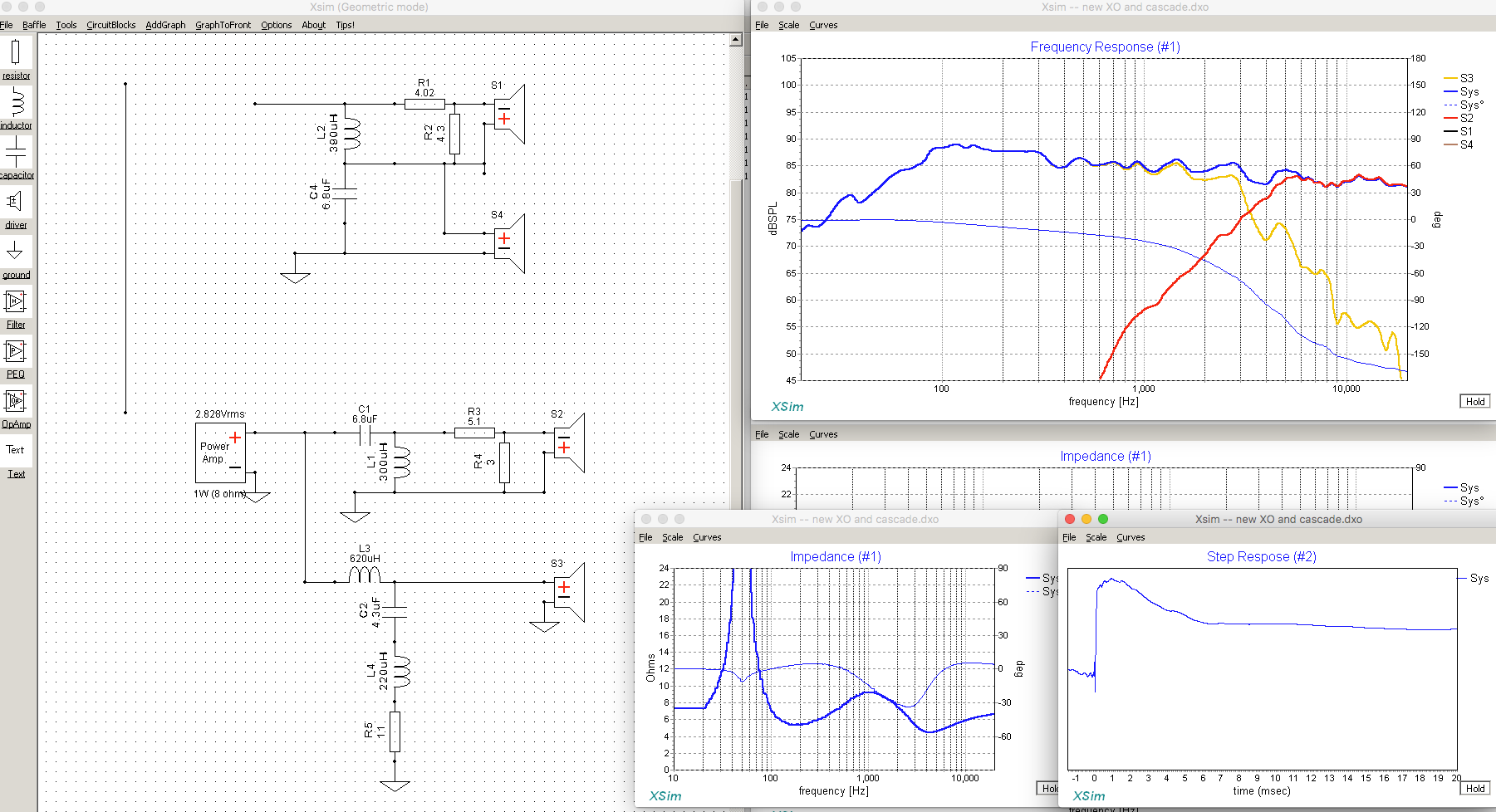

It's been a while, and the drivers have been collecting dust on a shelf, but I am slowly coming around to finish them.
I liked the last XO I made for them, but, I always like to tinker, so I just had to....
Came up with these two.
They look very similar in the end, but one has much lower parts count than the other.
Although that one has a slight dip at 3kHz, so it might dull the music a bit.
I will have to test... coming in the next 6 months, I guess... yep, always staying busy!
So, if someone wants to try, I'll put them down here.
Feel free to comment or give them a shot.

Sorry for the delay. Been busy.
Between the 6" or the 8".I'd go for the 6".
I believe someone here mentioned it sounded better, and yes, the 8" will start beaming much lower, making it harder to cross over the tweeter.
There are no major flaws, but I've had two little issues.
-There is a dip at 4.5kHz that makes it hard to cross cleanly over the tweeter.
- The speaker tabs plastic mounts are very fragile, and I broke one with only very little force applied. Will need to be glued back later.
The tweeter does the job, but it isn't the cleanest FR I've ever seen. There are some interactions from the cone.
That Genelec monitor uses heavy DSP to cross their drivers, and change the FR according to the user's needs.
Any kind of setup can be made to look good on paper with heavy DSP lifting.
So, if your plans include the use of DSP, then I wouldn't worry too much. It will be easy to make each part of the curves look good and provide a good transition. I'd probably try a Harsch XO if going DSP.
This driver is smooth and clean. I'm sure it can handle a bit of "curve massaging" to make it sound exactly as you need it to be.
And they do physically look good!

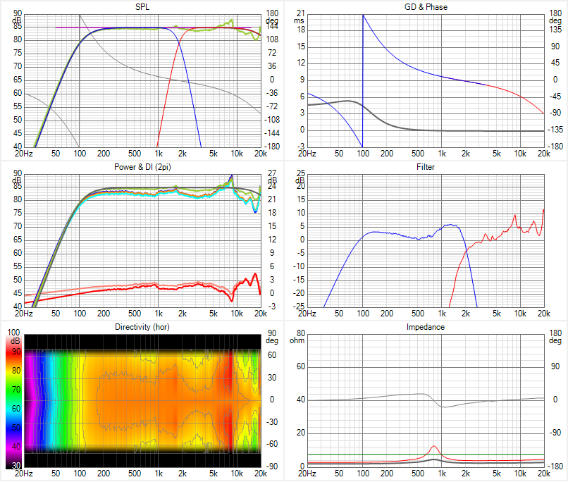

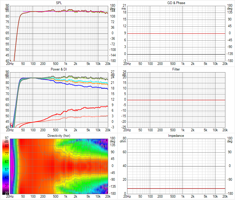

For info using onni's 0/30/60 directivity in post 93/94 we far from good coverage but also far from any 8341A perfomance, in first visual below EQ mirrors is used to massage a known textbook passband of 100Hz-20kHz and steep linear phase XO region @1822Hz because their DI cross briefly there, in second visual systempass band for PIR is massage to JBL trained listener curve from Toole's book first edition, third visual ASR analyze of 8341A tweeter looks have interference problems in 9kHz area and phase havoc into perceval's Xsim plot post 316 looks confirm this.
Hi BYRTT,
Very interesting figures! From these figures, I can guess your message is that it might be futile to attempt to use the TB 6" coaxial to achieve something that is close to the measurements of the Genelec 8341A. Did I get it right?
What do you think is the "secret sauce" that distinguishes the coaxial used in the 8341A from the TB 6" coaxial? Or is the difference really in how the shallow waveguide of the 8341A helps in taming the interference dips and the associated wild phase swings?
