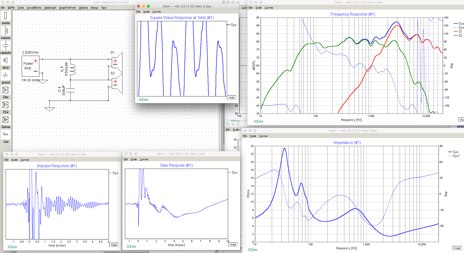

Ok, what is a largish cap? Is 33uF large enough?
If I put a 33uF with a 0.150mH inductor, this is what I get... I'm sure that you can see the ragged displays in those graphs, and it should somehow tell you that it would be horrible to listen to.
But, there is nothing that says you can't do it, especially not at DIYAudio!

Largish of course means in comparison to something. Such as in comparison to what one would crudely get from a text book calculator for a given inductor value. 33 muF in relation to 0.15 mH is not largish but plain unreasonable.
I did not mean to bother anybody to perform free simulations for me as I don't have much faith in sims and measurements anyway. Good luck with your project...

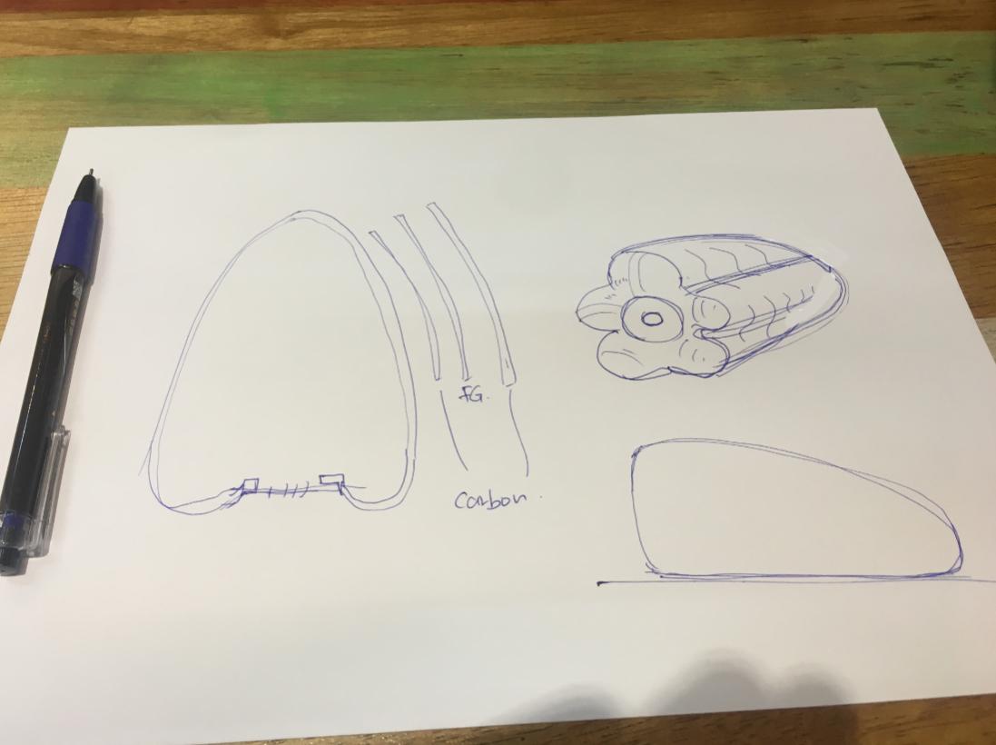

Trying to come up with an enclosure....
Had a discussion with a friend of mine, and times are tough.
He's a master of dealing with composites.
So, I decided to give him a small job. I'll come up with an enclosure, and he will make it in carbon fiber. That should bring out the W6-2313 nicely!

Trying to come up with an enclosure.... a friend of mine is a master of dealing with composites... I'll come up with a W6-2313 enclosure, and he will make it in carbon fiber.
A "Juke-Box" shape cabinet is a great combination of form+function

-well certainly it would have to be a vertical pair of Satori MW19PNW-8 (parallel) below the TB coax in a smaller version of the B&W 802 (sans tweeter), yes?
I really like that "jukebox" style, LineSource. It's tempting. It might just work.
It's funny, ScottG, the B&W were in the back of my mind, and I have started to think if I should have the 2313 by itself (needing a sub or two), or combine with a woofer, for the whole package. The only woofer I have hanging at home right now is a TB W8-1363SBF. I will try to put it under the coax and see how it goes.
I'd like to have a small version speaker, so, no dual Satoris! I already have my big OBs with 15" woofers, the dual SBA race track woofers are in the design process as well, and this could be a smaller system.
Waveinform, I think I'd prefer a teardrop shape. We were playing around with my friend and sketched this:
