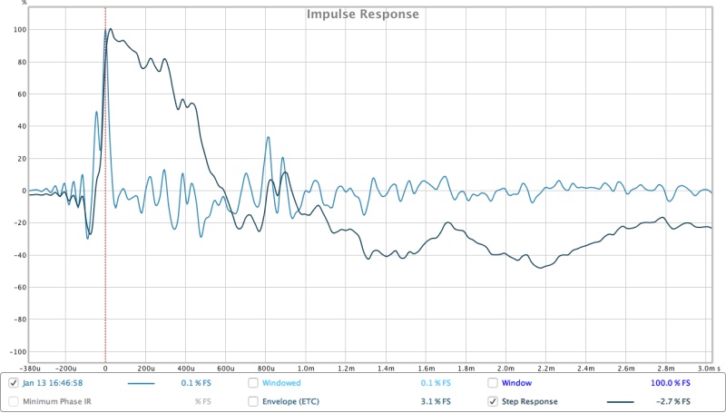

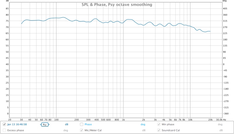

Been tweaking a bit more.
Now, I really like the soundstage these W6-2313 are putting out there.
The sound image is very 3D, extending far outside the physical speakers, but also fore and aft, making the singer stand in front of the speakers and the instruments panning around... YMMV as it also depends on good recordings.
I was wondering if I would add woofers, or just deal with a sub.
I happen to have 2 subs. One 300w commercial Yamaha box, and a DIY horn with the TB W8-740Q inside.
I've always had trouble integrating the two. Everyone keeps saying that 2 (or more) subs are better than one, but even though my subs are positioned in different places along the front wall, they never played nicely with each other.
I was reading an article where the owner was using multiple subs, and got a better response when one of the subs phase was flipped.
Well... epiphany!
I flipped the phase on the horn sub, and everything smoothed itself out!
Somehow, even though spaced apart, the subs in phase were exciting the same nodes in the room. Once the phase was flipped on one, it filled the dips of the first one, without making the peaks worse, even smoothing them a bit.
Now, while the mic was set at the listening position, I timed aligned the subs to the W6 and it started to look, and sound, very good.
Had a long listening session that was very satisfying.
One day, I'll tackle the last remnants... the 20 to 30 Hz portion of the spectrum. I'm sure the neighbors will really hate me then! But for now, I'm quite pleased with my XO and sub integration.
These measurements have 2 small EQ notches to reduce the most annoying peaks in my room. Nothing major, about -3dBs, that went a long way to make it more enjoyable.

I am interested in getting this pair of Tang Band to experiment as a pair of near field speakers. Your FR curve seems to look very good. Rather than reinventing the wheel would be able to share with us your x-over network once you are happy with it? Thks.
Sure.
So far, it is the same as the last one I posted.
Since they have been playing for a while, I'll take another measurement to see if things have changed.
But my XO will ultimately for my room and my enclosure. Yours will surely vary from mine a bit.
I'd say go with that XO I posted, and adjust Rs according to taste.

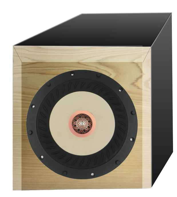

I was going to try an enclosure with the looks of the LS50, but the pieces of hinoki wood (camphor wood) I have are 30x33cm. Not big enough.
I would love to show them off with the "flower" design Mattes have with his OB project, but I can't come up with a design that includes the flower in front, and the closed enclosure behind.
I have some XPS foam to try and sculpt something. We'll see how it goes.
Or maybe I could do the whole box in minicell.... a soft panel enclosure.
or just stick with wood....
Options, options, options....
