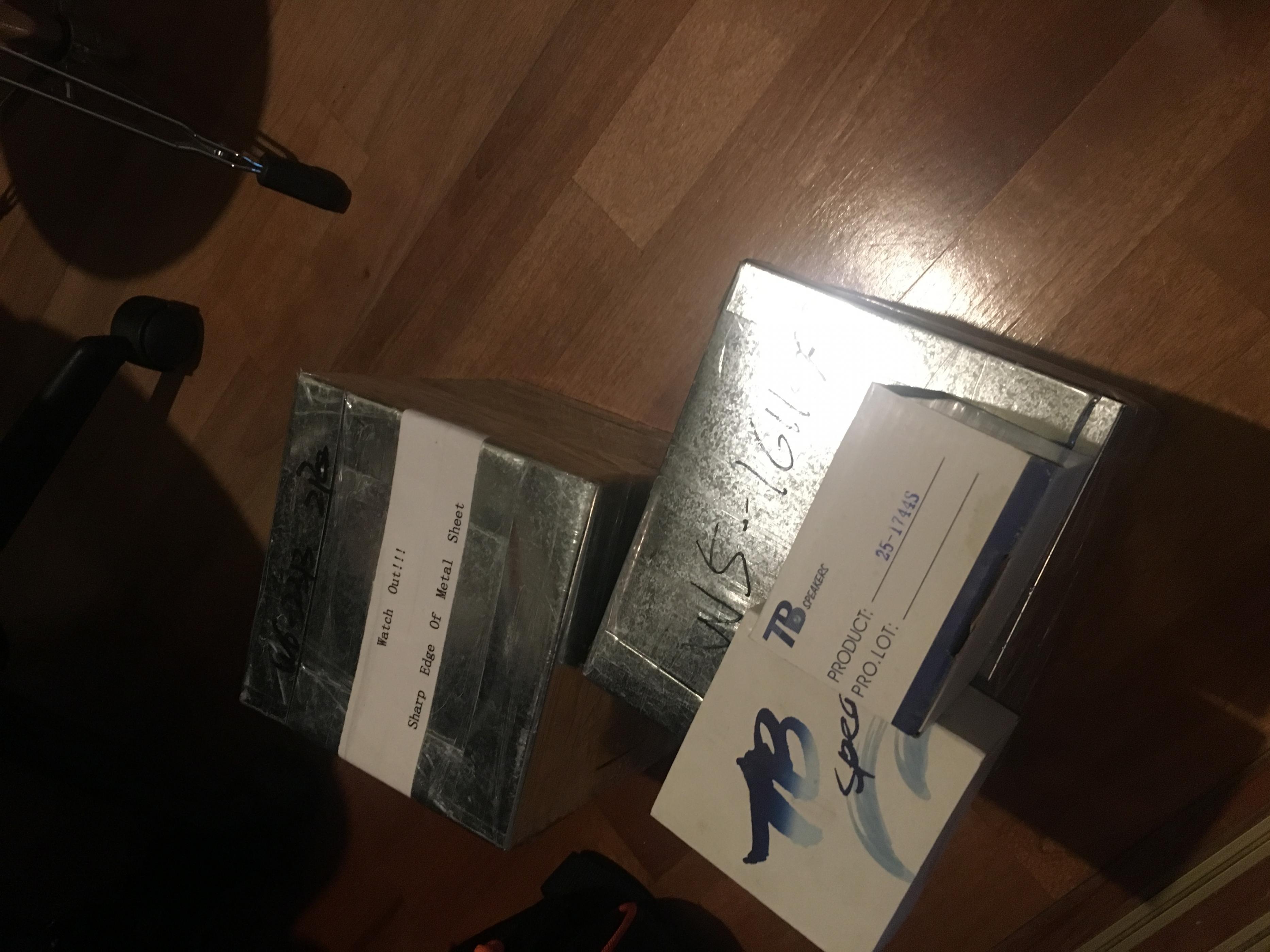

Just ordered a pair of 6.5"... They'll be here in about 2 weeks.
I'll get testing later. My plan is to do a LS50 lookalike.
