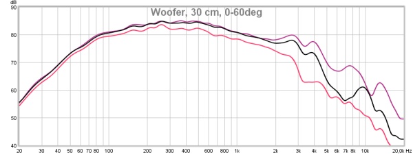

Woofer measurements

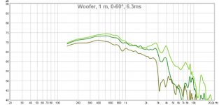

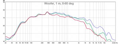

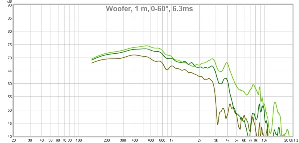

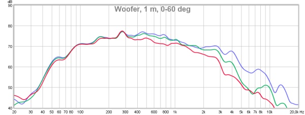

Here are some measurements I've done. They are done indoors and windowed before first reflection (6.3 ms).
Here is the noise floor:

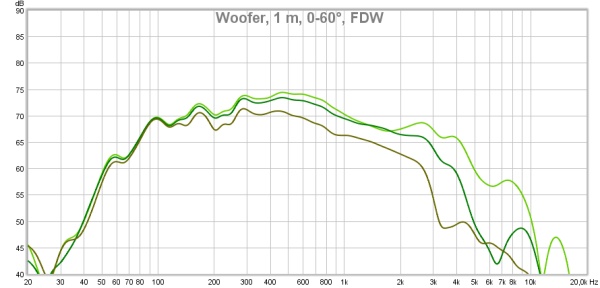

Here is response at 0, 30 and 60° at 30 cm distance:

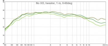

And at 1 m distance:

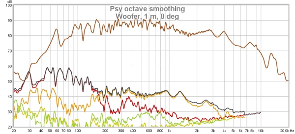

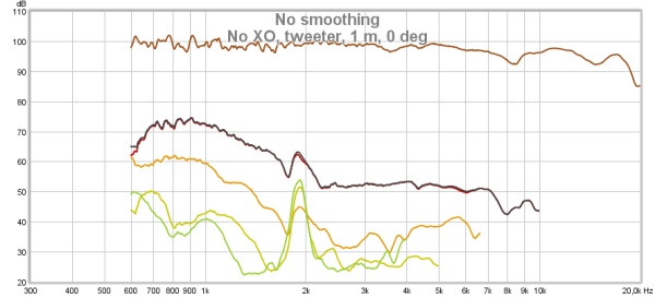

Here is distortion at 1 m, 0° and about 85 dB:
It's mounted in a 7.5 l box filled with denim. Baffle is 36 cm x 56 cm with chamfered edges. Mounted 24 cm from top and 18 cm from both edges.
/Anton

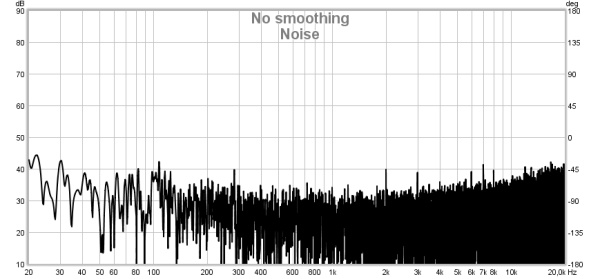

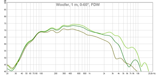

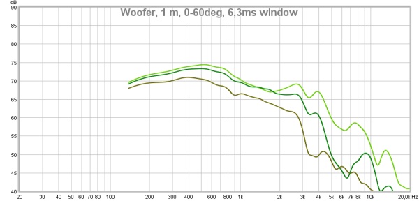

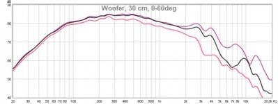

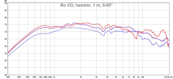

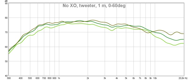

/Anton

All distances have been measured from tweeter grill (metal). Driver is flush mounted. I have not measured impedance nor drive level. Microphone is miniDSP umik-1 (calibrated).
It's weird that the tweeter response differs so fundamentally from manufacturer curves... Especially above 4 kHz.
/Anton

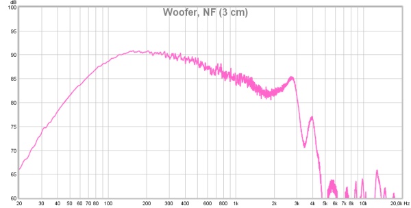

Near field measurement (3 cm):

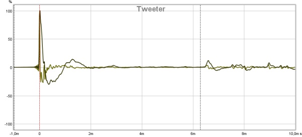

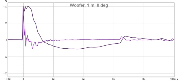

Impulse response at 1 m, 0°:
/Anton
Since the tweeter curves between the two drivers are identical and yet have different effective waveguide depths, I'm wondering if those curves are for flush-mounted tweeters on a flat baffle. Especially since the tweeter response seems to go much lower than seems apparent from the manufacturer curves. Just a thought.
Good point! Kind of misleading though...Since the tweeter curves between the two drivers are identical and yet have different effective waveguide depths, I'm wondering if those curves are for flush-mounted tweeters on a flat baffle. Especially since the tweeter response seems to go much lower than seems apparent from the manufacturer curves. Just a thought.
/Anton
Well, "kind of misleading" has long been the comments made on TB factory curves. If you can take measurements with a 2.83v drive, that should provide a more apples-to-apples comparison between your data and the factory data.

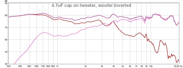

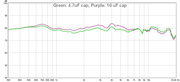

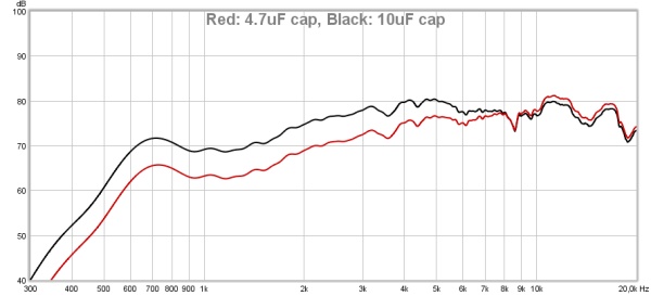

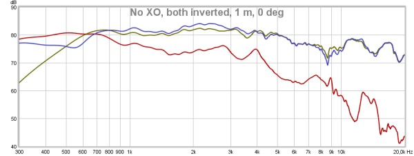

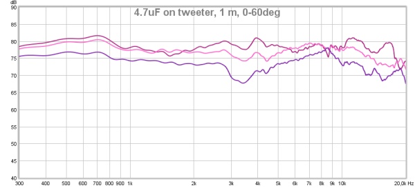

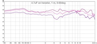

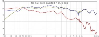

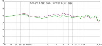

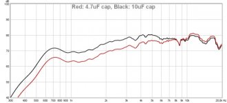

There is no built-in XO. I tested with a single cap as it was suggested in the thread. It works, but it's not very "flat". I tested two values.Onni,
Is the x-over between tweeter and woofer built-in or do you have to design and install it yourself?
Tweeter with cap:

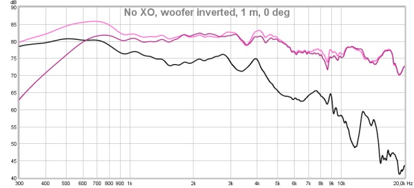

Together with woofer (inverted):

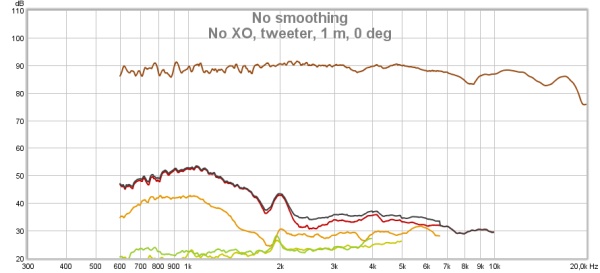

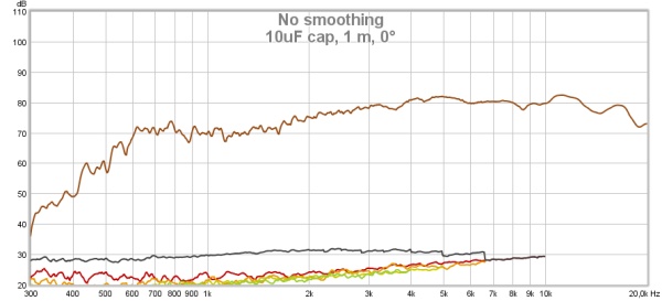

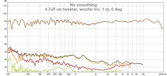

Distortion with only a 10uF cap:
Not sure if the single cap is enough protection, but it seems so given the low distortion. But someone more capable will probably design both very simplistic and quite complicated crossovers that you can use.
/Anton

This is not weird. This is normal, considering it's TB. Measurements results are kind of dissappointing, especially tweeter off-axis performance with diffraction issues clearly visible around. Tweeter waveguided by midrange cone should have smooth and uniformly descending 30- and 60-degree curves. Price of this driver is not too low, they probably could optimize it a bit more.
