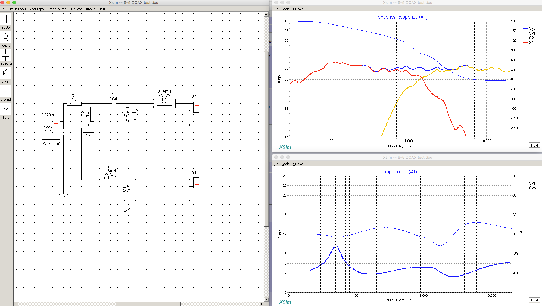

I find the XO to be a bit weird though... No lowpass for the woofer? The notch only affects the impedance as far as I can see. When I sim it with the factory curves i get this (still without baffle step):
The page says that the XO-point is 3 kHz, but that looks a lot higher than that...
/Anton
Yep, I tried the given XO, and it doesn't look great.
I've got the cleanest drop from both drivers when crossing at 1.45kH.

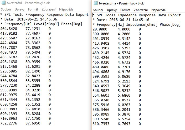

Hi Onni,
I used the data from you. Both LspCAD and VituixCAD give other results than your chart. The phases are not aligned to each other. I do not know where the bug is.

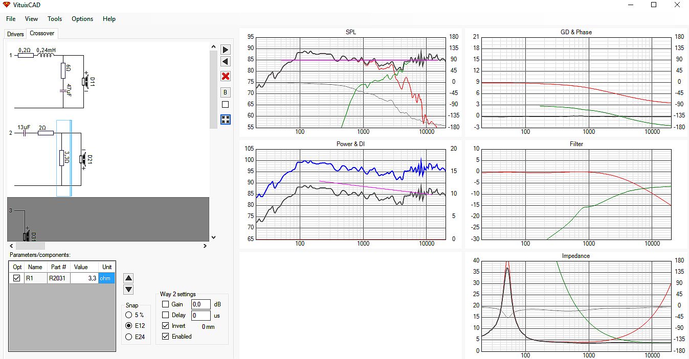

I started with first order filters, a Zobel and an L-pad and got this:
That's not so bad, right? I haven't added baffle diffraction yet though.
/Anton
Correct! I extracted phase within Xsim.I see it. In your published frd files, phase data are not included.
/Anton
/Anton
it's not there. Phases -0

Pandinus, Omi exacted the phase in XSim after importing the frd-zma files.
What's not known is the delay between the two sections.

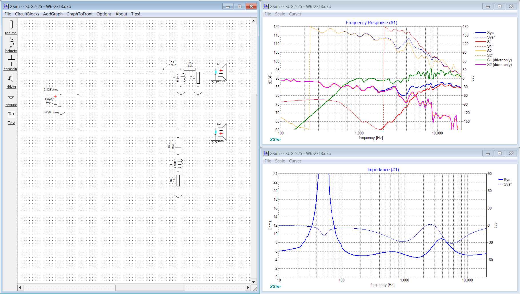

I got this, using both frd and zma files I made from the TB graph.
You can't place an L-pad out front like that. A single series resistor is okay, but a full L-pad is not bandwidth limited to the tweeter via the HP, and those resistors will get hot shedding that heat from 20-20k.
I highly advise against this.

Yes, exactly. Sorry for not being clear. I'm not sure if I can save the curves in Xsim.Pandinus, Omi exacted the phase in XSim after importing the frd-zma files.
I think that the delay should be close to 0 with this kind of setup (tweeter close to acoustic center of woofer). I'll make measurements when it arrives.
Later,
Wolf

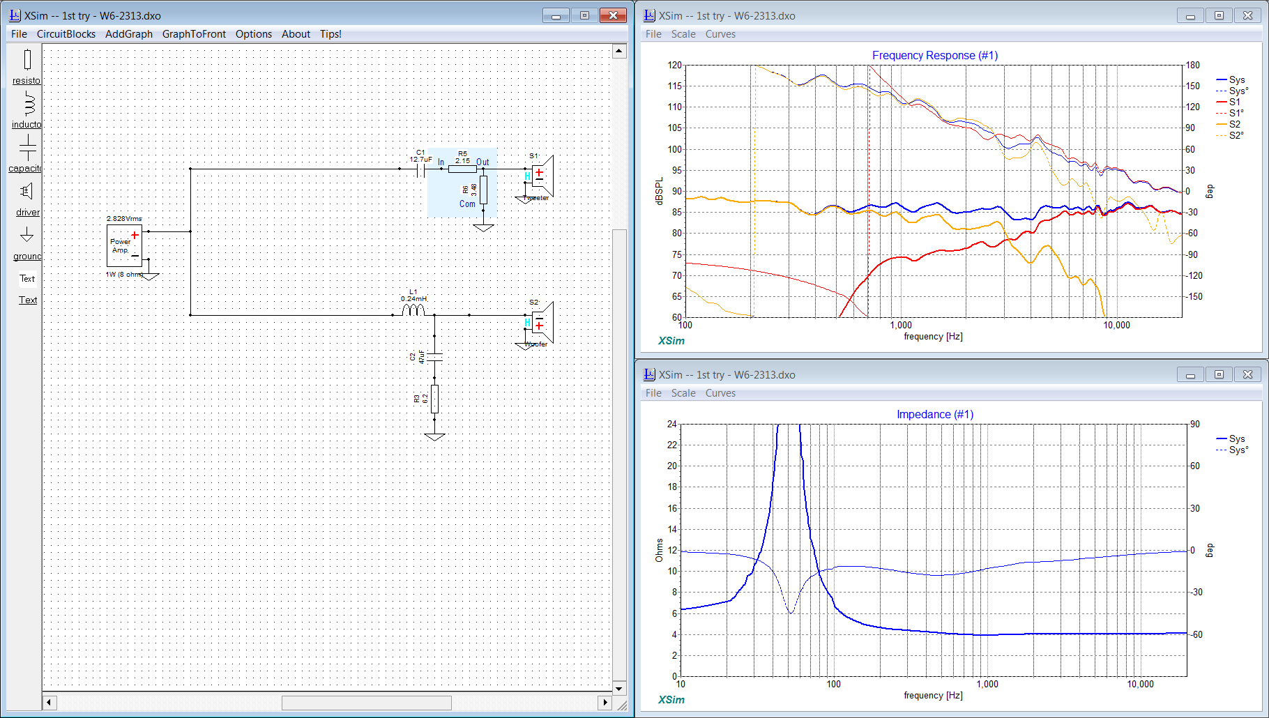

Oops! It was late and my eyes were crossing!
Just shows that because you can do a thing, it is not always a good thing to do so!
These sims allow us so many combinations, but there's nothing better than hands on experience!

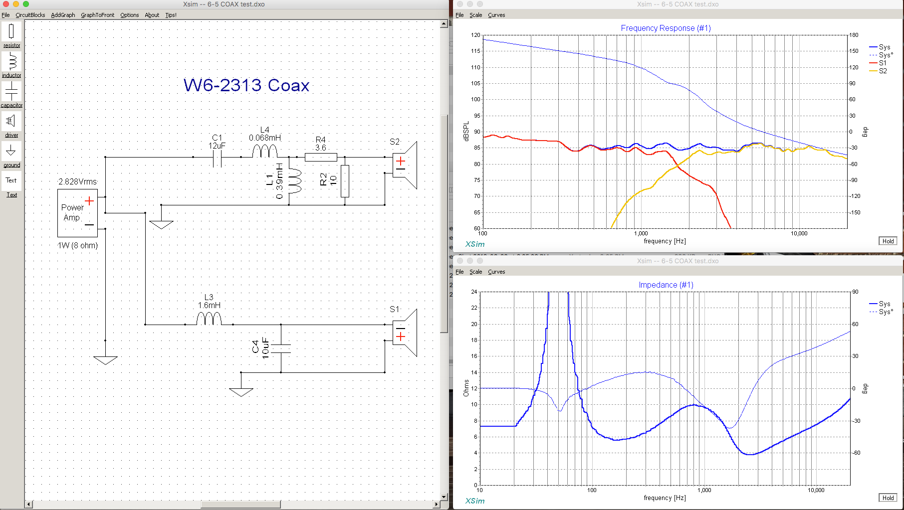

I re-did the W6 and also did the W8. Comments welcomed.
That looks good! Let's see how the tweeter feels about the low XO point.Oops! It was late and my eyes were crossing!
Are they wired with same polarity? I had woofer inverted.
/Anton
Woofers in both cases are inverted.
I crossed that low to take away the peak from the woofers at 2Khz which would interfere with the tweeter output.
TB says their tweeter can reach 800Hz, and I am about -15dB at 800Hz, and dropping fast.
I thought they meant that it's flat to 800, which is due to fs around that point and high Qt (around 0.8?).Woofers in both cases are inverted.
The phase in your sims is very smooth, how did you extract phase from measurements?
/Anton
