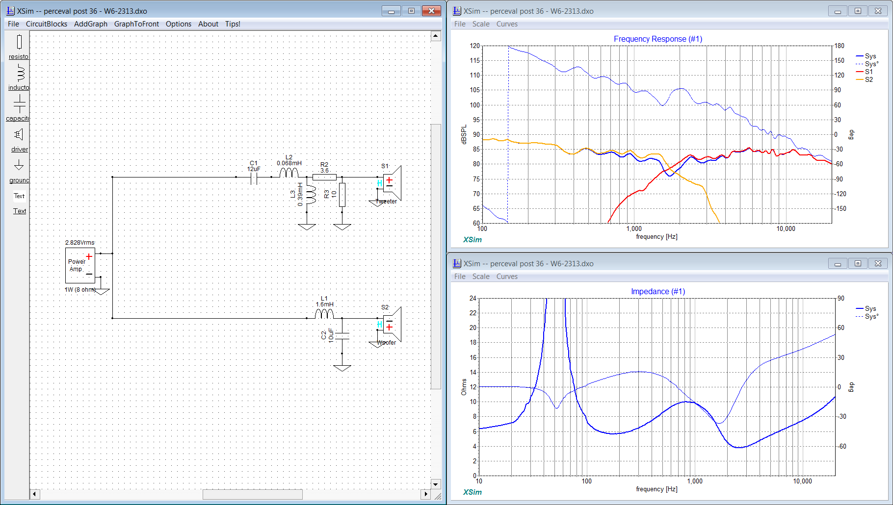

I'm confused... I tried your XO and I don't get the same results. It's either this (with woofer inverted):Oops! It was late and my eyes were crossing!
Just shows that because you can do a thing, it is not always a good thing to do so!
These sims allow us so many combinations, but there's nothing better than hands on experience!
I re-did the W6 and also did the W8. Comments welcomed.
Or this (with normal polarity):
I don't think the phase extraction was succesful in Xsim. If I choose "as measured" for the phase I get your results.
/Anton
Here are the frd and zma files I used, lets see if they are different from yours...
Edit... oops again! I had the phase "as measured"... switched to derived and yes, not as pretty anymore.

Well, the two peaks from the woofer, at 2.75kHz and 4.65kHz are really bothering me.
We'll have to see real world measurements... I have found that TB likes to "doctor" their FR curves often... so, if those two peaks are really there, and even worse than they appear, then it shall be difficult to do anything about them.
I don't know about that. I've had good results using TB plots in simulations. One design I did measured extremely flat like the sim, and I used TB manufacturer plots to get there. Now, do they smooth and shrink the vertical scale? Of course they do! But when you carefully trace the curves, you come out okay.

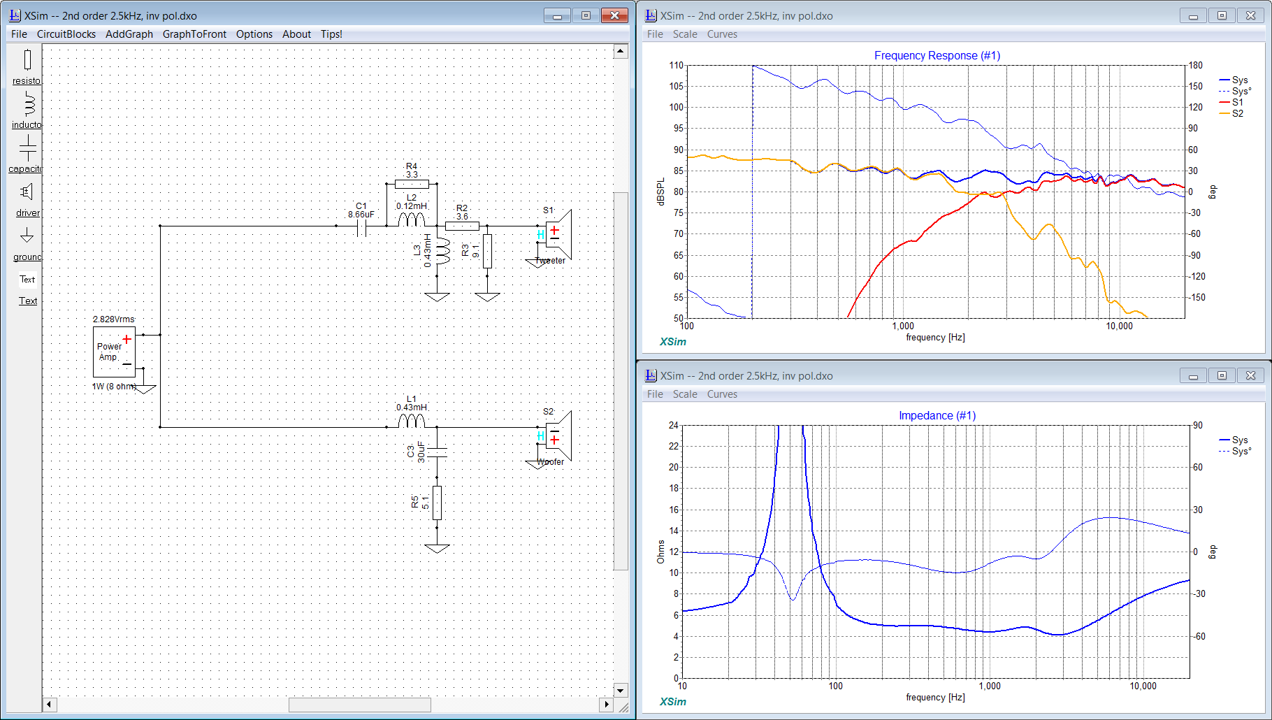

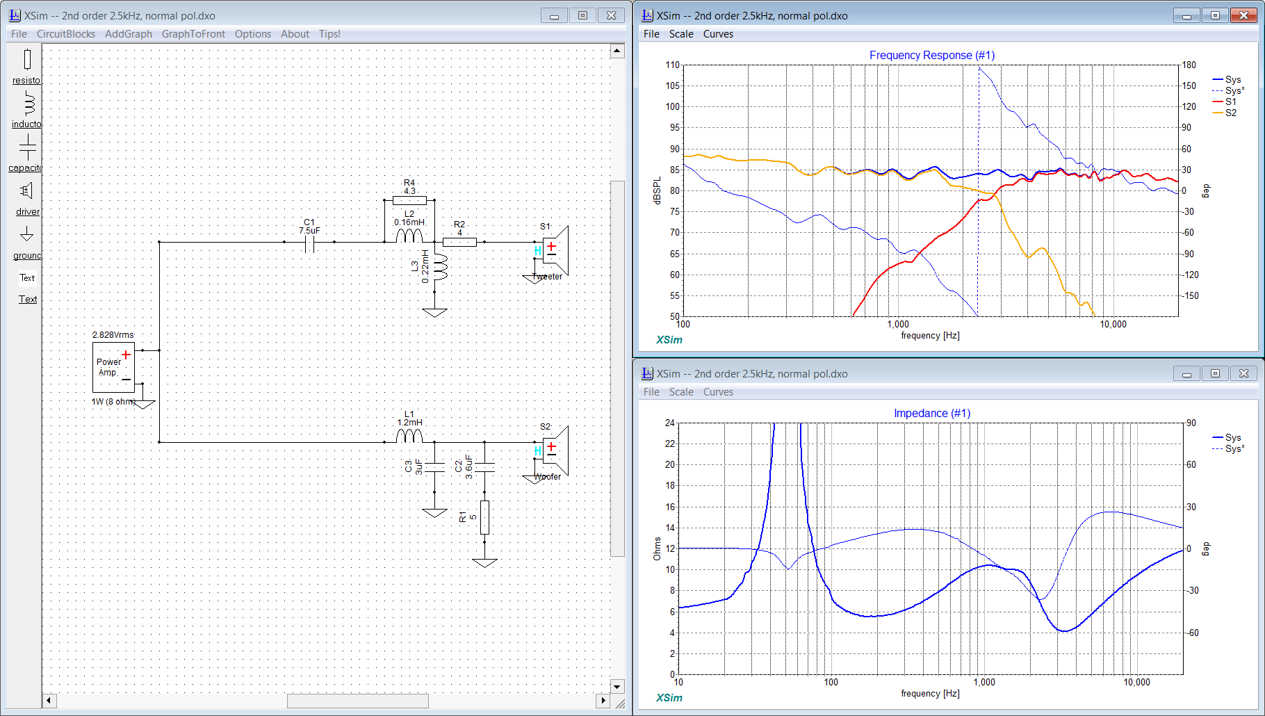

I experimented a little with 2nd order (electrical) XOs around 2.5 kHz with normal and inverted polarity on the woofer.
With inverted polarity on woofer:
With normal polarity on woofer:
I prefer the one with inverted polarity on woofer (only first order electrical XO), better phase + less components + smaller inductor on woofer.
The one with normal polarity suppresses woofer breakup better and also protects tweeter better.
Both leave room for a baffle step around 400 Hz.
The resistors take some heat in both designs (more power than tweeter), but I guess that's fine.
/Anton

I thought there was something wrong with the sim... indeed it would have been a magical driver! I had some wrong parameters in there... fixed and this is more like I thought it would perform...
Might be a good candidate for sealed with 8 or 10" subwoofers providing the grunty end.
