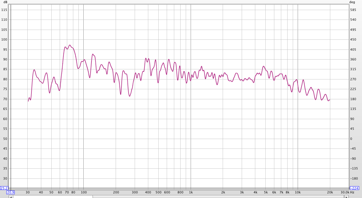

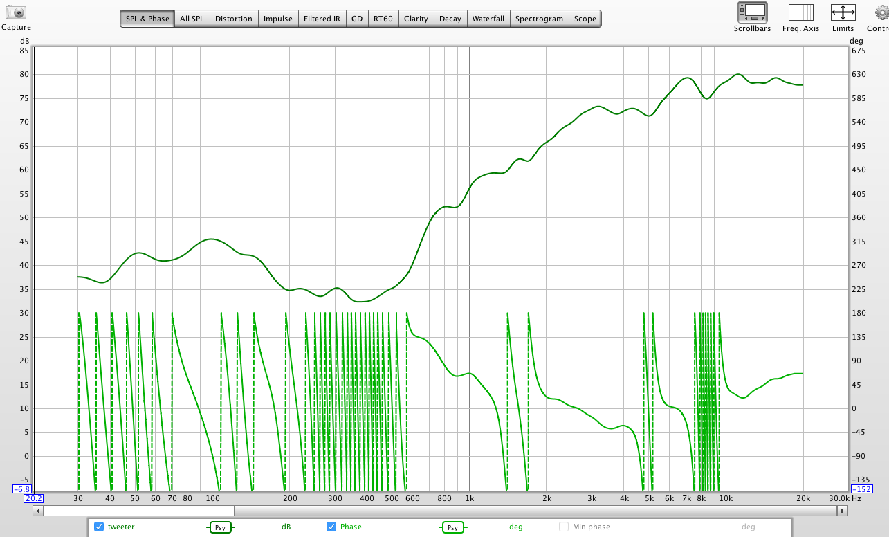

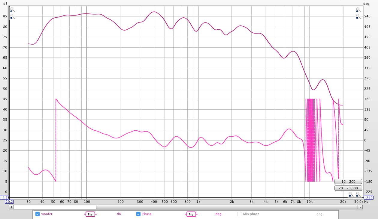

And some measurements...

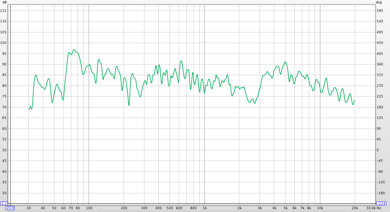

Found the sibilance culprit... the tweeter has a peak at 5kHz.
I changed some parts in the XO and it got a little better. I'll need to consider adding a small notch at 5kHz.
The green (first XO) and red (new XO) lines are at listening position, close to 2m away.
The blue is taken at 50cm. There's some phasing issues around 8kHz.
The dip between 200 and 300 is room and speaker position related.

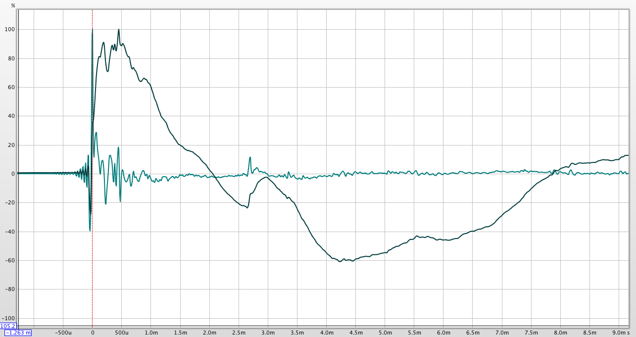

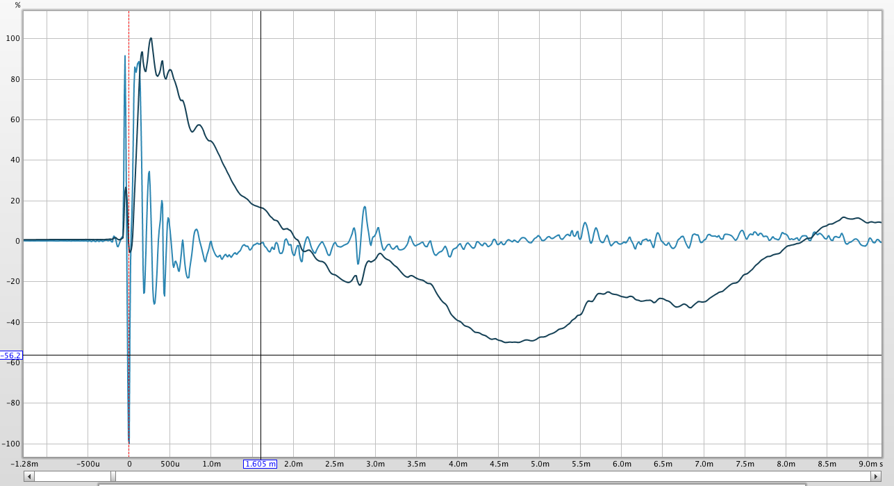

There is something peculiar with the impulse though. I'll have to investigate if the double peaks are between the woofer and tweeter, or if I was a bounce close to the speaker.

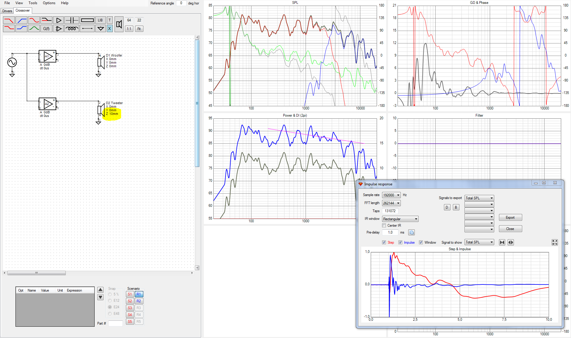

I think there might be a difference in acoustic center, even though the tweeter is placed at what seems to be the center of the woofer. Can you measure that? In Xsim I had to add a 0.65 inch delay on the woofer to get the measurements to correlate with the simulation.

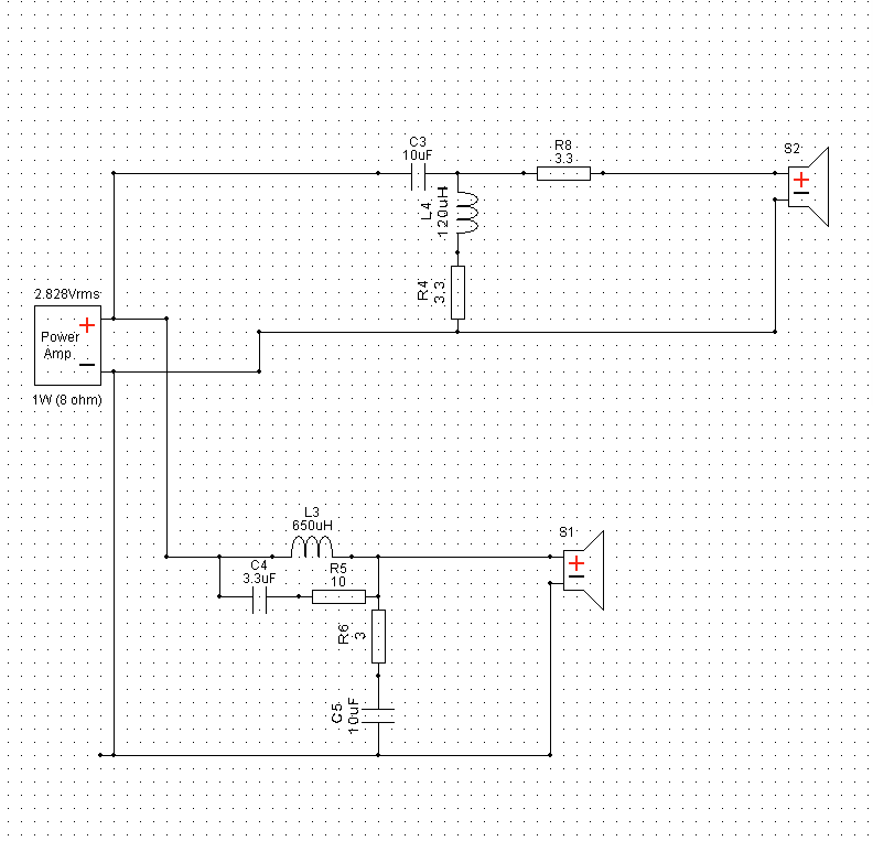

Can you show the tweeter and woofer traces together with the sum? And what is current XO?

I need to work on the sim because it does not follow too closely... especially when I invert the tweeter, which gives a much better FR. I tried playing with delay a little, but no luck.
I'll measure the woofer and tweeter separately next time.
In XSim, this is my XO:

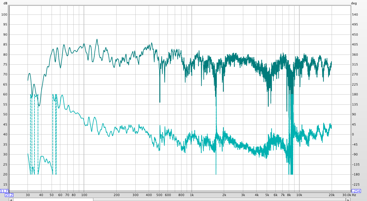

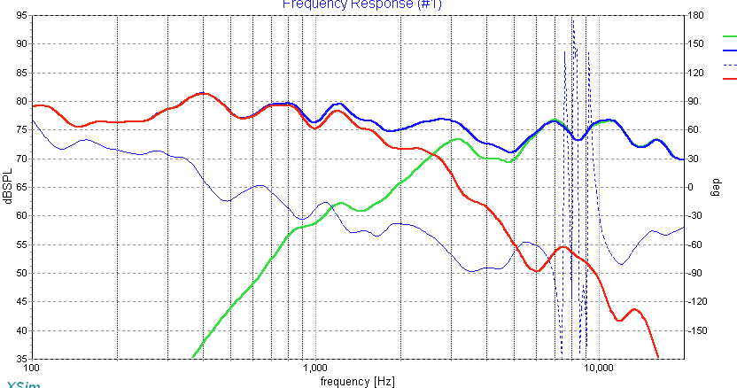

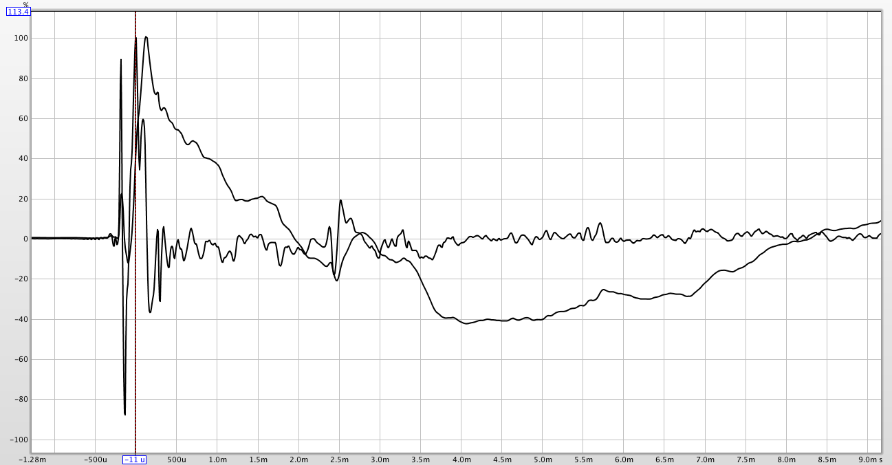

Busy day, but I took 10 min to do a quick sweep of the woofer, the tweeter and both, using the XO.
Impulse still is not clean, and I'm afraid that there can't be anything done about it, unless going active to adjust the delay between both.
Hi perceval looks like you try target a transient perfect step using normal polarity for both pass bands, if you want that feature slopes most be of 1st order or a complicated hybrid of B&O filler concept or Harsch, slopes you have now looks close to 2nd order LR and for that you need flip ones polarity and live with that phase turn, well its probably best or most correct flip tweeter if you want to integrate speaker with other systems such as a sub or AV system. Probably also you have some acoustic center mitchmatch else it would have looked worse than now when both are in same polarty, suggest you start find out that exactly number of acoustic center offset because it would help you use that number into design software for whatever slopes you try to target.
Okay it gives a dip with flipped polarity, then think that would indicate some acoustic offset is in place, with spaced apart summing drivers one can change design axis to counter for offset but will not work for coxials, looking at your IR/SR graphs it seems woofer is in front.
Will probably try trace your curves into VirtuixCAD and see what it comes up with in relative offset.

Okay it had a dip with same polarity as it should for 2nd order so you flipped tweeter around, no problem the little confusion and have a best Xmas plus busy work time 🙂
Loading your curves into VirtuixCAD it looks tweeter is in area somewhere 10-25mm (29-72uS) behind woofer, in below tweeter is set 10mm behind and IR/SR plus response summing starts to look as your live curves. DSP can cure that offset but also XSim has allpass networks baked into "CircuitBlocs" menu that probably should be able set a delay for woofer band but probably it gets expensive in components.
Hi perceval i had a recheck of slopes into Rephase using its compensate mode and actual it looks LP of woofer is close to a 4th order LR at 2400Hz and HP of tweeter is close to a 3rd order BW at 2800Hz, so the flip of polarity is probably what it needs to compensate acoustic center offset.
Summing those two slopes over in REW with one polarity flipped gives below summing with and without a 1mS offset.

I just tried adding an all pass 1 st order on the woofer, and it just crashed XSim.
I looked at the 2nd order.. and yes, a bit complicated and way too many parts to make it expensive. I actually like when there is not too many connections and parts between the amp and the sound heard.

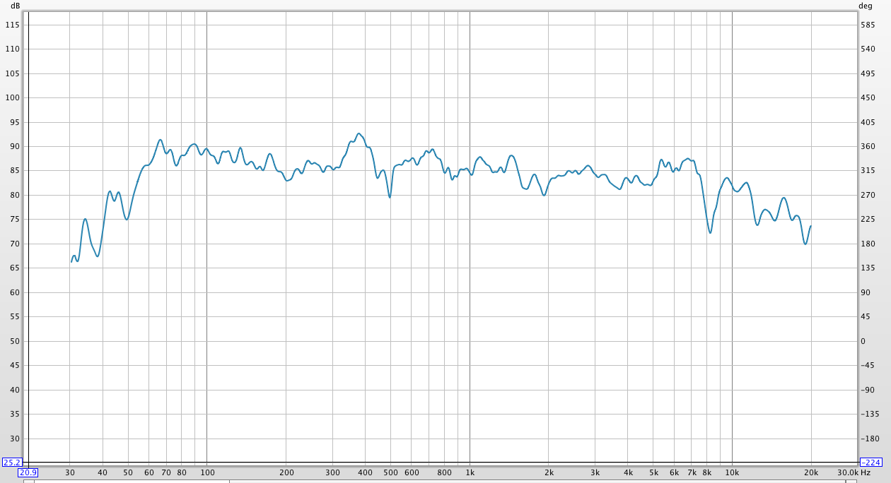

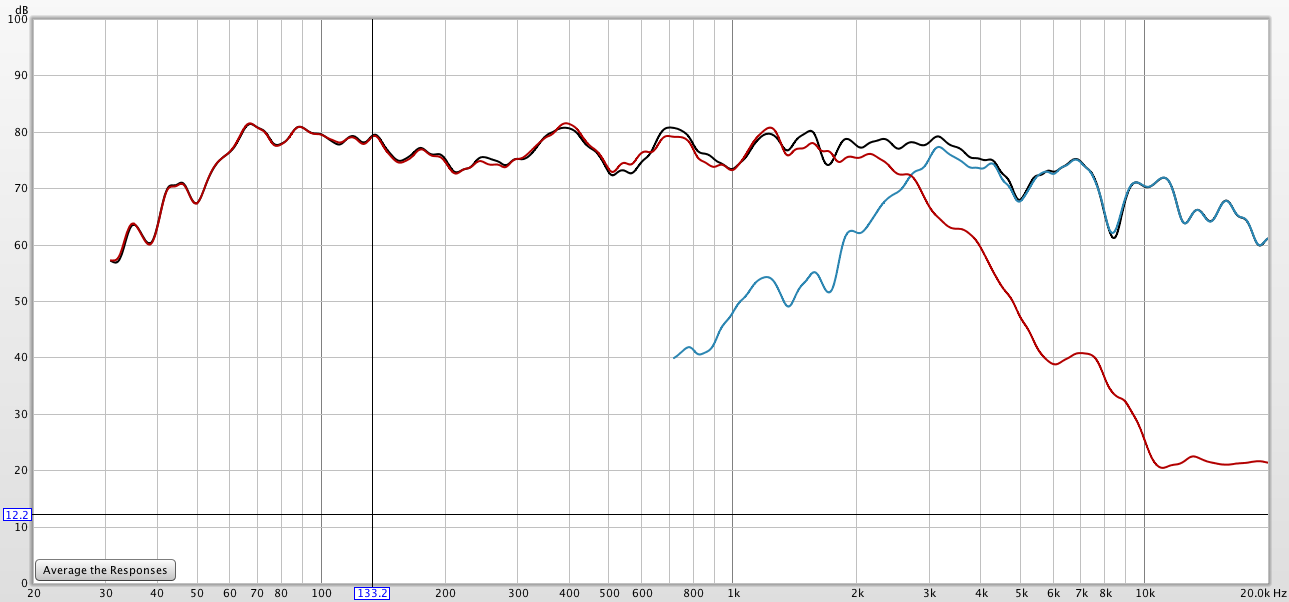

Progression.
I wasn't happy at all with the last XO. It just didn't sound right.
I simplified things and started cleaning it up.
Good step forward and finally starting to sound right.
Impulse has cleaned up, FR is reasonable and phase is behaved.
The XO point is much higher at 4.3kHz. I know it's a bit limit as the woofer is probably starting to beam a little. So, next step will be to measure on and off-axis.
For now, I'm pretty happy.
