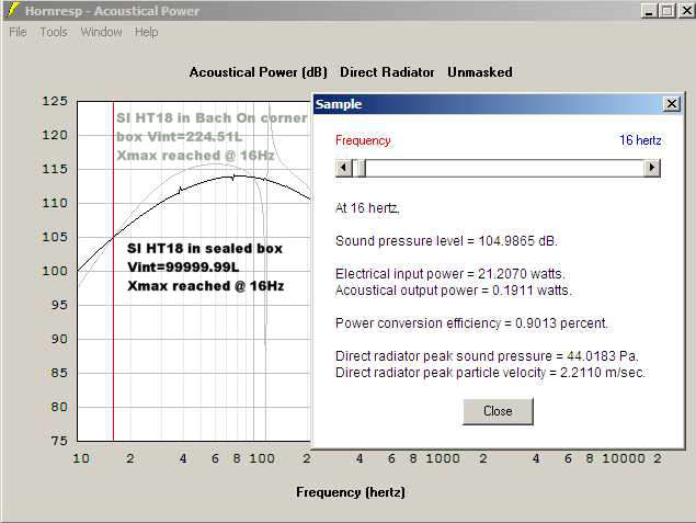

I disagree, many understands well the sims. Also many tend to like sealed boxes - but only if they are adequate for the job called. High output 16 Hz (organ) loudspeaker could not be sealed type, much better solution with much higher 16 Hz SPL is a vented box or back-loaded horn.
Simulations (and the theory) of loudspeakers are very well correlated with a real-world measured boxes. Simulations at default outputs maximum flat, minimum F3 designs, with adequate box volume (which might seem low in volume, for someone). But you can input in the sims different box volumes, to see that bigger sealed box volume increase F3, but decrease F10 (for example). But, and this is VERY important, maximum SPL at 16 Hz from that bigger volume sealed box is well under maximum SPL from a good vented or back-loaded (or tapped) horn. By the way, the same came from every good or crappy simulation software I tried so far. Theory says the same, as well.
Big sealed box is not the right solution for a high output organ speaker at 16 Hz. Maximum SPL at 16 Hz with the bigger sealed box will be slightly higher than a maximum flat minimum F3 sealed design, but not enough! Sealed box with infinitely big volume always will output much lower maximum SPL at 16 Hz than a good vented box or back-loaded horn.

Raw SPL data (no filters) from Hornresp SI HT18 @ Xmax in T-TQWT#2 (low end high end power peaks):
17Hz 650W 3.53 Ohms
72Hz 647.8W 3.56 Ohms
This matches up well w/ the drivers Prms=600W, which should mean that this driver will not be stressed w/ sound bursts @ the above level. The Crown XLS1500 should have an easy time driving this in the bridged configuration, and should be on the weak side in the standard dual channel configuration.

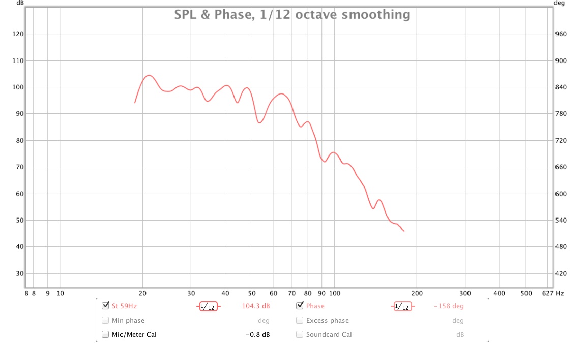

This all very much depends on how loud will you really be playing this box? If the organ amps Post #70: "...almost no organ amps provide output much over 100 watts." then I wouldn't worry about this at all, as you'll never get anywhere close to the power needed for Xmax.
This subwoofer system is easily of similar efficiency in the sub 30Hz range as any of the professional bass-reflex and passive radiator designs that have been mentioned here and in the other thread, I would not be surprised to find that it equals or outperforms even the four passive radiator/single driver version.
There is one fly in the ointment though, what are the actual T/S (Thiel/Small) parameters of your driver. Sooner or later that needs to be measured, otherwise the simulations may or may not be correct.

The original mistake was people going to their favourite sim and their sim commanding them to build an enclosure that is flat to 16 Hz.... as Sonce explains above in sort of answering my question.
What people should have done is gone to their sim to figure out how to get a real big whomp at 16 Hz or thereabouts. Nothing wrong with sim math, if you ask it the right question.
And just to defend such sims further, issue is (1) the opaque nature of sim assumptions that people rarely re-examine and (2) the inability of people to understand how to translate their personal taste, as Bach On says, to physical parameters so as to read sims beneficially.

According to Hornresp this latest attempt provides 115.66db @ 16Hz in a 2xPi environment @ 1m. There'll be a bit of a peak (117.91dB @ 18Hz) if the box is used w/o any fiber fill, again in 2xPi. Add 6dB for 1xPi which is probably what you are looking @ in the chamber. I think you'll be fine.
One of the neat features of this type of enclosures is the tuning capability through simple mechanical means, primarily fiber fill, but also duct length and mouth (terminus, port, opening) size.
My gut feel is that you have adequate bass w/ the two vented boxes, and that you will not need the full output of your Crown XLS1500.

Ben,
A couple of the guys over at the organ forum like sealed boxes - and the bigger the better. They view sims with considerable suspicion and refer to them as voodoo. Ported boxes and horns are voodoo designs to them. Experience tells them big sealed boxes are winners. Everything else is suspect. There are some people who believe sims are the answer to everything. I view them as a potentially helpful tool for estimating what we might expect.
I think our organ is going to have a specialized need. And the printouts from the sims Oliver has posted seem to indicate the design he has posted would POSSIBLY fill that need. I really don't care what it is called. I can't even keep all the various kinds of horns straight in my head. But if it will fill the need we have, I'm willing to give it consideration.
I've tried sealing the ports on my ported bass boxes for comparison. There were still some leaks. So they were essentially leaky sealed boxes. They were unable to do 16 Hz. with anything approaching authority. So that solution didn't work for me. I'm not saying it can't be done. I just didn't obtain the results we needed. So I went back to the ported boxes.
Oliver's design seems to offer a reasonably flat frequency curve from 90 to 20 Hz. That sounds like a good thing. I don't see the advantage of a box that is virtually silent until we hit 16 Hz. when it suddenly pipes up, if that's what you were suggesting.

Hi Bach On,
Post #88: "...A couple of the guys over at the organ forum like sealed boxes - and the bigger the better. They view sims with considerable suspicion and refer to them as voodoo...."
Anybody who has build, and compared the same driver in different enclosures will confirm that there is no voodoo to the differences between enclosure types, and that a properly designed vented box will have a higher output @ the bottom of the frequency range than a properly designed sealed box.
Assuming proper construction techniques, the biggest problems w/ vented boxes are: wrong tuning frequency, insufficient duct size and lack of an appropriate low cut (or high pass) filter. For a subwoofer that is supposed to cleanly reproduce 16Hz the low cuts build into the signal chain will probably already take care of the third of these points, but it still has to be addressed.
For anyone who wants to mess around w/ this I'll attach two Hornresp simulations, one of the SI HT18 in a 99999.99L sealed box (Hornresp Vint_max), and the other w/ the SI HT18 in the Bach On triangular corner box sealed. I'm also attaching a Hornresp graph showing both of those boxes @ Xmax. In practice (?) they would still need a low cut filter, as the the excursion is still increasing beyond Xmax below 16Hz.
15 Hz driver resonance, as per Mark's post. Bingo!
But tb46's drawing from HR doesn't match my idea of an infinite baffle response of a driver with a 15 Hz resonance. Can you please explain that to me in simple language.
Just for fun (and I mean that), here's a mic trace from sitting position of a 1960 15-inch, 21 Hz resonance driver on a large open board. Is this nice? OK... I know Just a Guy loves to learn about old equipment.
Ben
Ben,Buy tb46's drawing from HR doesn't match my idea of an infinite baffle response of a driver with a 15 Hz resonance. Can you please explain that to me in simple language.
In simple language, it appears your idea of an infinite baffle response of a driver with a 15 Hz resonance differs from the Hornresp simulation because your "idea" does not use the same math that Hornresp does.
Having found Hornresp simulations match measured response quite well, it would appear to me that the math used by Hornresp is correct, while your idea (whatever it is) may not be.
Repeatedly showing the equalized, uncalibrated small room response of your old AR LF OB doesn't help us understand why your ideas differ from what a Hornresp simulation would indicate.
Art
Since I'm the one that originally recommended this driver on a price/performance basis I'll comment quickly.
Yes, they are suspect. All SI product specs are suspect. Especially the xmax spec. Often, SI will pull Klippel numbers on a prototype version and publish them, then make changes and have a different production version and never change the published specs. Sometimes he will even take the Klippel numbers, add a bunch of mm of xmax based on how he thinks the production version will measure and publish THAT as his xmax spec. I have proof in links if you want it.
Also, when quoting xmax he ONLY considers the Bl graph, ignoring all the other limits that would give a far lower xmax, like Le, suspension nonlinearity, etc. I also have links that show his SI 24 is limited by Le to 20 mm xmax and yet he published a spec of 36 mm for that driver.
The SI 18 D2 and D4 versions have very noticably different specs and will give different response in the same box, although I believe only the D2 version specs are published. And your guess is as good as mine as to how accurate these are. I certainly wouldn't trust them.
Here's a little gem from a recent conversation about the accuracy of his specs. It's from here - SI HT24 sealed test results - Page 6 - AVS Forum | Home Theater Discussions And Reviews
Electrodynamic is SI, and he doesn't care in the least about providing accurate specs, as this image clearly shows.
I've been speaking out about SI's aggressive marketing and bad attitude and outrageously incorrect published specs for a couple of years now, he is a blight on the industry if you are interested in manufacturers publishing accurate specs.
Furthermore, this particular driver, along with all the other drivers that suffer the "high inductance" effect ABSOLUTELY WILL NOT perform as simulated unless you account for it in the sim, which no one ever does. (I put "high inductance" in quotes because as Kravchenko pointed out, it may not necessarily be the inductance that causes this effect in these massive coil/motor designs.) I have a method to simulate these drivers accurately but no one uses it. My sims are always accurate.
So why did I recommend this driver? Very simply, it performs. Third party measurements have shown that it's the value leader.
But it absolutely must be simulated properly or you will end up with a mystery response similar to the massive RE XXX ported build on data-bass that tb46 has mentioned a few times. It's measured response is not even close to what a simple sim would suggest. But I can sim it pretty accurately.
JAG,
So the SI HT18 can be simulated, but only by using unpublished variables that need to be included in the calculations.
How were/are these variables determined? And what are the accurate T/S parameters for the HT18?
I guess many companies are guilty of providing specs that make their products look better. I've always avoided Peavey products, for example, because I felt their stuff seldom met the published specs. They have a low cost 21 inch subwoofer driver at Parts Express right now that sounds good on paper. But I just don't trust the specs.
I'm curious as to what that "idea" is too, because Ben does not mention Qts, which will have a significant impact on the driver's response around its resonance frequency when used in an IB alignment.
Ben
In room measurements mean nothing to anyone who isn't in that room and sitting in the exact spot you placed the mic.
I've offered to sim your antique 2 mm xmax woofer in OB several times so you can see how it compares to other designs, you've never taken me up on the offer.
What I can tell you for sure is that the in room response measurements of your various speakers that you have posted is nowhere near typical. So either you are measuring in a very bassy spot in the room, or you are using eq, or you are in a concrete bunker (small apt construction), or your measurement gear isn't calibrated, or any number of a dozen other things. Your AR speaker measured about the same IIRC, and isn't it a ported design with a port tune well above 20 hz? In typical rooms with no eq neither of these speakers will measure anything like what you've shown.
Now concerning this speaker specifically, OB doesn't have room gain per se, but if I understand it correctly it's not really pure OB, as there's a cavity resonance between the large board and the wall and other details of this "subwoofer's" construction are sketchy at best. Regardless, there's resonances going on in the speaker itself, between the OB and the wall, and room resonances as well.
Art also points out that this measurement may have eq applied, which makes the measurement absolutely useless for anyone except you and even then it's only useful with the same eq settings and in the spot the measurement mic was placed.
As usual, the situation is nowhere near as simplistic as you try to make it seem.
If you would like IB response explained, with qts driver details and how this affects overall system q, I can do that. But for now, here's a quick example. This is the IB response of a driver with different qts values. No other parameter is changed, just qts. Therefore it isn't a real world example but it does show how qts alone affects IB response. This is 2 pi response, not in room response.
If the numbers are too small to see, this is shown at .25, .5, 1 and 2 qts. As you can see, large sealed boxes are not a good idea for drivers with qts higher than .5 or so if flat in room response is desired, as the room will boost the lower frequencies. When qts gets to 1 or higher, a sealed box is a bad idea with almost no exception (unless you want a humped response at fs), even with very large sealed boxes the overall system q is going to be very high.

Most of the very large coil/motor drivers can not be accurately simulated with a simple sim with the exception of a very few examples that are very expensive like TC Sounds drivers. This is easily seen when simulating any drivers of this type and comparing to measurements on data-bass.com. He gives measured t/s parameters as well as details of the box he used to measure the drivers. None of the sims will match measurements with this type of very large coil/motor drivers, although TC Sounds does a lot better than most.
The sim can be made more accurate by adjusting t/s parameters (although you need accurate t/s parameters in the first place). Adding a bit of Re to the sim and adjusting power to compensate for the added Re losses gives a much more accurate indication of what the frequency response will look like (although it does make some of the other graphs less accurate due to having to input more power than will actually be used). Another guy that has played with my tweak has also noted that decreasing Bl will also do much the same thing, and in that case you don't have to adjust power level, so all the other graphs will also be accurate.
I've discussed this tweak quite a bit since last October, very few people have taken notice, but a couple of key players on avsforum have endorsed this tweak, in fact Josh Ricci (the guy that runs data-bass.com) mentioned that he did something very similar to make his sims more accurate.
I've got dozens of measurements taken by data-bass.com compared to sims in all different types of enclosures with a variety of different drivers. Sealed, ported, tapped horn, front loaded horn, this tweak works every time in every enclosure with every large motor/coil driver using nothing more than published t/s specs (assuming they are accurate).
It can be as simple as applying exactly the same amount of Re (or decreased Bl) to every large motor/coil sim or you can adjust for best match compared to Ricci's measurements to get more accuracy but this will obviously take longer.
The tweak is not 100 percent accurate but it is exponentially more accurate than a simple sim for this type of driver.
If you want to know more I can dig up links or you can ask specific questions. TB46 is aware of this tweak but I don't think he used it in your sim.
Like Art, I too get all choked up with strong emotions and post factless criticism.Ben,
Art
I have no issues with HR or statistics.... but as Mark Twain famously said about stats not lying....
No Art, AR did not make 15 inch woofers. Were'd you ever hear of that? Emotions just got the better of ya judgment? Not previously posted, I think, but thanks for thinking of me.
I guess I need to explain my point of view to Art: a driver with a resonance at 15 Hz ought to show a clear whomp-up at 15 Hz in a near-infinite baffle, as tb46 says he sim'ed. As my posted data (with no EQ to speak of, no moveable mic position, too small for LF waves, and definitely no such thing as "cabin gain") clearly shows.
At the risk of boring everybody be repeating the obvious (that still seems to be missed), I believe Bach On would benefit from a "house curve" with a big whomp-up around 16 Hz (and starting with a 15 Hz driver seems pretty nice). Beats me why some people are persevering in modeling flat response* just because their sim marches them in that direction.
A ported box or TL might be dandy - just so long at the house curve is the end result.
Ben
