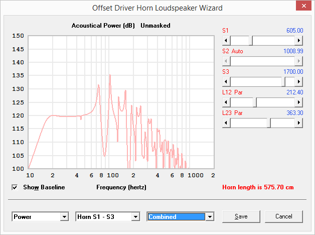

There's another design I hadn't considered - an OD-TL - a TL with the driver offset in the box. It's a bit more difficult to build, but it does address the first "notch" in the response that's characteristic of TLs (and vented boxes with large vents).
....and here we go. As you can see, the notch has moved up a bit higher in frequency (which means that you have a wider passband to work with). The size is the same as the TL I provided earlier. The difficulty here is coming up with an actual folded layout that places in the driver in the right position in the OD-TL.

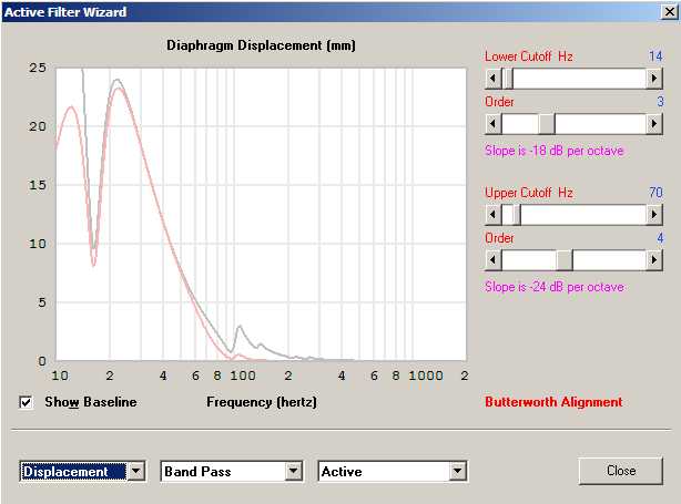

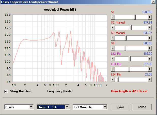

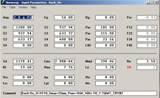

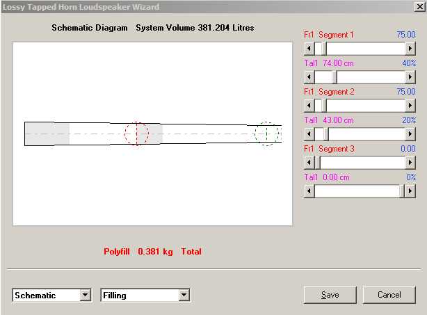

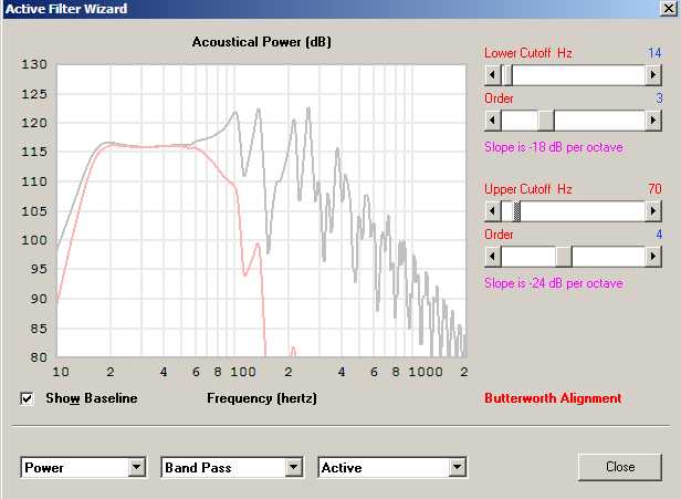

T-TQWT Example #2
Hi Bach On,
Here is a second example for the T-TQWT using the SI HT18. Here the drawing reflects the simulation very closely. You'll notice that the fold is slightly different, and that there is still a bit of wasted volume, but not much. Maybe a good place for the input connector or a build-in amplifier? I tried to optimize this one for SPL @ the bottom end with minimal (or no) internal fiberfill. The same basic enclosure would also work w/ two ea. JBL GTO1214 wich is a bargain driver I have mentioned before (see: the Kraken 212 TH).
Your problem is that you want full output @ 16Hz. But you know that already. 🙂 Horns and TH will get to be very big.
16Hz is not only hard to hear, it is also hard to measure. If a microphone has not been calibrated for that frequency range, and if the loudspeaker is not in a true free field the measurements will reflect the microphone nonlinearities and the room. When you pipe a constant sine wave into a large room you can literally walk around and find the nodes and antinodes. I have mentioned this before, I prefer 1/3 octave warble tones, that averages things out a bit.
Hi Bach On,

One thing I keep seeing with the Ht18 driver is a simulation stopping at 24 to 25mm excursion. The driver has another 18mm mechanical before you run out of suspension.
Yes the distortion will go up. But only on occasion of requiring that amount of output.
So you have a bit more headroom with your design.
