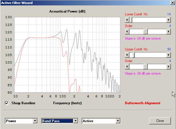

I posted the original message about the recordings rather quickly. Thus, I didn't provide much background, Our weather turned around here big-time about two weeks ago. Suddenly the pipes went out of tune. The digitals did not. So the organ is out of tune. It is far worse in the 4 foot voices. So the registration I used on those recordings had no 4 foot voices except for a light 4 foot Flute in the Pedals. We should get a tuning in a couple of weeks. Maybe then I can provide some updated recordings.
One thing I will point out. In the recording, sometimes the 2 2/3 Nazard sounds rather nasal. The odd thing is that I don't hear that nasal quality live. These mikes don't usually color sounds. But they - like me - are getting long in the tooth.
I'd be interested in hearing opinions and constructive criticism. Men often experience some hearing loss - especially in the higher frequencies. I'd be interested in hearing if YOU felt the 2 foot and the 2 2/3 voices were too loud in comparison with the 8 foot voices.
Let me say that the 16 foot pedal stop I used is a quiet one. I do have louder ones from which I can use.

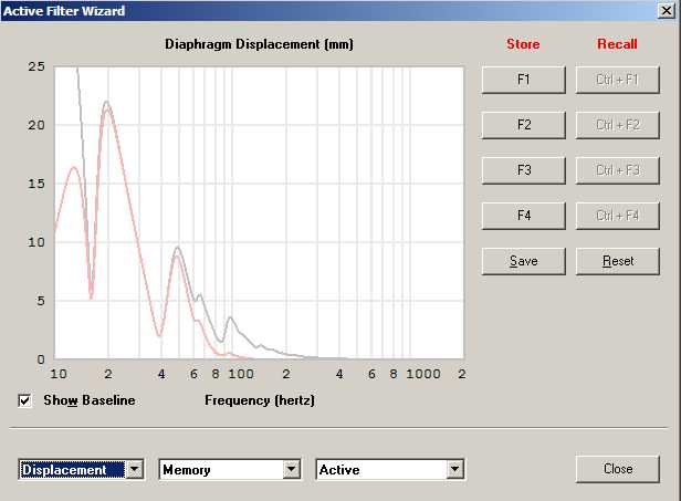

Those REW graphs are interesting.
The recording was made in this fashion. I placed two vintage Sure KSM27 mikes on mike booms about 20 feet away from the pipe/speaker chamber opening. I used a Behringer preamp to provide 48 volts of Phantom Power for the mikes. It was then plugged into a Tascam CD Player/Recorder. I then converted the digital tracks to MP3 format using the highest sampling rate I could find. But I can hear that there is some decline in the quality of the recording after conversion.
One thing I will note is that the air conditioner was running. I ran it to cool the building from about 80 degrees to 74. So it ran right much. That low rumble might be the source of any signals way down low. Too, there was some outside traffic.
As for registration. The Swell manual had an 8 foot Flute, an 8 Flute Celeste and a 2 2/3 Nazard. The Great manual had only an 8 foot Flute and a 2 foot Spitzflute. The Pedals had a 16 foot Liebleck Gedact, an 8 foot Flute and a 4 foot Flute. So there was no organ stop providing anything lower than 32 Hertz.
I've worked pretty hard for the past several months to get the voicing right. That consists of trying to get all the notes of one stop to match the others in Sound Pressure Loudness. I cannot change the loudness of the pipes. So I let them set the standard. The Artisan digital system allows the digital voices AND each note of the voices to be adjusted.
It isn't flawless, but it is much closer to sounding like a real pipe organ. Remember - there are no pipes other than 8 foot and 4 foot. Everything else is digital.
I have experimented trying to program a 32 foot stop in the pedals. The speaker system can do it. But it is not loud. And it causes lots of sympathetic vibration of the pipes in the chamber and in the Sanctuary. So - I've put off trying to use 32 foot stops for the time being.
Anyway, I wanted to share with you by way of saying thanks.

Your voicing is pretty even. A good old American/British sound from the turn of the last century. Nice and polite.
The Gedackt in the Trio sonata was spot on for a small organ. Wished for a little reed in the Fugue. A nice registration transition from the softer divisions onto something with a little teeth would have been neet to hear. But that from a guy that really likes the German and French big ol organs. But I have to say that my favorite BWV 565 is on a small organ in a small church with a great 8 foot trumpet on the great division and a nice raspy Posaune in the pedal division.
I think that organ has 28 stops if I remember correctly.
I had a little difficulty at times figuring out which stops were digital and which were real. I think that means you have done an awesome job in blending them in.
What I heard quite quickly in the Trio sonata was the distortion in the lowest notes of the the pedal part. They are well presented. Just that I can hear the difference between a real pipe and a reproduced one due to the difference in the harmonics presented. I literally mean the higher frequencies that were added in due to woofer adding in a little distortion.
High frequency. Nothing to harsh sounding to me. My hearing is good o 15 300 hertz. Nuttin after that.

Thanks for the detailed input. You may or may not recall that we had to remove our 16 foot Bourdon pipes to allow sound from our speaker chamber to enter the pipe chamber.
Only the 8 foot and 4 foot flutes in the pedal division includes pipes. The current speaker system for the Pedals consists of the following:

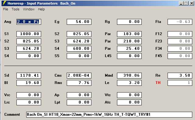

12 cu. ft. cabinet with 2 15 inch Dayton Speakers. I had a port on this cabinet. But I have closed that port for now.
10 cu. ft. triangular ported cabinet with 18 inch Stereo Integrity driver.
