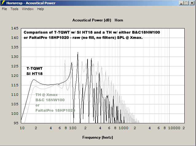

Hi Mark and All,
I had another day from h..., what got me thinking that it would be a good idea to get into the house rental business so I'd have something for retirement (10 more month - 10 more month...)?
Looking at the drivers from Post #58: "... B&C 18NW100 or a FaitalPro 18HP1020."
They indeed make fine THs that can be forced into the sub 20Hz range (using the same TH geometry the SPLs are almost identical). Still, they cannot outperform the SI 18HT T-TQWT from Post #39, and they are larger. It looks like in this frequency range there is no substitue for shear brute force displacement. I'm attaching the Hornresp Export files for the THs (just the driver parameters change) and for the T-TQWT #2B (w/ Eg reduced so the driver does not exceed Xmax in the passband in the raw Hornresp SPL window (no filling, no filters.)).
All this makes me even more convinced, that the T-TQWT is the right enclosure for this job. And, as always, need it louder, get more boxes. 🙂
Hope I didn't make too many mistakes, it was a hard day.
P.S.: Hornresp provides the functionality to increase box size to resemble very large sealed enclosures, being close to so called infinite baffles. Also, data-bass.com has very interesting data on "Room Gain", "Cabin Gain" and "Sealed vs Bass Reflex vs Tapped Horn" in their Articles section, as well as interesting SPL data in their Systems section (this data is 4xPi, add 6dB for 2xPi - in the table click on the 16Hz column to sort the data for 16hz).

That response curve looks great in the area in which I suspect we might need just a bit more. Things do fall off below 20 Hz. But the SPL - if the sim is accurate - is still above my existing boxes. And the size of the cabinet is a nominal 20" W x 27.5 D x 60" H. That comes out just a bit short of 19 cu. ft. Big - but maybe not too big.
I'm curious, what kind of amp power is needed for this setup? AND can the gain on the amp be used to lower the SPL while still getting this kind of response curve - just at a slightly lower consistent SPL?

Hi Bach On,
Post #70: "...what kind of amp power is needed for this setup? AND can the gain on the amp be used to lower the SPL while still getting this kind of response curve..."
The second part first: yes, the amplifier gain shifts the curve up and down without altering the curve shape as long as you are not exceeding the ~ linear range of the driver (~ Xmax) or the amplifier (~ Prms rating).
The first part of the question is a bit more difficult, as it depends on the HP/LP (high pass/low pass)filters used w/ the amplifer speaker system. The professionals on this forum recommend to double the power needed by the speaker to come up w/ the amplifier power.
Raw SPL data (no filters) from Hornresp SI HT18 @ Xmax in T-TQWT#2 (low end high end power peaks):
17Hz 650W 3.53 Ohms
72Hz 647.8W 3.56 Ohms
This matches up well w/ the drivers Prms=600W, which should mean that this driver will not be stressed w/ sound bursts @ the above level. The Crown XLS1500 should have an easy time driving this in the bridged configuration, and should be on the weak side in the standard dual channel configuration.
