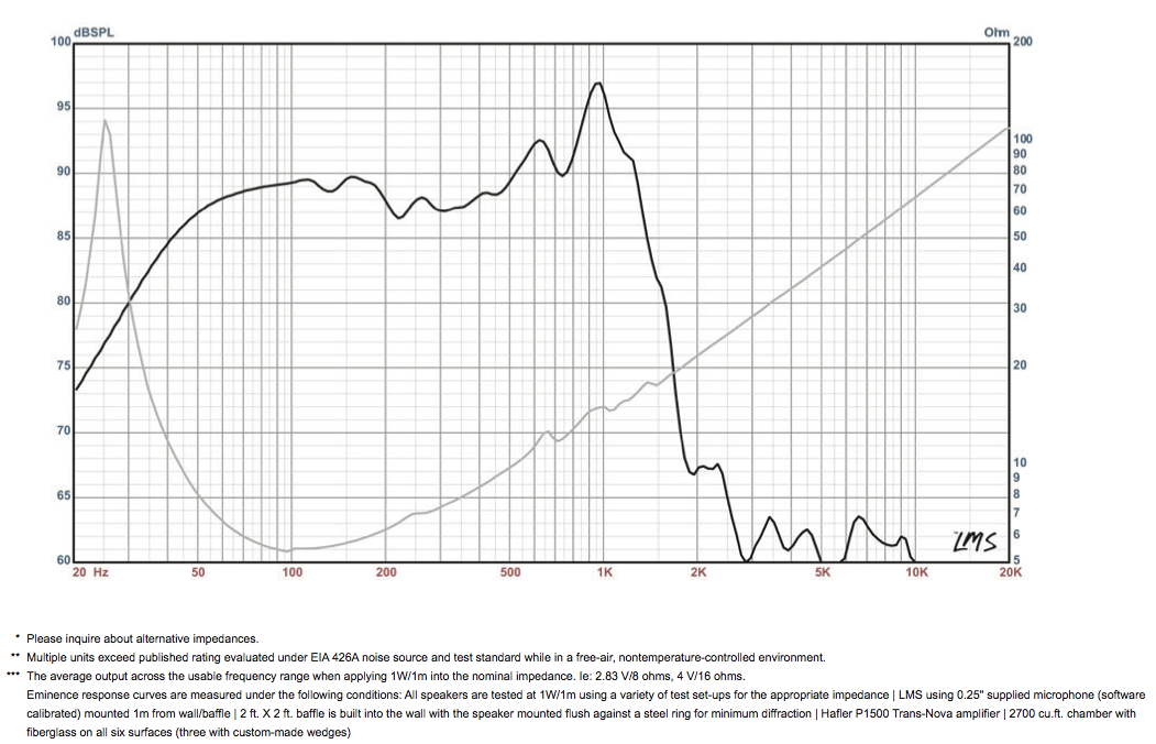

Just as one example below you can see the response of an Eminence Lab 12, 22 Hz fs, there is no "whomp-up at free air resonance", just the usual low frequency fall off one expects to see in an infinite baffle.
At any rate, Bach On (like almost all those looking to achieve high SPL LF in large rooms) has already decided the drooping LF of a sealed cabinet won't get the job done.
