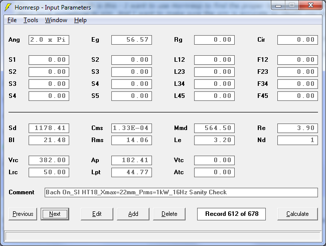

Yup, that's a start. I would like actual dimensions so I could sim it as offset mltl (as the height is probably enough to affect the 1/4 waves within the passband) but this is fine for now and at least gives me a chance to practice with Hornresp filter settings.
I prefer to use the data-bass measured t/s for simulating the SI 18 in lieu of t/s directly measured by OP.
I did not include any inductance effects in this sim, I would do so in a more final version when recommending exact filter settings, this as I said is just for practice.

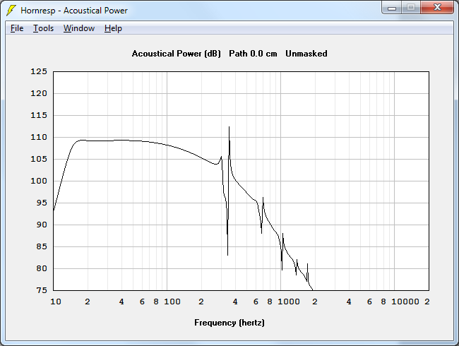

All I wanted to do here is get some filter settings so the driver wouldn't go past xmax below tuning with this sim, and keep the frequency response pretty much the same as unfiltered.
Left column shows Hornresp inputs, frequency response and excursion of this design with no filters.
Right column shows I applied a 20 hz 2nd order LR as a first step. Then in the filter wizard I added a 21 hz low shelf with q = .68 and gain = 5.9. I also threw in a 20 hz parametric eq boost with q = 1.6 and gain = 2.5.
The result is frequency response almost identical to the unfiltered response and the filtered design never exceeds xmax below tuning.
Easy as pie. And all done without using any settings below 20 hz, so Inuke friendly.
