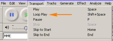

Sorry Zero D. My mistake.
1. I have downloaded and installed Audacity.
2. I have downloaded your wave file.
3. Audacity loaded and ran it even without my having to rename the extension.
4. I exported it as an audio file so it would have the correct extension..
You're right. It goes by pretty fast.
My laptop speakers could do nothing with it. I'll putz around with it and see what I can do.
Once I have it, can I copy and paste in Audacity to make it longer?

@ Fred, i mean Bach On 😀
I mentioned it would 😉 & about renaming the file from .txt -> .wav
I'm not surprised 😀 & careful with the volume on ANY other speaker
As i said before, you NEED to Loop it See my image of how to in Audacity 😉

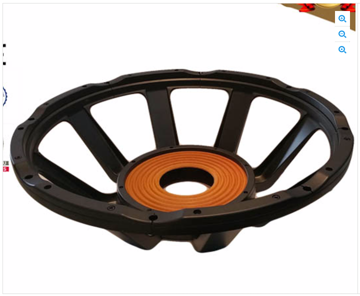

The limits of human hearing is 20HZ to 20KHZ so what advantage is there trying to produce sound outside this range?View attachment 540526
It all starts with this.
And from there Magnets.
Lots of magnets.
Seeing as they are worth a small fortune each even at my cost.
But yes this size of driver is indeed manufacturable.
All it takes is money.
