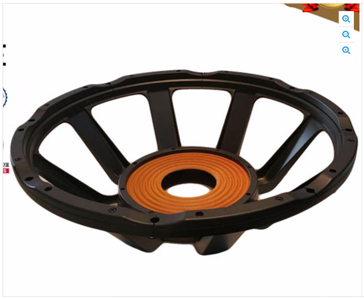

Neither of these drivers are that special. A couple of top tier high excursion 18's will do the same job as a single 21.
Mach 5 Audio is releasing a 32 inch driver soon if large cones are what get you excited. It's not going to be cheap. It's very likely going to end up similar to the model in the video below, at least in looks, as they will probably need to use some of the same parts. VC and motor will probably be different but a lot of the other parts will probably be the same as this one.

It all starts with this.
And from there Magnets.
Lots of magnets.
Seeing as they are worth a small fortune each even at my cost.
But yes this size of driver is indeed manufacturable.
All it takes is money.
Yes, most of the parts are right off the shelf from China. If they weren't this product wouldn't be available at a reasonable price. I assume Mark is going to make his own voice coils and motor but most of the other parts will be right off the shelf. I think he's going to do both a neo and a ferrite version.
Well the pic I posted is indeed the 32 inch basket.
I keep tabs on stuff like this.
As for off the shelf.
There are few motor parts available that support a decent coil size for a cone this large.
I would use an 8 inch coil.
Access to the high temp wire and adhesive is prohibitive as is the proper formers.
I get my coils wound by Precision Econowind or PoYun. ( Which owns Precision Econowind anyway)
As for off the shelf metal parts.
Not a chance. That is a custom turning if there ever was one. Happily for me I know how to do that.
Magnets. I have a few companies that I deal with and they will make what I ask for. Have a few large NEO hockey pucks going right now in fact for another run of drivers.

As far as I know Mark machines his own motor parts, magnetizes his own magnets and winds his own coils (not really sure on the coils but I think he does it himself). He's shown pics of the process but I never really paid attention.
I'm pretty sure he has access to high temp wire and adhesives that he uses on his current product line, I don't think the new 32 is going to be thermally rated a lot higher than his current products.
That leaves the soft parts, coil former, spider, cone, surround. Those and the basket are all off the shelf parts I believe, as Mark can't make any of them himself.
