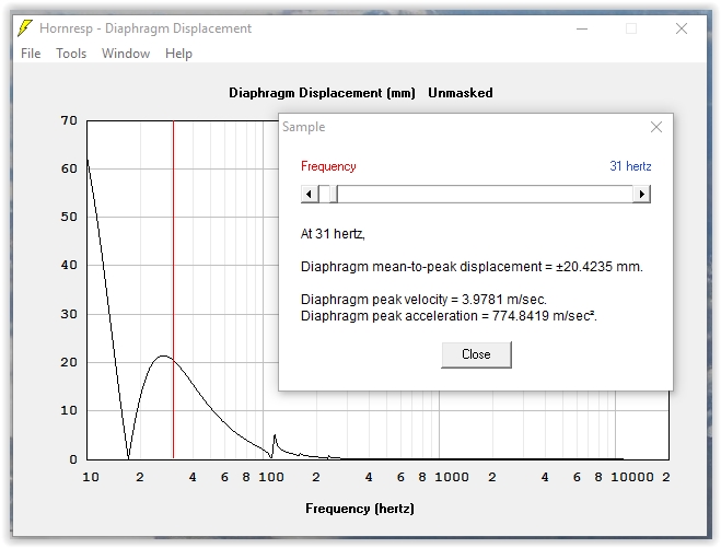

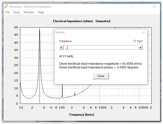

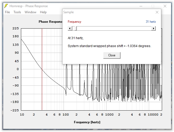

Especially the output loss below ~24Hz, and the bump @ ~32Hz that result from using the "Large Voice Coil" button are questionable, and can only be verified, or laid to rest with measurements.
Thanks for all that research. If OP can verify the height and internal volume of the box (not including port) and verify the cross sectional area and length of the port I have all I need.
You might be skeptical about the "Large Voice Coil" results and I admit they may not be perfectly accurate but I will bet money that they are more accurate than not using that option. For this driver and drivers of this type, anyway. My research speaks for itself, I think. There's plenty of sims compared to real world measurements in my research paper.
I agree that having measured t/s and frequency response measurements (at a minimum) would help a lot to get more accurate data to derive decisions on, but I seriously doubt OP is going to measure t/s or cart the box outside and measure FR in any meaningful way that could help us. So we do what we can do and make do. If there's any doubt I can specify a conservative hpf setting, but unless OP can get a boatload more power to the amp it's not really going to matter as he'll never get anywhere near needing it.
Even if you don't trust my large coil adjustment it doesn't make a whole lot of difference.

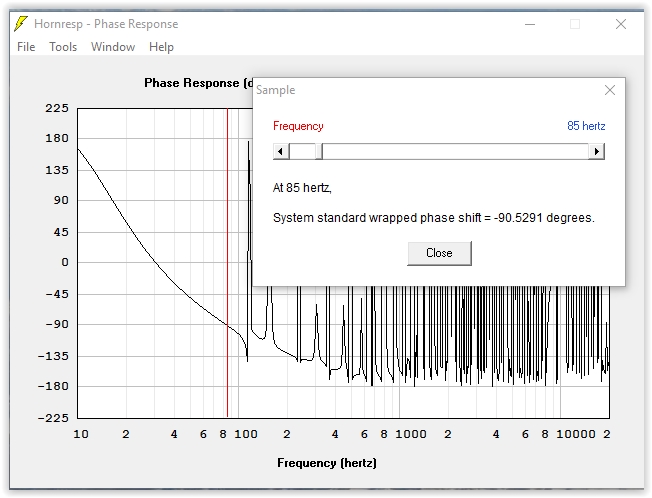

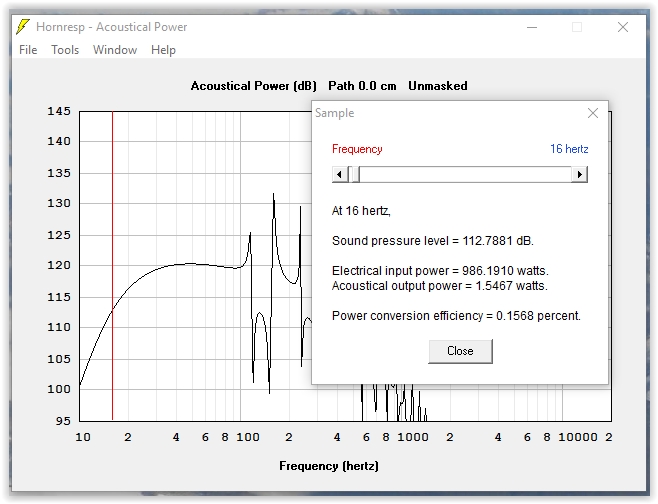

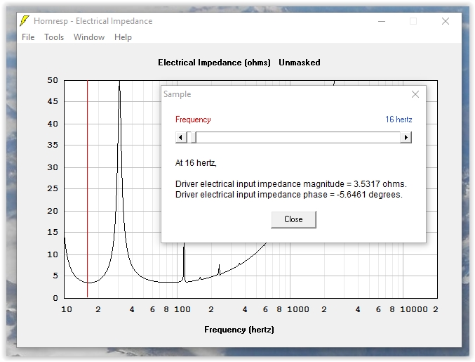

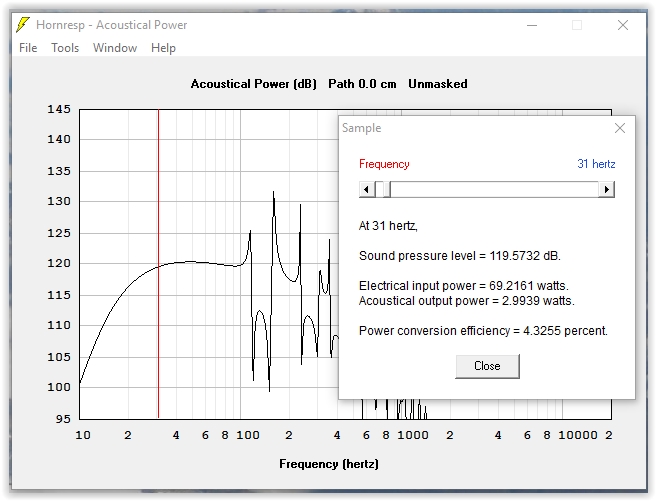

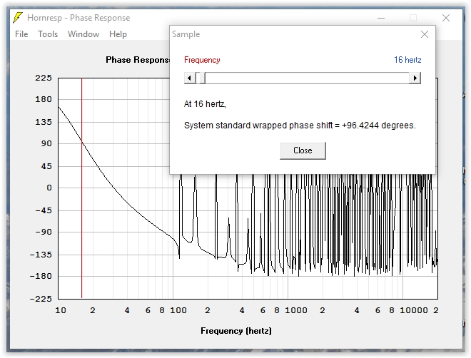

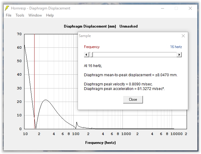

I ran the sim through with inductance effects. Same sim but I changed Bl from 21.39 (I think) to 16.3, which is the curve fit I did in my research (a bit more accurate than the "Large Coil" Hornresp tool which uses a generic formula based on all tested drivers).
The first graph is the unfiltered response of the same sim as above but with the inductance effect included. The hump at ~30 hz isn't as pronounced as the "Large Coil" tool indicates, as curve fit shows a bit less Bl reduction than the tool calculates.
Second and third graph show frequency response and excursion with EXACTLY the same filters applied that were applied in the previous sim (the 20 hz 2nd order LR high pass, 21 hz low shelf and 20 hz parametric eq boost).
So you can see the exact same filter settings yield a reasonable frequency response (although 16 hz is 3 db down now) and still protect the driver from excursion below tuning. Simulated at same voltage so excursion is a bit higher, just need to turn the volume down a bit to stay within xmax. The point is that the excursion below tuning doesn't skyrocket above the excursion above tuning.
So either way, with or without inductance effects, for the purposes of protecting the driver it doesn't matter a whole lot either way.
The bigger question is which method to use (inductance effects included or not) and what target frequency response to shoot for, as we have no idea what the room is going to do with the frequency response.
For my recommendation I'm going to sim it both ways (I trust my inductance correction method but I understand others might not) and I'll design a hpf that protects BOTH sub boxes either way (whether you trust my inductance correction method or not).

Hi Bach On,
Let me take a wack at the amplifier, etc. thingy too:
Post #789: "...I have the general impression that the circuitry of more powerful amps generally "negotiates" the power with the speaker..."
A power amplifier is a device with voltage oriented gain, e.g.: if the gain is set to x10, then for 1V input - a 10V output. Within the limits of the amplifers current output capability it does not care what the load impedance is, it's still 1V in and 10V out.
A vented (bass reflex) speaker is in general terms a difficult load as it has a strongly varying impedance particularly around its tuning (resonance) point, and as if that is not bad enough the phase of the acoustic output shifts considerably even if just looking at the driver without any eq or filters added.
So, in simple terms, the ouput power the amplifier tries to deliver changes with frequency (as the impedance changes with frequency). Some amplifiers are better at that than others.
The general rule of thumb for amplifer selection used to be 2x the speaker rated Prms (of Paes), so for your Dayton ST385-8 box, with 2ea. 8_Ohm/300W rated speakers connected in parallel for a 4_Ohm/600W load you should look for an amplifier with at least 1200W (1.2kW); for your SI 18Ht the data sheet just stated 600Wrms, so about the same power handling.
DSP functionality should enable you to arrive at a flat subwoofer system response above the the low cut corner frequency (or so). You want a flat response, as the signal that you will ultimately send to the speakers already has had all the processing it needs (or more); it has been recorded (sampled) in the real world, and then tuned to provide a suitable signal that after reproduction from you speakers should sound "correct" provided that the whole signal chain (including amplifers/speakers/chamber) produces a remotely flat response.
Post #794: "... I'll do the REW measurements. But I'm going to ultimately set all the voicing to match my personal tastes..."
I second that, get a good measured starting point, and then season to taste. 🙂
P.S.: The screen shots are from the Hornresp simulation of the corner box that I posted for JAG in Post #782. Bye the way, I do strongly believe, that JAG's "Large Voice Coil" method works, I just don't believe in the T/S parameters for the SI 18HT. 🙂
