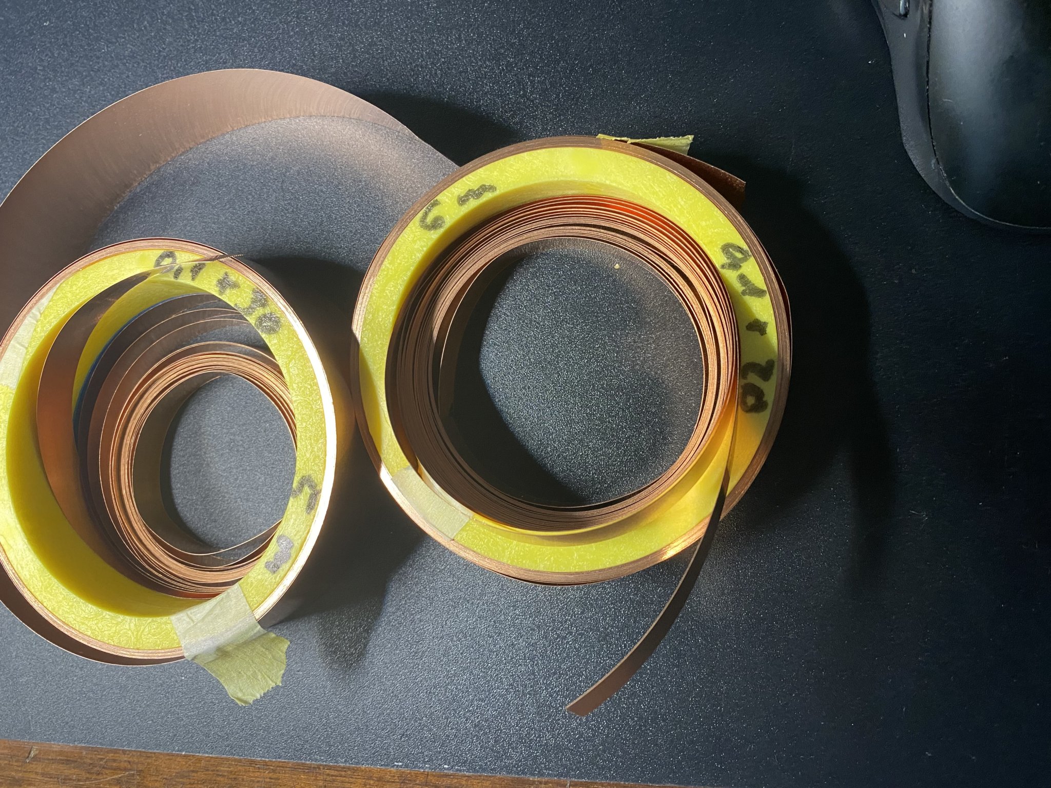

Do you mean something like this?think of copper foils, 0.1mm thick
I have 0.1x10mm, 0.2x10mm, 0.1x20mm and 0.1x30mm
0.1/10 good for tweets
0.1/20 or 30 good for bass
wrap them in plumber's teflon tape, then with wide sticky tape, and you're good
each line/conductor separate, do not make pairs

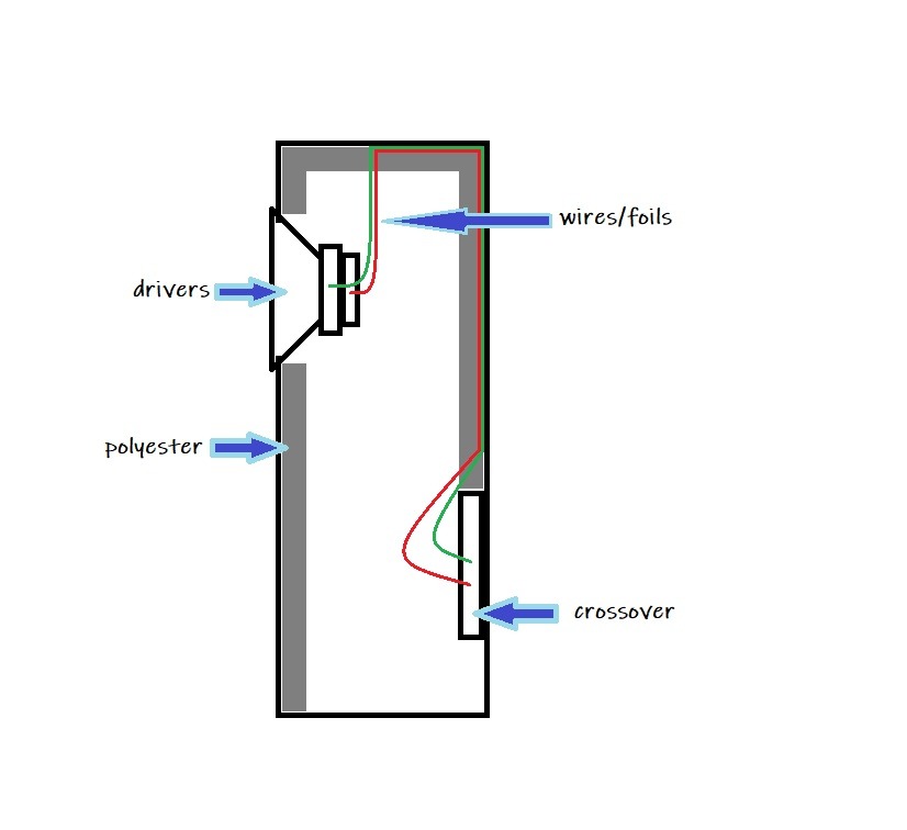

What about the wires/foils? should I place these under or over the polyester ? In both cases these will be fixed to the enclosure. In this case when they come from above on the back of the driver should I fix them to the basket?
Is it possible to fix them to the basket and then leave them hanging free over the TL? which my drawing doesn`t show. This way I will have shorter lengths of wire.
Is it ok to arrange the polyester like this? without having the back of the woofer covered?
yes

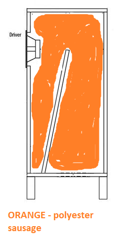

I had an impression that you understood what I was writing about big polyester sausage, arranged to take as much internal volume is possible, and (if needed) stapled just to top plate
what you're showing now i practically just lining of the walls
remember - I've sent you a sketch how to fill the volume of TL line
The arrangement part was not clear.polyester sausage, arranged to take as much internal volume is possible, and (if needed) stapled just to top plate

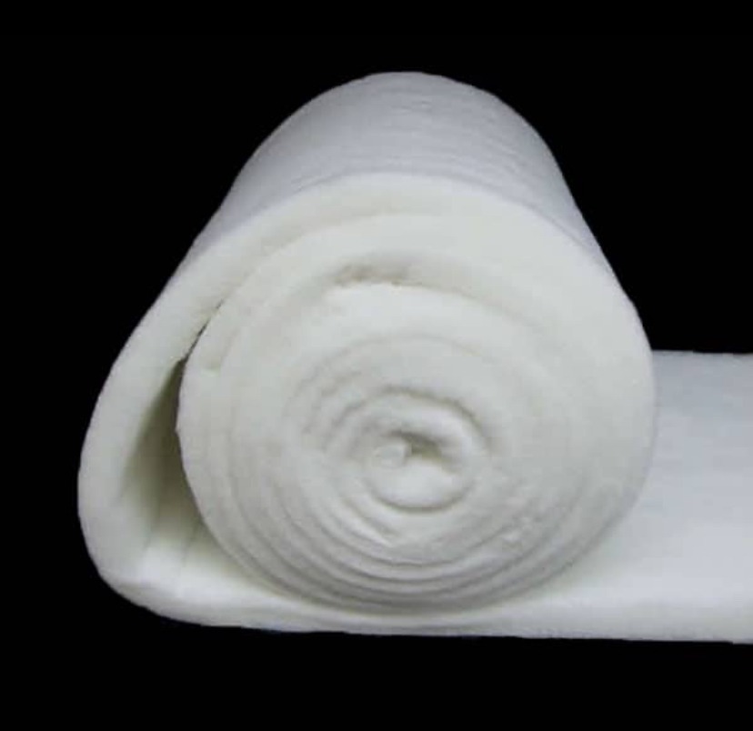

Let’s say I will take a low density piece of 1.6x1.2m and 2cm thick polyester sheet like this one
that will have the required weight and then roll it on the width.
If my enclosure internally is 30cm wide I will roll up a sauge that is 1.6x0.3m and 8cm thick.
On the top side I will staple it in 4 places, 2 on the front and 2 on the back, let say at 10cm from the middle in each direction having a square of 20cm.
If the sausage touches the inner diving plate is it ok?
With arranged to take as much volume as possible you mean to pull a bit apart the sheet of polyester first of rolling it this way I increase the occupied space, right?
improvise, goal is to fill entire volume in equal density
remember - calculated polyester amount [gr] is starting point
you can tune it by ear or measurement (if you know what graph shape you like), usually there is no need to add more than 25% even in most boomy rooms
and - it's completely normal that polyester is touching everything and anything inside ........
