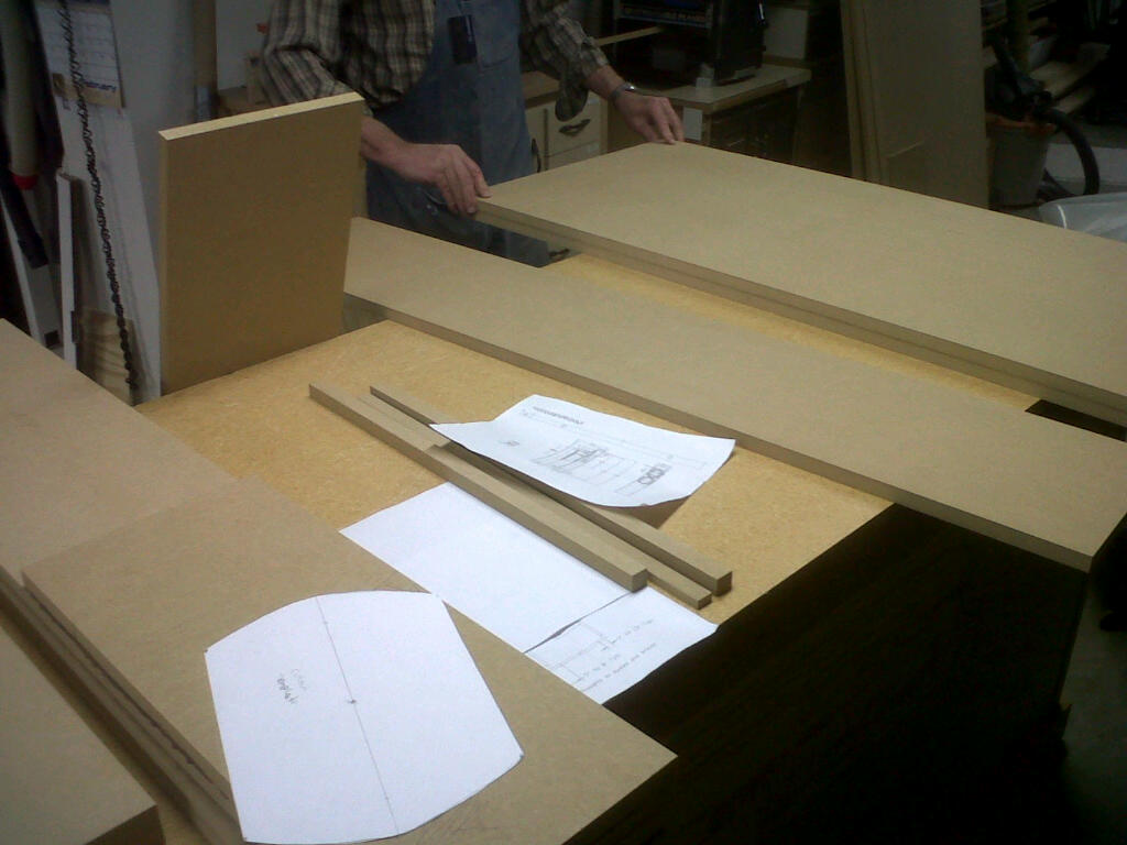

I chose 3/4 inch MDF. The material was cut today. I bought two full 97 x 49 inch boards.
The double thick baffle and horizontal divider are currently under a hydraulic press with veneer glue in between the layers being sandwiched.
I will begin construction tomorrow and I will post pictures as I put it together. I am going to go with the dual forward facing configuration with removable top front hatch (above the slot)
This is going to be an awesome subwoofer.

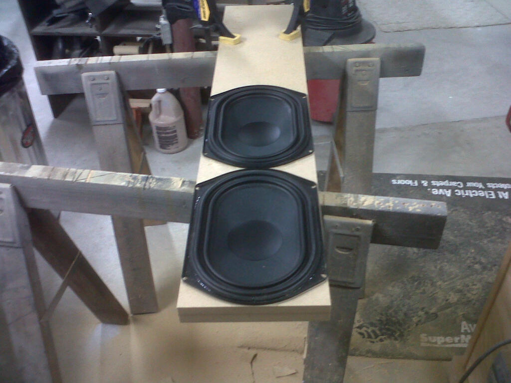

I have that part. I just couldn't find a template for the sub cutouts. I was able to get a document from T and B and make a general template with trial and error yesterday. We should be good to go.
What do you think would be better?
1. rectangle slot with removable top and bottom front panels
2. Single removable front panel with circular opening?
Once again, I can't thank you eneough for your AMAZING work/help on this.
Hi permo,
For a first try I would go with the round port / single front panel. Pictures? 🙂

I will post pics tonight for sure. Right now I just have a pile of cut up wood and some boards under presses. Tonight, We will be fitting things together, gluing and clamping. The only board I plan on using screws on is the removable front panel. The entire enclosure, without the front will be wood glued then put under a large press to cure/dry. I will then caulk the seems, add bracing and prepare the front.
Is it still a 7.163" diameter port with the center 7.005 inches from the bottom of the enclosure?
Would routing the edge to smooth the port out cause any issues by reducing the volume a little?

I wish it was mine. I have a retired chemical engineer/perfectionist friend with a massive workshop in his basement and two more (including a machine shop) on his property.
The boards are cut accurately within 1/128th of an inch, and we will be mitering the bottom edge of the slanted board at the exact angle for the design.
I will post pics of the project tonight. Hoping to get everything braced, glued and under the press tonight, excluding the front. That will be last.

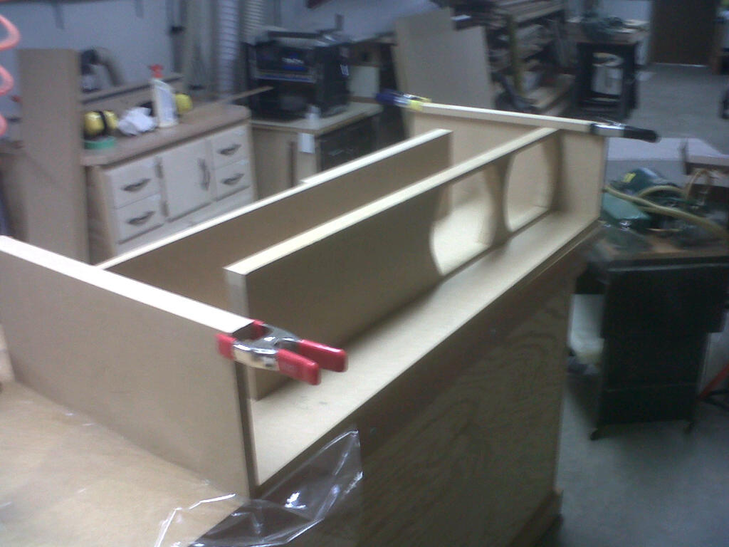

You need to provide some access to the S1/S2 section to be able to change the stuffing. The stuffing is a vital part of bjorno's design.
Hi permo,
That was my mistate, the rear is also entirely removable. Just like the front.
Hi permo,
Talking about mistakes, I went over the drawing one more time, and found an error in the length of the long vertical divider board (now: 42.752"). I don't think it matters, but it should ideally be a little shorter than in the original drawing. I also added the dimension for the duct cross-section below the long divider board (1=7.121). See attached drawing.
Hi permo,
Hey, no big deal. I made it the other way, but I can sand down the panel once everything drys. Tomorow we will mount the drivers and put the removable panels on. Also cut the circular vent hole.
