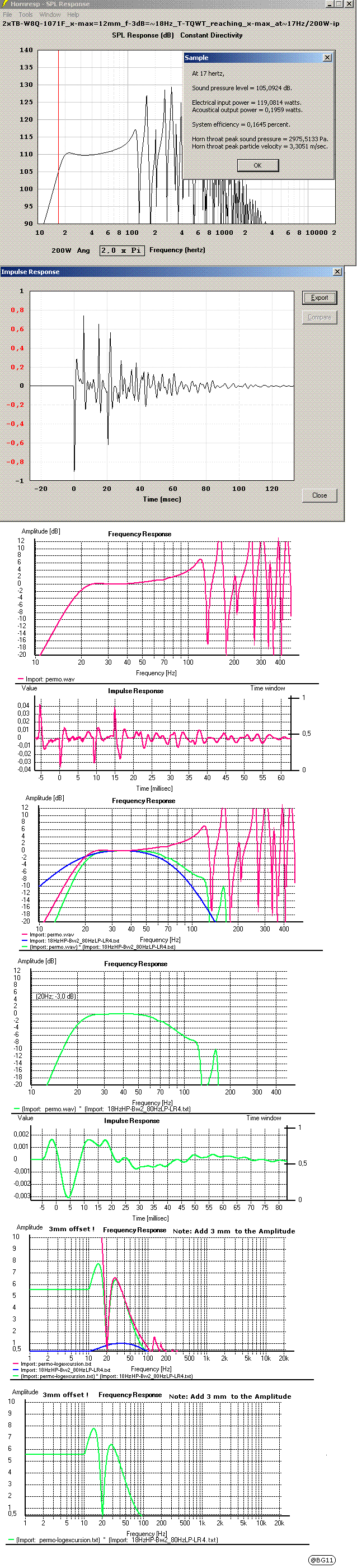

Here is a simulation showing the impact of a 18 Hz BW2 HPF and a 80 Hz LR4 LPF acting on the excursion of one of the posted simulations:
b:)
Wow, thanks so much!
According my hornresp, the new enclosure is basically a 30hz horn, so I am still concerned about the safety of my subs with sub 30hz material, but it looks like the high pass filter from the amp should help quite a bit. According to the graphs anyways.
Hi permo,
Post #53: "...enclosure is basically a 30hz horn...I am still concerned about the safety of my subs with sub 30hz material...".
When I plug the drawing values into Hornresp I end up with about a 19Hz -3dB point. In bjorno's graphs it looks like -3dB right @ 20Hz even with the 18Hz HP (green curve). Bjorno has the displacement dip right around 20Hz, with the values from the drawing you end up at about 21Hz in Hornresp. If we assume, that your amplifier can put out short time burst of twice its rated power (i.e.: 300W instead of 150W) you are looking at a displacement of 11mm @ 28Hz.
So, if your driver's T/S parameters are anywhere close to the ones bjorno used in his design-and, if the power rating of the driver's is even remotely in the ball park, you should have a 20hz T-TQWT that can safely handle your amplifier's undistorted output, particularly with music and home theater signals (I always advise against high-power sinewave testing, that's for manufacturer's that have a box full of extra drivers laying around). :)

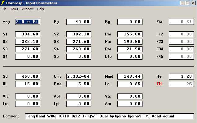

.Are these braces just centered within the duct so that they don't cause a disturbance in airflow? Here is how I get a way small volume...I entered the numbers from the diagram you so awesomely provided.
Here is where I get only 55 liters or so:
Hi permo,
The braces can be centered, or better offset by about the width of the wood from the center line, both left and right.
That is not the input screen, so I cannot tell if you have entered the same T/S parameters. Also, Hornresp volumes are net volumes.
Here is the input screen I come up with for Rev.01 (Post #33):
