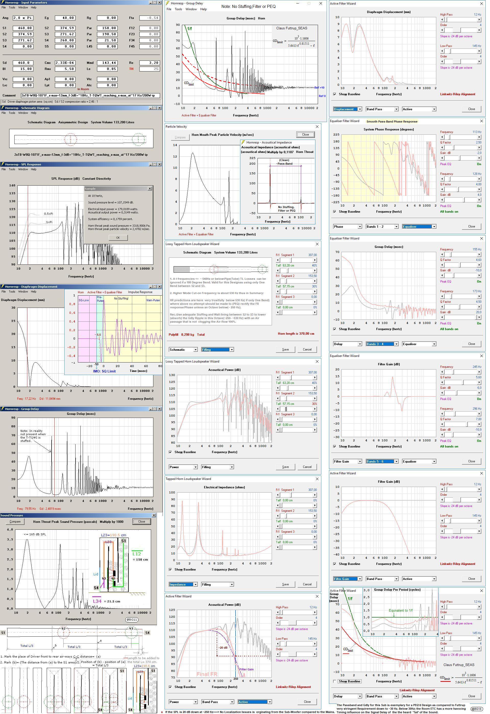

Thanks so much Oliver. I understand it better now. Am I right in saying that group delay isn't really a problem because at the length of the quarter wave tube the signal is 90 degrees out of phase and so it reduces/cancels out the potential group delay?
Oh, and I would like to get your take on group delay. It seems that it is really hard to create a T-TQWT with low group delay. Something about physics getting in the way.
When designing T-TQWT's, how does everyone go about reducing group delay so that it is not noticeable on the lower end? What are the tricks?
Hi uptime,All
Been busy over the New Year..

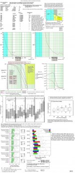

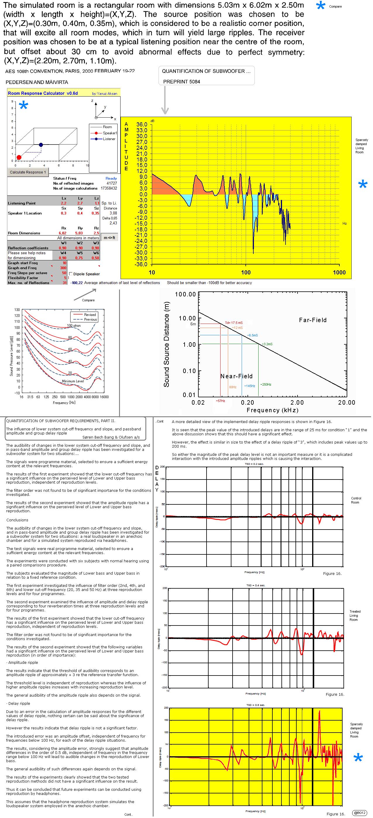

At onset:I think Gldy is easy to handle for quarter-wave-boxes as long as the (sub) passband phase is smooth and stays within ~1/f and don't cause ripple when integrating with the main speakers.
In common rooms: Up to ~3 dB narrow-band dips can be tolerated below~150 Hz(more when (sub) LF Pitch actually is heard,i.e. when needing more than 3 cycles to be audible RT30(RT 60) typically> 200 mS(treated monitoring room) but watch out for peaks of similar size that are much audible when interacting with the onset of the Mains. Off-band ripple must (IMO) be suppressed at the origin of occurrence by using damping material or clever introduced bends....
Here are some of my Notes concerning( or closely connected) to this matter..
Here: An easy reading of introduction to Psychoacoustics:
http://kurser.iha.dk/eit/eaku/litt/Psychoacoustics.pdf
