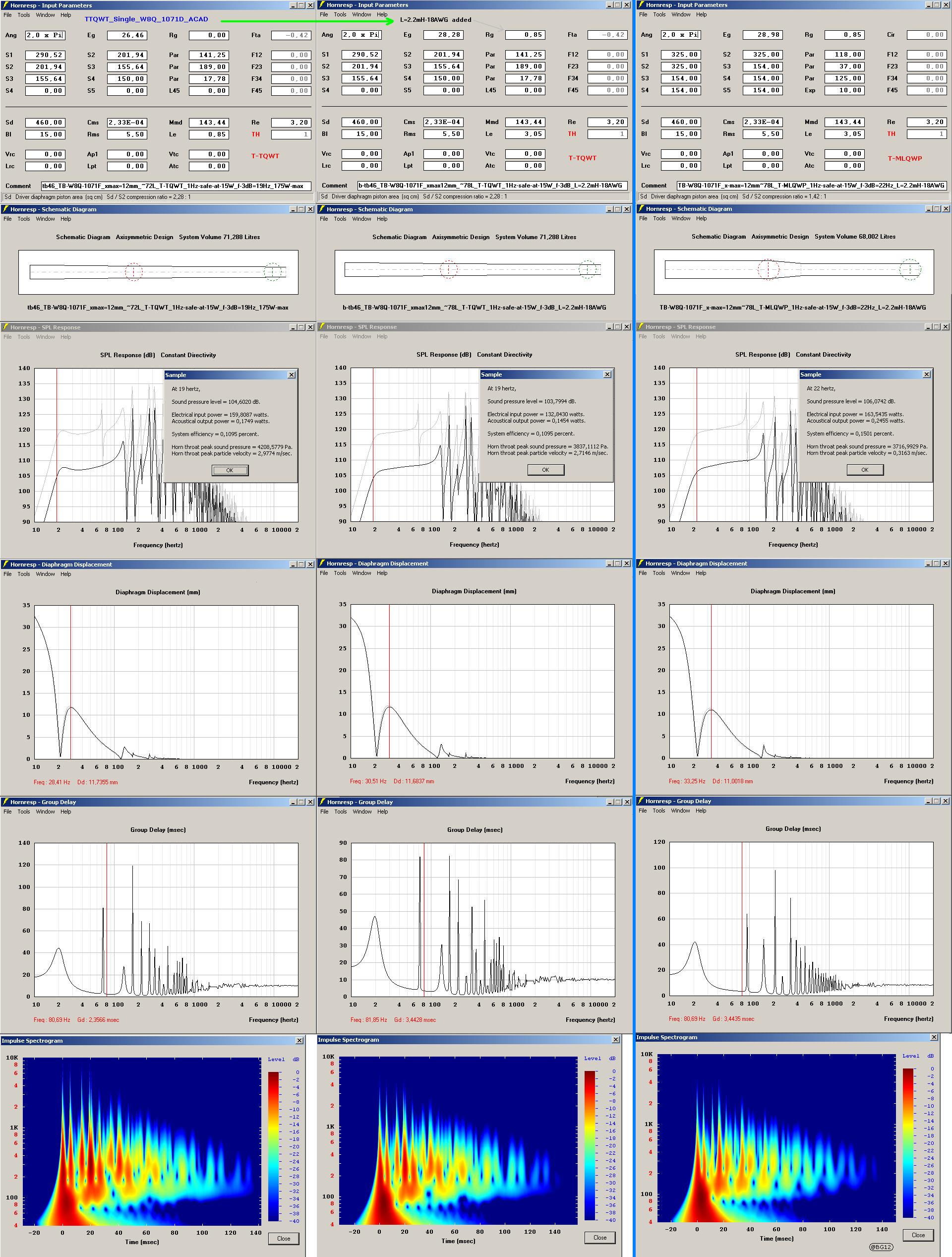

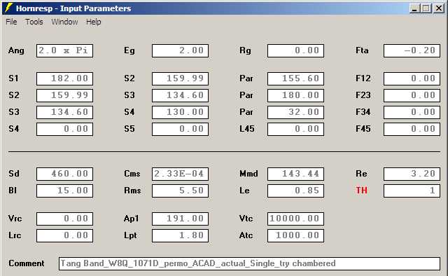

Hi Y'all,
I changed the design for a single driver T-TQWT using the TangBand W8Q-1071D around a few times, and this is my final version. I was able to get the driver into the enclosure without a coupling chamber. The dimensions should be easier on standard sheets of wood (4' x 8').

Hi Y'all,

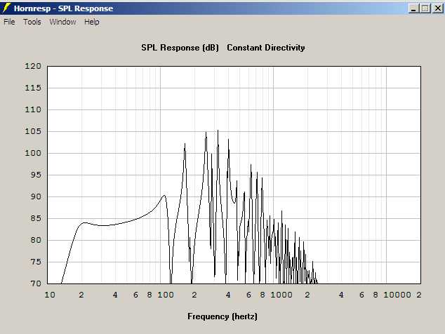

I've looked up my simulations for a single driver T-TQWT and found when entering/comparing your ACAD dimensions into HR almost no difference at all.
A trim point for this T-TQWT would IMO be to add a 2.2mH/0.85Ohm (18AWG) inductor in series with the driver.
A lot of drivers are not suitable for a T-TQWT due to the needed rear driver clearance but if implemented as a T-MLQWP (Tapped-Mass-Loaded Quarter-Wave -Pipe) it's IME easy to adapt to a compact simple enclosure.

Hi bjorno,
Thanks for looking at this. The value of a series inductor should probably be re-evaluated after stuffing, and equalizing?
I also like your T-MLQWP, another way of simulating, and looking at pretty much the same enclosure type.

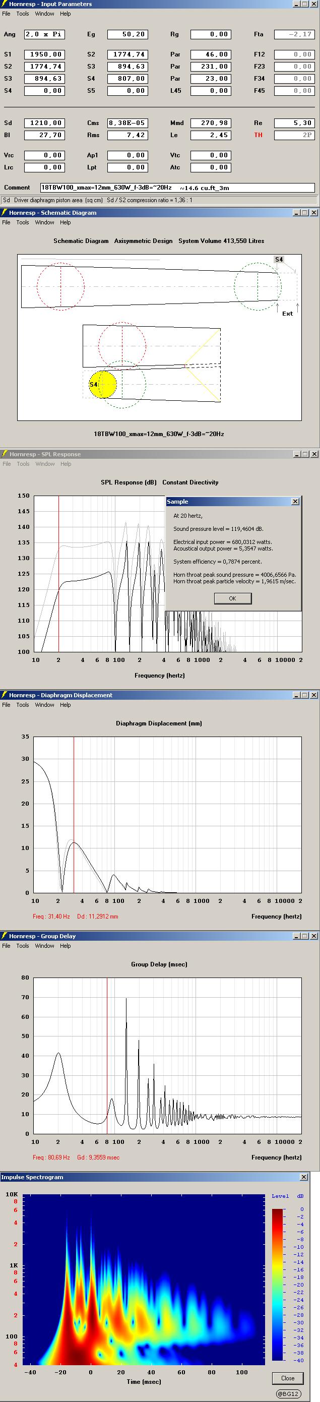

Hi uptime,
Great to hear that you and your son are having a good time putting this enclosure together.
As to the "...total "pipe" length...": this is the result of optimizing the response in Hornresp. If you add the 5cm to L34 the result will be a glitch in the SPL response @ about 70Hz. I know that may, or may not be a problem after the box is stuffed as outlined in the drawing, but I like to start with something that looks clean.
For me, the design process is an iterrative one, design in Hornresp, take it to a drawing, adjust Hornresp to reflect reality (the drawing), and so on... Next would be building a prototype, and testing the acoustic performance... Oh yes, you are doing that part 🙂.
To making the wood cutting easier: a round port, combined with a single front panel seems easier to me than a slot port with a two piece front panel, and the round port would move the "little block below the port" down; both should work fine though (bye the way, the front panel and the back panel should be the same raw size, there was an error in part of the original drawing). The 14/28/42" pieces are not at all critical, as long as they are sealed to the side pieces, and allow sufficient air around the back of the woofer. Luckily you can get to the internal boards by removing the back-or front-, that makes caulking the board edges easy.
I'll attach a revision of the original drawing in Post #170:
