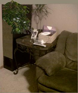

The one in the picture is upstairs in my house, it's supposed to be temporary as my main listening room is being build downstairs. I have a feeling I am not going to want to part with it. May have to build something even nastier and bigger for downstairs. Although I don't know why I would need it.

Oliver is the one who should recieve credits for this design: My contribution is if compared with his IMO very modest..
b🙂
PS: The potted-plant placed on top of the enclosure is an Hoya...needs little water and a share of double-bass music in order to flourish. 😉

I love the pic! I actually think it might be a good idea to add some colorful formica or something of that nature to the front. and figure out what plants love low frequency output.
My next one will surely be built from 3/4 oak or baltic with stain, and varnish and trimmed out. I am thinking more of a big, massive chunk of a rectangle. Something that could double as an end table or ottoman.
I was thinking last night, that I have heard bass of this nature before, and it just came to me. When I was in high school I went to a white zombie concert and I was in the pit. The bass that came from the 100 foot tall wall of speakers/amplifiers was similar. It has that fast, chest thumping impact.
I am completely awestruck at the sound and capabilities of this thing. Additionally, it should be known, that this is with a 150 watt amplifier driving the thing.
