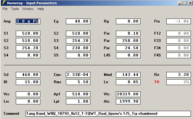

I'll attach a Hornresp input as an example:
Hi permo,

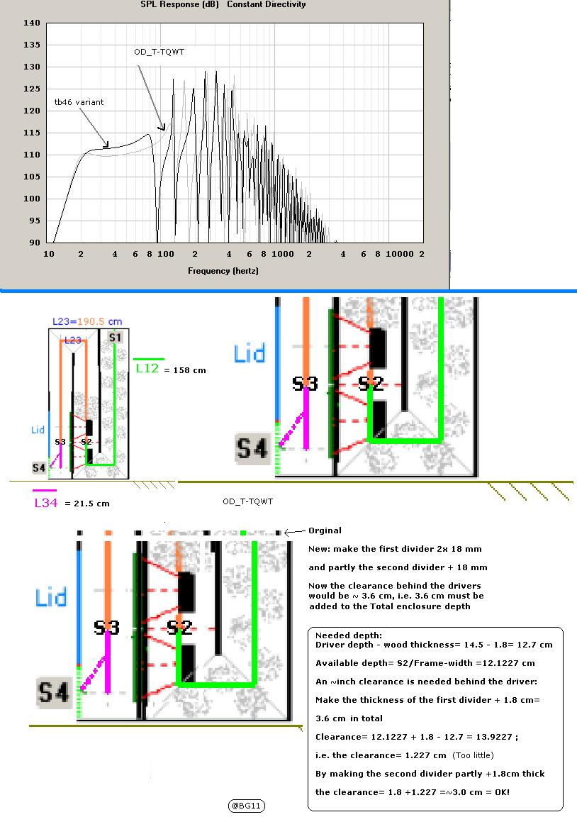

To give you a general idea what this type of enclosure would look like I'll attach a drawing for a "Chambered T-TQWT" (using the TB W8-1071). You can enter the data into Hornresp, and see if you think this would be something worthwhile. To accurately model this one you would have to go into AkAbak, but I don't think the difference would be very big. By the way, if you want to combine S1 and S2 in Hornresp, you give them the same area, and set L12 to 0.01cm.

Here is what happened, I put bjorno's numbers into a spreadsheet that I had used to calculate the cross-sectional duct heights for a symmetrical tapped horn, in other words I divided the duct height by 2. Obviously, the drivers would not fit anymore. Well, haste makes waste.
I redrew the sketch to reflect bjorno's design. I hope I got it right this time. I don't think that the taper from S1 to S2 is necessary, as the stuffing in this section can be modified to suit. I guess the little extra duct below S4 would have to be modelled in AkAbak.
Hi again,
I revised the sketch with straight back, and one driver inverted (and moved over with a mounting plate). This one could be cut from one sheet of 4'x8' material (if one is willing to stick together one side panel from two pieces).

Hi Oliver,
Thank you for the drawings: 😎They are great! I have no objection on these layouts.
Is it possible to incorporate lid(s) for to attain easy access to the drivers?..and maybe the volume of damping material (= half-ways down from the S1 area at max.)

Hi permo,
As to the wood working, as bjorno indicated, there are a number of details to be worked out. I would probably build a trial box out of MDF to see how everything fits, ultimately this calls for voidless plywood. You have to provide access to the drivers. The front driver would most easily be accessed from the front, so it needs a removable panel, and if you use the inverted top driver, you may have to add side panels. 3/4"x3/4" cleats (or battons) should work for mounting the panels, 1/8" aluminium strips can be used in the 8.625" dimension to reduce the reduction of the cross sections. You may want to give some thought to internal bracing, please, see DrDyna's thread. For a trial build I would leave one side plate loose, and attach it with screws and weather stripping. You need to be able to add damping material to the S12 section of the enclosure. It always helps to draw the location of the dividers on a side board.
I'll add an idea on how to layout the cuts on one sheet of wood. I'm busy today, but I'll try to add more dimensions to the drawing tonight.
I'll leave the question about the compression ratio to bjorno, but I think its fine.
