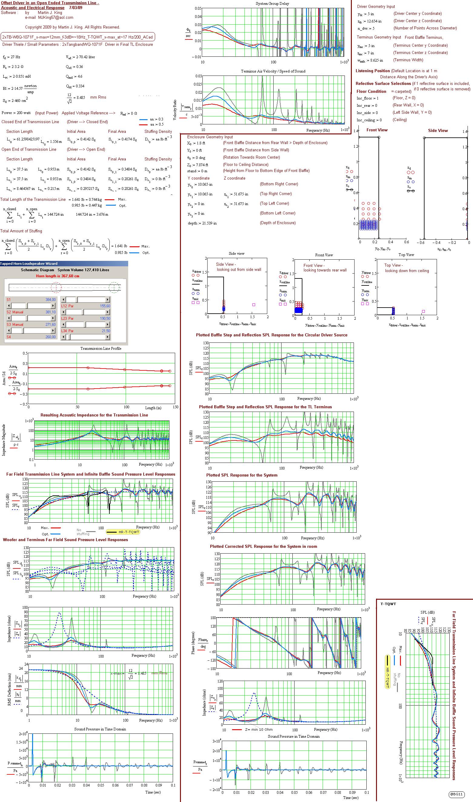

Here is the hornresp input screen for the latest and greatest. -3 of 18hz!! AWESOME
Here is the SPL response for a corner location @ 200 watts. WOW

Hi permo,
Post #78: "I am hoping that making the top and bottome ledge of the slot opening an extra .72 inches in thickness towards the outside doesn't cause any issues."
You are correct, that will not change the response of the enclosure much; you can test for the effect of changes in Hornresp, in this case just add 1.8cm to L34. You'll also need access from the rear to work with the stuffing in the L12 section.
Hope you're making good progress.
Hi permo,
Good call, virtually no change, if anything a very mild low frequency (20hz and down) improvement.
I will make the same removable panel for the rear.
Turns out this thing is going to weigh ALOT.
