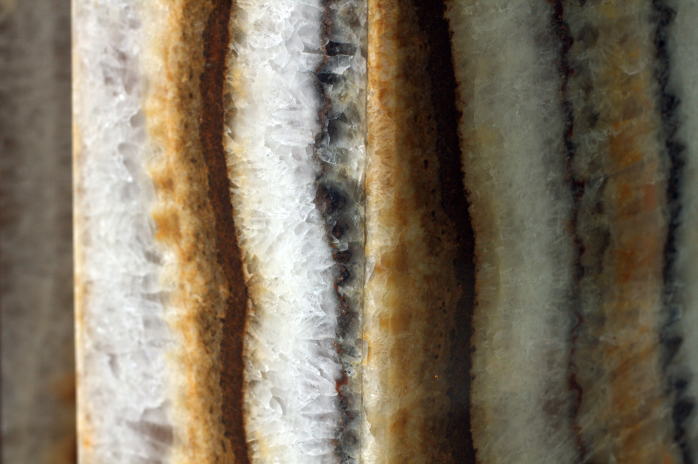

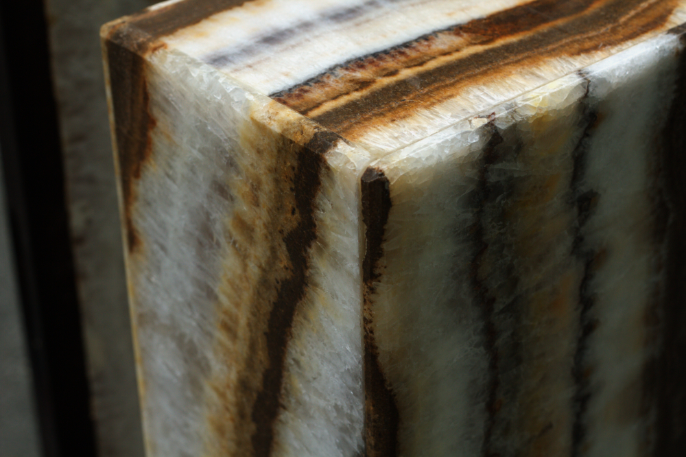

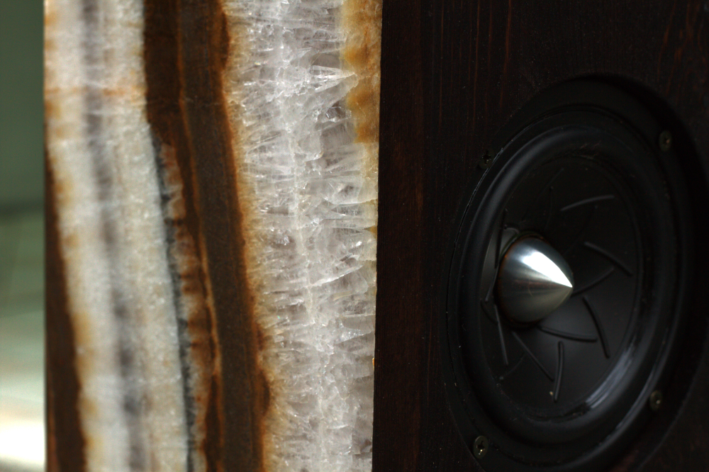

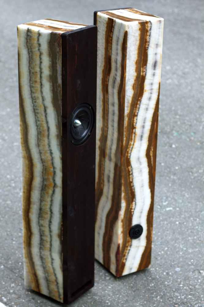

Did you see my onyx TABAQs?
I already found my next stone for my next project. It's called "Blue Barracuda" !!
It's a granite from Brazil, and it looks amazing when polished.
I'm having so much fun!
Don't recall, but this new one looks a stunner! Growing up in a state that mines marble, slate, granite for all manner of apps, I guess I could be called a 'stoner'

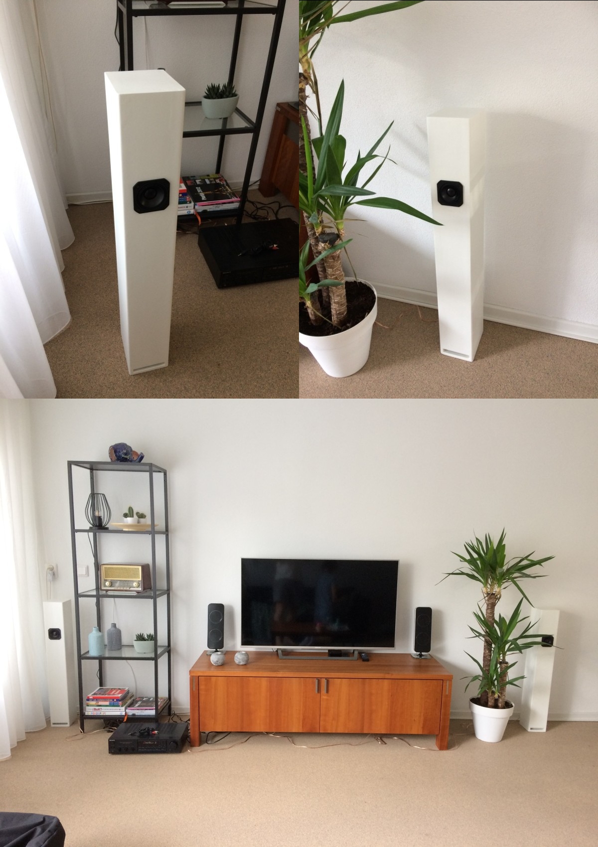

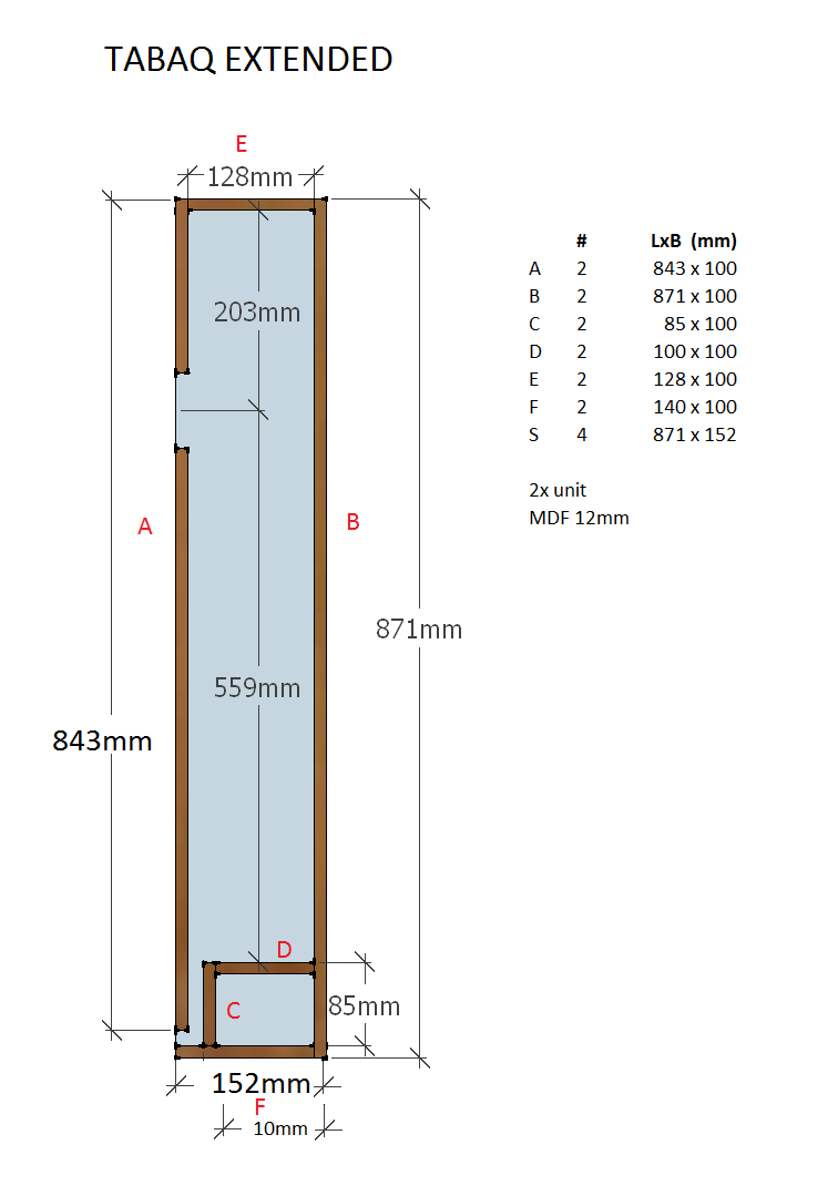

Tabaq Extended
I have finaly finished my "Tabat Extended" a redesign from the original Tabaq by Pavel (see post #1651) with a feet filled with sand.
The driver is the 3" Peerless P830987
The woodwork and the paintwork arent perfect but I am happy with the result.
At the moment I am testing (and enjoying) them with an old Sony reciever (no BSC).
I am doing some research on buying a small amp kit from Ebay or building a setup based on a Raspberry pi with a DAC/Amp combi board.
Kind regards
Harry
