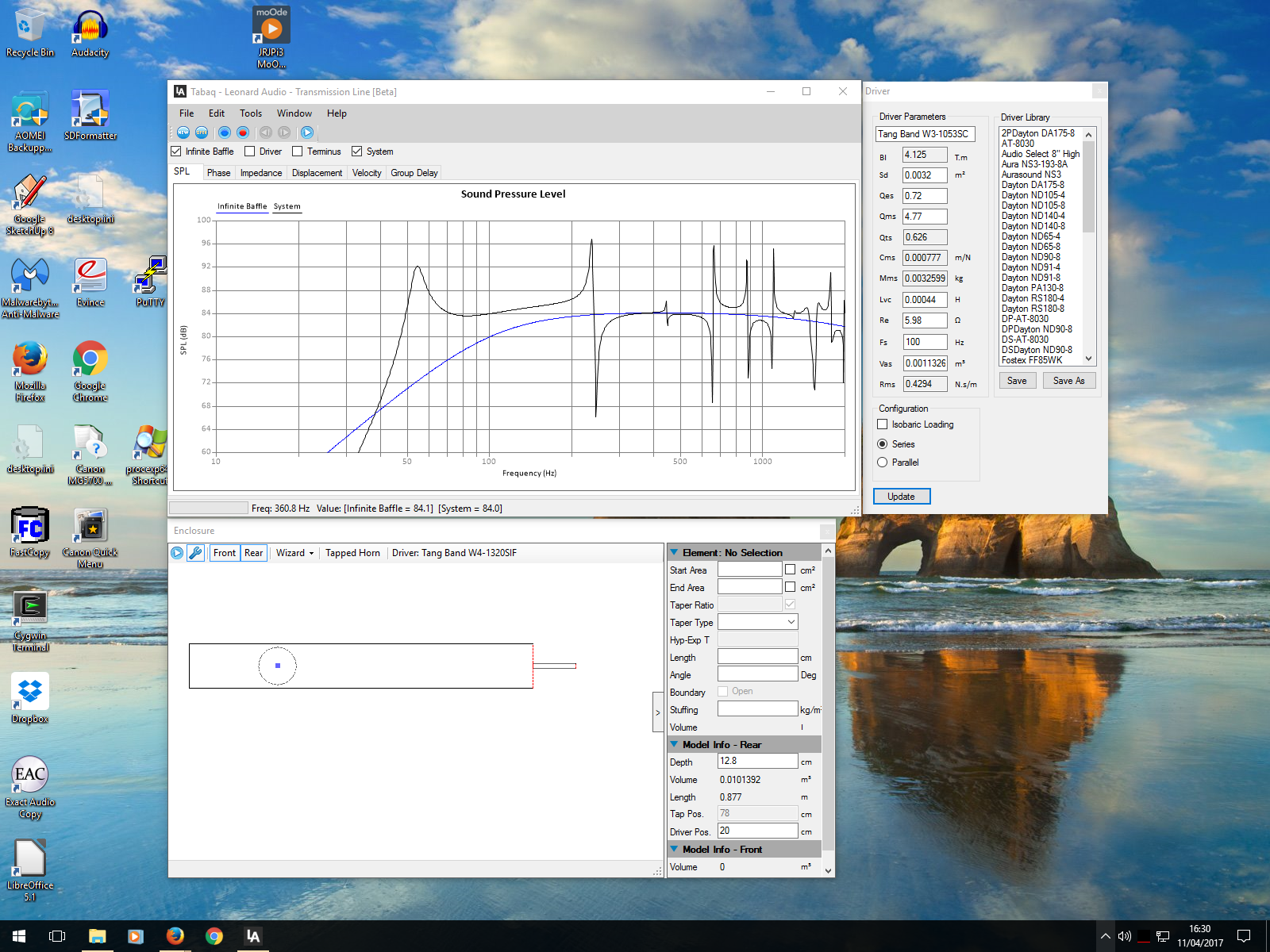

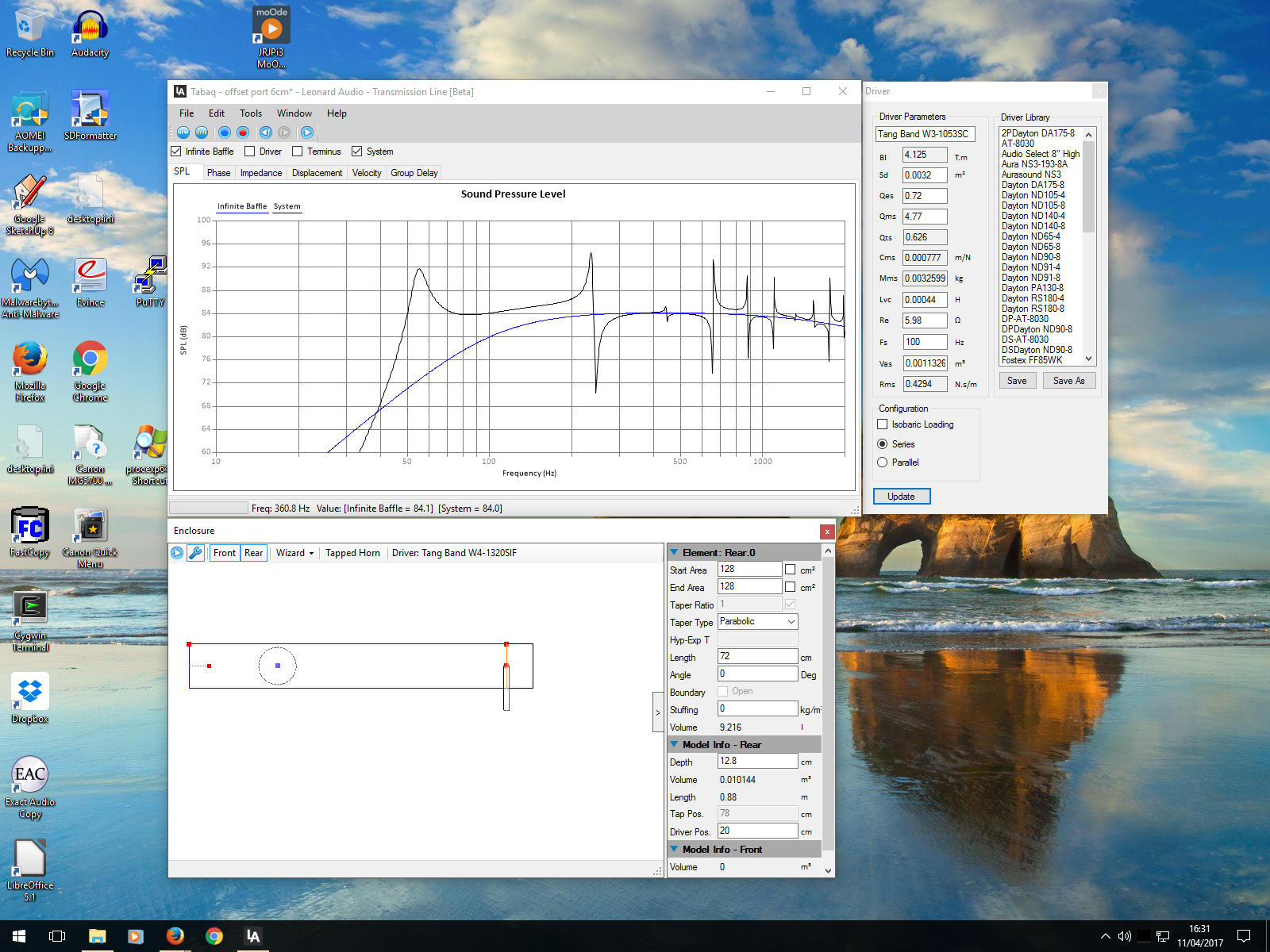

Hi Bjorn,
I've tried something. 🙂
Offsetting the port from the end of the line shows some promise in LATL.
Assuming standard Tabaq of 78cm x 128cm2 with a 9.7cm x 16cm2 port.
Offsetting the port from the end of the line by 6cm and increasing to 10cm long.
J.
