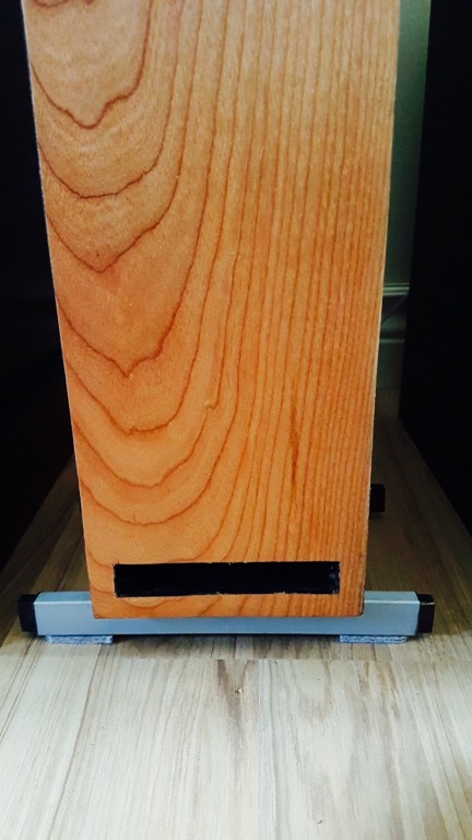

I tried this to add stability
I had them on them sitting on the floor, but with cats in the house they could easily tip over. I added these feet a bit wider then the speaker width, this helped with tipping over sideways. I couldn't really tell a whole lot of difference with them on in the bass. With the pads on the legs it changed nothing also to my ears.
