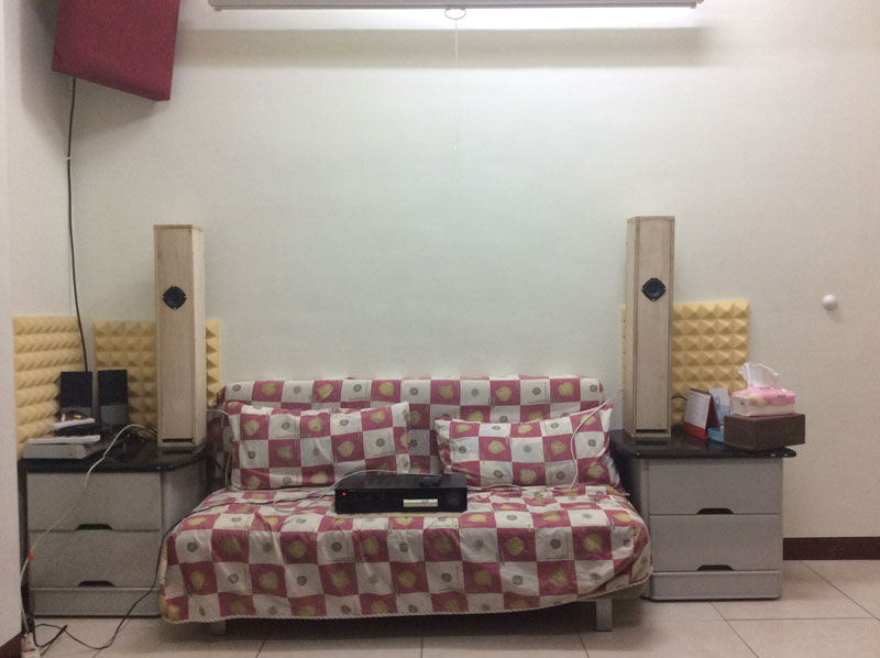

Found some wood, not ply, at BnQ over here. Best of all, dimensions were almost spot on! I only had to cut the length of the boards. Kept dust to a minimum.
Fun and fast build. I assembled 1 1/2 enclosures in one afternoon. Will finish the other tomorrow and paint / varnish them right after.
Since one was already assembled. I took it inside and connected it, for fun.
This was me:
NO WAY! Did you hear that bass?
These are insane. How come such a quick and easy build sound so good?
I have yet to add the BSC, and stuffed inside with 75g of polyfill only.
I will wait until I finish the second one to really have a good listening session with them.
Thanks a million to Bjorn for sharing such a cool and easy little design.
Maybe, one day, I will do a TABAQ XXL with my W8-1772. That would be fun too, I'm sure! 🙂

Not sanded nor finished yet, I just couldn't wait!
Since we have a 5-day vacation for the new year here, I wanted to hear them right away!

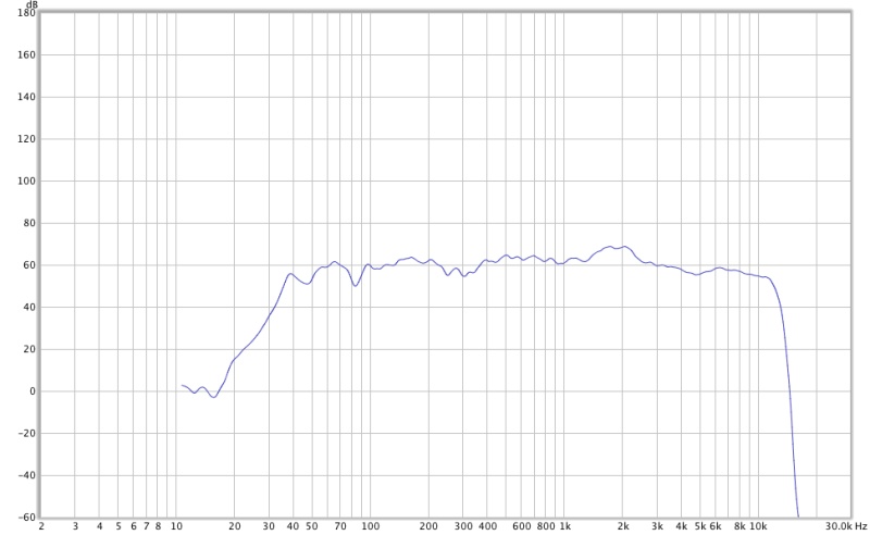

The drivers I have used are locally made (Taiwan) and are good... enough. Not particularly the clearest, but not bad either. They do work overtime when trying to reach the lower frequencies. I had previously tried them in a smaller vented enclosure, and they would just break down when pushed a bit harder with lower frequencies... but not this time! The TABAQ design seems to be doing a great job at keeping it all under control.
The bass output coming out of the TABAQ is one of the cleanest I've heard... and that's coming from a 3-incher?
The kick drum sound has got to be one of the nicest I've heard. It's clean, refined and right to the point. I can hear details in it that I have not heard in speakers that are much bigger (and much more expensive!).
I'm sure that a driver with specs around the same as the drivers I have, but with a cleaner high end would be nothing short of amazing. Or a nice 4" perhaps!
A little EQ cleaned the high end a bit, but I'll be looking for a better driver at one point. I'm tempted in turning these first batch into surrounds for my HT system. The low end they provide would help in action / sci-fi movies for sure!
So, here they are in my recording room, along with a quick measurement at listening position, no EQ involved. Pretty darn good considering how simple they are ... and cheap!
