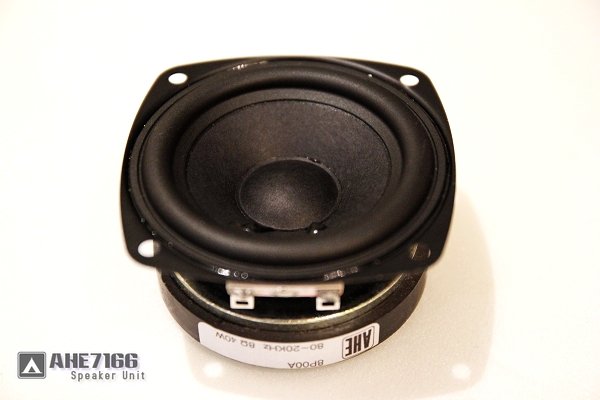

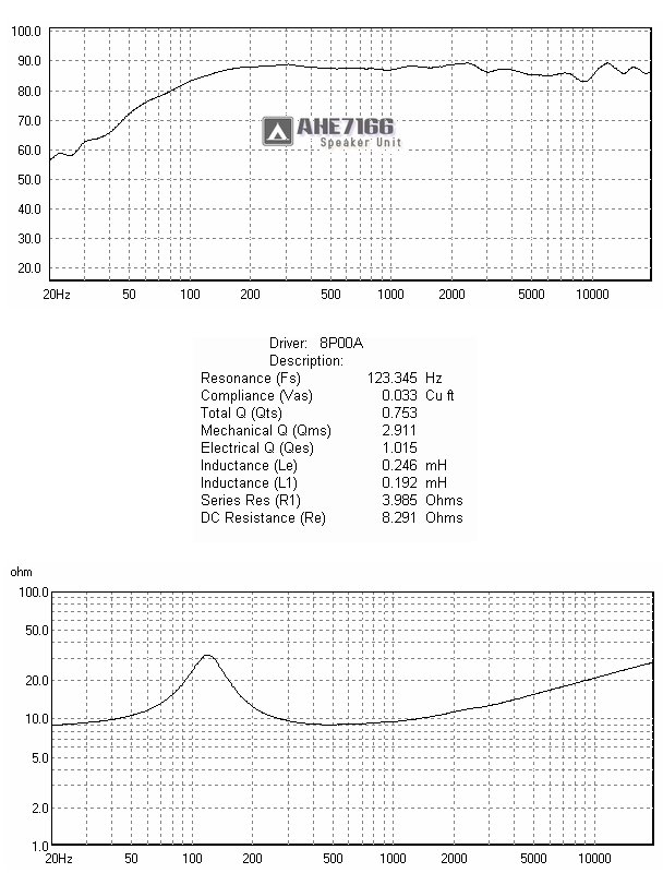

I have a few extra drivers left from my arrays build. They have a nice clear high end, but lack some punch towards the low end. Perhaps the TABAQ is their answer.
The sticker on it says 80Hz to 20kHz but Fs is 123Hz.
So, what about this one? Just use as is in the folded 3" TABAQ?
