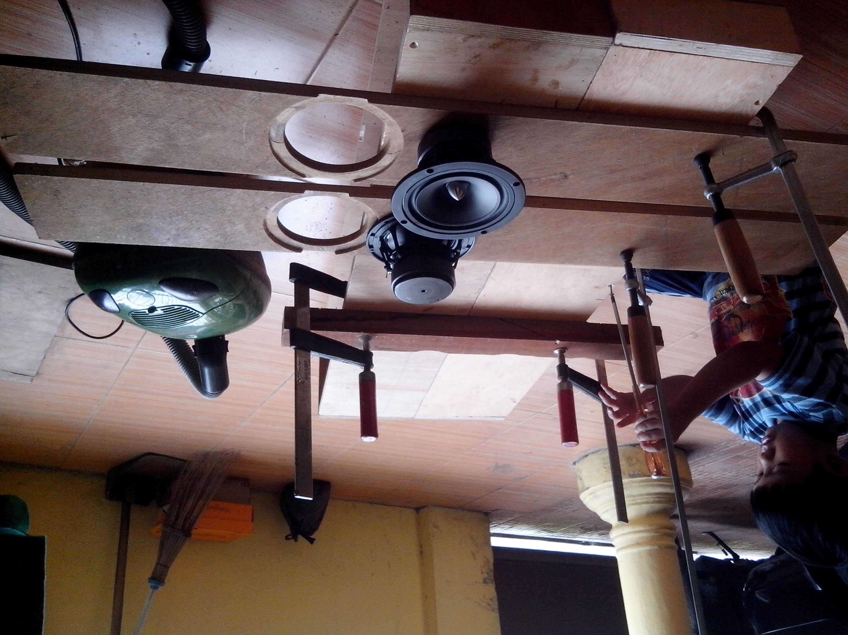

I haven't completed mine yet. Having only a jigsaw to cut straight pieces slows me down, and I've had a few that turned out wrong by a few millimetres which is annoying. I am close to final assembly though. I'll be putting the port at the rear, and they are stadium-shaped or "race track" shaped rather than rectangle.

I did some final testing before sealing the speakers for good, and I like what I hear. Bass extension is incredible for a 5 inch pair. It can sound a bit muddled up with complex bass passages, but not to the extent where I'd complain about it, and it certainly is fun sounding.
Actually today I did. That time I didn't use the 200 grams as the instructions said, it was 150 grams. It was quite boomy and had a bit if a spike in the low vocal range, and had a 'home theatre' like sound to it, which my father likes. I added a few more strips of polyfill to one of them to get it up to 200 and compared the two. The denser one did get closer to what I prefer. I think I'm going to go in between those two to get a sound that's to everyone's liking.
