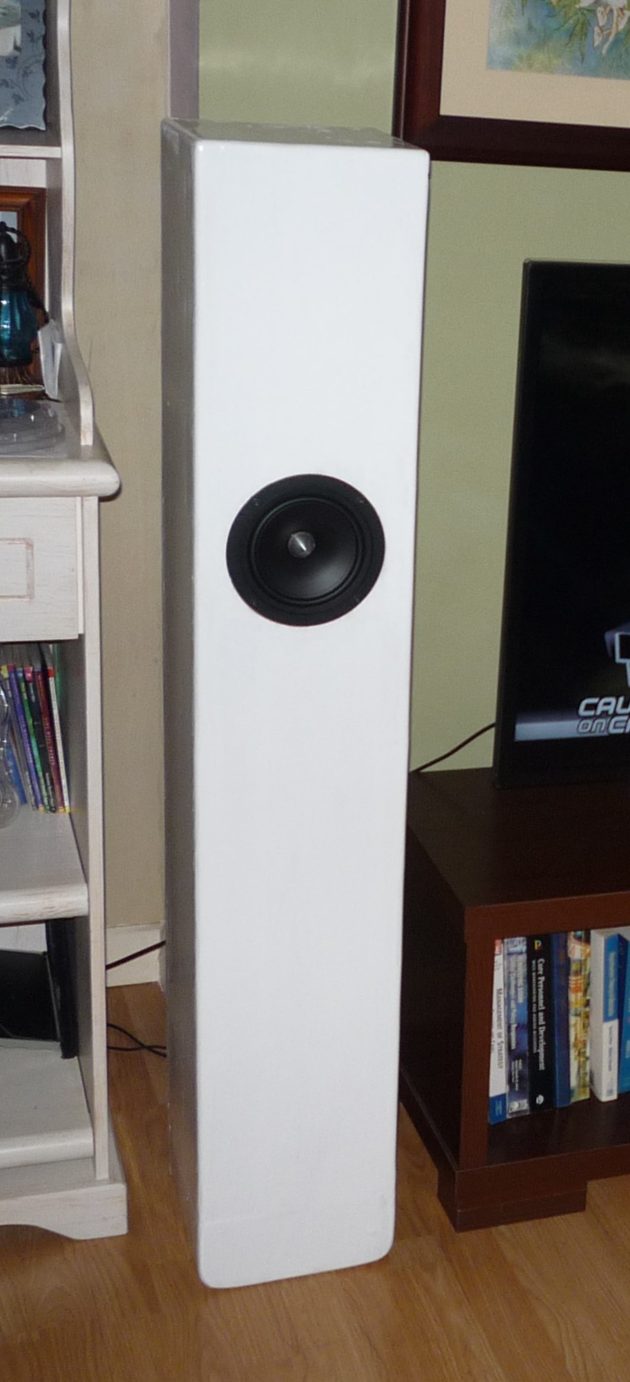

Despite my shoddy woodworking skills and my lack of patience and proper equipment, I think I've done it right. My TABAQ Large sounds wonderful, even when only hooked up to my smart TV! Listened to everything from live concert, HD movie channels, and my own collection via the TV. Of course, hooked up to my desktop DAC it did sound much better, but that's not what I built this for.
The bass extends very far down, and to my relief there was only bass when there is bass to present in the first place. Listened to pink noise and some music I'm familiar with, compared to my headphones these were more tonally "correct". Everything is to my liking. The stuffing is a bit less than 200 grams, but I did experiment with the extra pyramid foam pieces I found and lined the top and back until almost 2/3 down. Don't know what help they gave but they certainly didn't do much (if at all) harm. Thanks Bjohanessen for the construction plan.

Kctess5: looks nice. The speaker placement is quit low. How about the length to the port and the consequence for the frequency?
Yeah as Bjohannesen said it's just the folded version, so it's the same dims. I really like the folded version of this design. It gives some ridiculous bass extension in a small package, and it seems to control woofer excursion much better than bass reflex.

TABAQ large with W5-1611SAF. Despite my shoddy work, sonically they're not affected. The dimensions are correct to the millimetre, and the front baffles are braced using those metal brackets to the 36mm side baffles (2x18mm plywood glued together), just because I want them to be pretty much indestructible. 😛
The front baffle is wider because of the thicker plywood, and I placed the port at the rear, just because I've never had a speaker with a port at the rear so I want to know the difference. Basically the same, except it is much more sensitive with placement relative to the rear wall.
