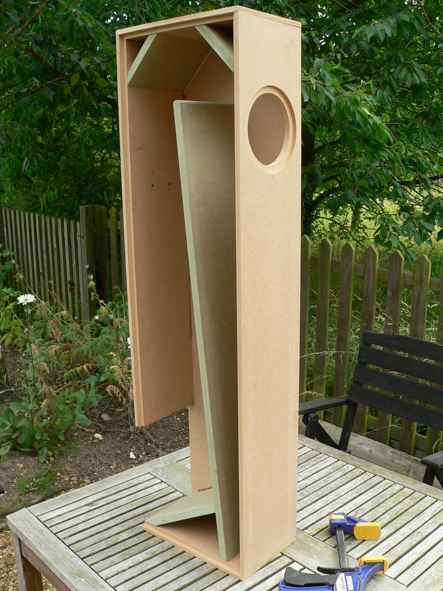

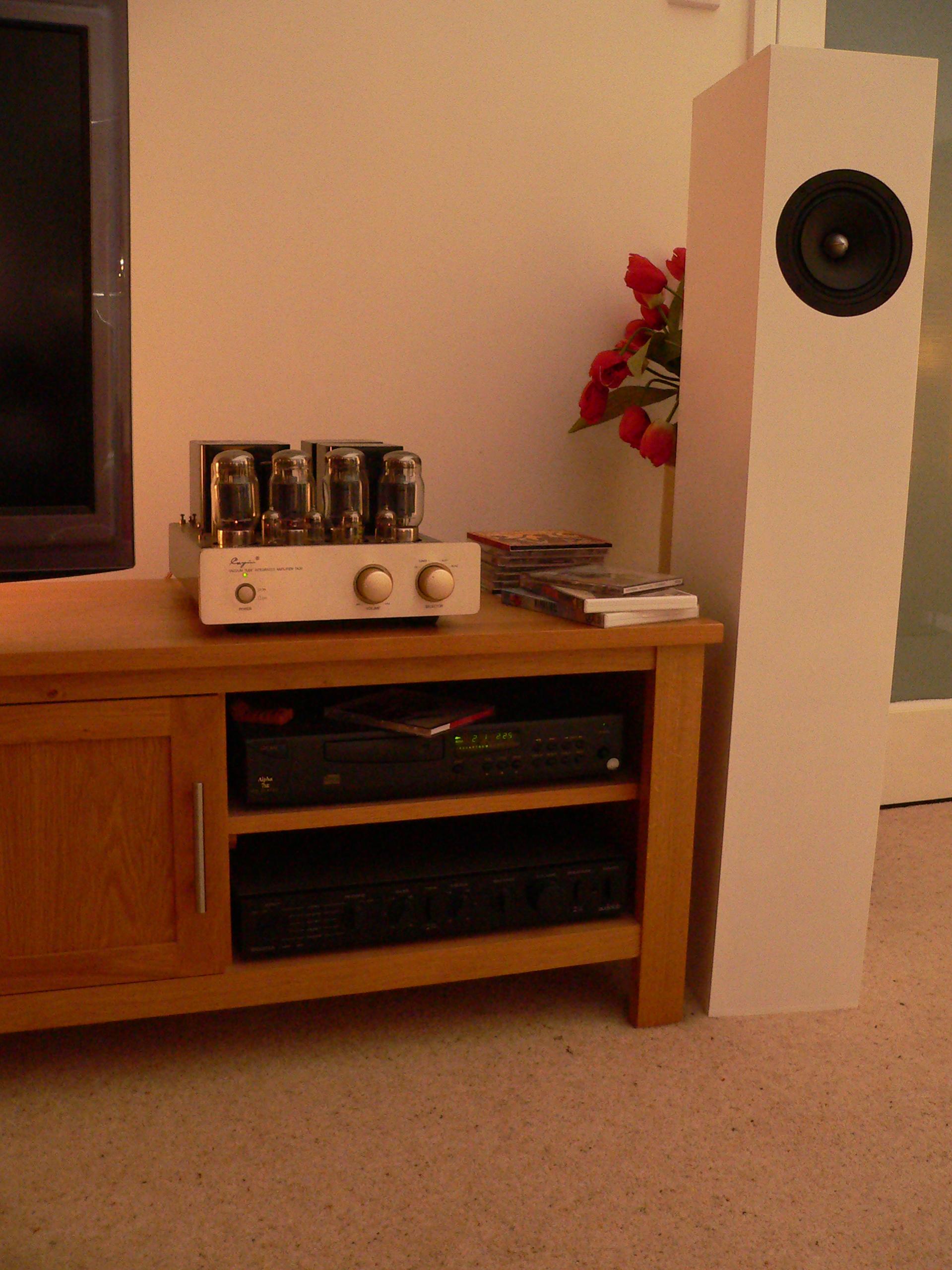

TABAQ W1611
This relates to threads a while back dealing with TABAQs. I posted that I was making a pair using Tang Band W5-1611SA and would post pics on completion. Here they are.
They use the Conical Horn design by Roland Breteler in Holland (see crafty.nl) and are free source. I've paired them with my wonderful Cayin TA-30 valve amplifier but sometimes I switch to the Audiolab 8000 in the shelf below the Cayin. Both drive them well, but the valves win.
House management decreed that they should be unobtrusive hence the white, which doesn't look bad. It's just rollered white matt paint over sealed MDF.
They are definitely worth the effort: human voice is great, likewise jazz. Even Sky radio sounds good.
They look good.
I used to have an Audiolab 8000 as well. not the warmest, but precise and detailed. I miss it... gave it to my kid brother!

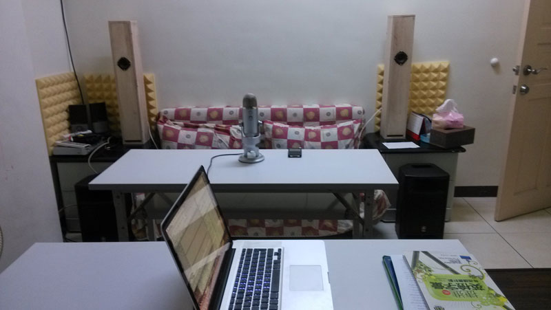

Here's a quick recording of the TABAQ I built, with the local taiwanese drivers. There are 3 excerpts of songs from Dire Straits, Eagles and Jessie Cook.
There is no EQ, the TABAQ are placed on the wall, 1.8m apart. The mic (a Blue Yeti microphone) is placed in an equilateral triangle, at 1.8m from each speakers. I set it up as a stereo mic.
I am using an old ipod to play plain mp3 files connected to an old Usher amp. nothing fancy here!
The room has bass treatments higher up in the corners, so actually more bass, and too much in this recording, since not a lot of cancellations happening.
They would benefit some EQ, but this is as RAW as possible to give a taste of what could be achieved.
Did I mention I amazed at the possibilities? 😉
https://soundcloud.com/perceval-1/tabaq
