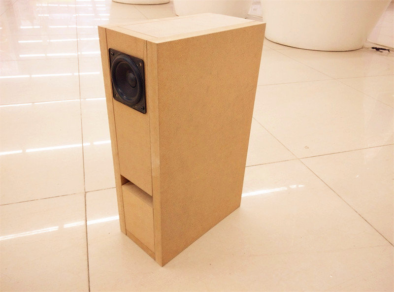

So did you actually build this? If so how were you able to chamfer such a skinny region? There is no way I can do a 45° chamfer.
Perhaps it would be easier to start with a baffle that wasn't so thick. Certainly not necessary w/ these drivers.
If the backside is so "skinny" it's hard to chamfer, I wouldn't think the chamfer was necessary. You could also chamfer with a file or sanding block. That should enable any amount of chamfer you want.
The original plans call for 12 mm MDF but didn't mention chamfering. If people don't typically chamfer at 12 mm then I won't at 15mm since its only a 3mm difference.
Yes, I used a small rounded bit to chamfer the driver's opening. Go slowly and you should be able to do it well enough.

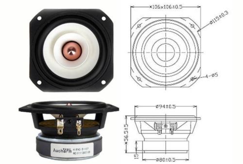

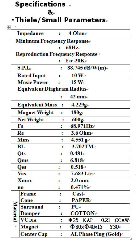

Shopping around for drivers on the local market and found a couple of things.
Didin't know them, but these Aucharm (made here in Taiwan) seem to have good reviews. QTS is a bit on the low side but should be enough, I think.
They seem to sell for $70 to $100 elsewhere in the world, but I can get a pair locally for $50.

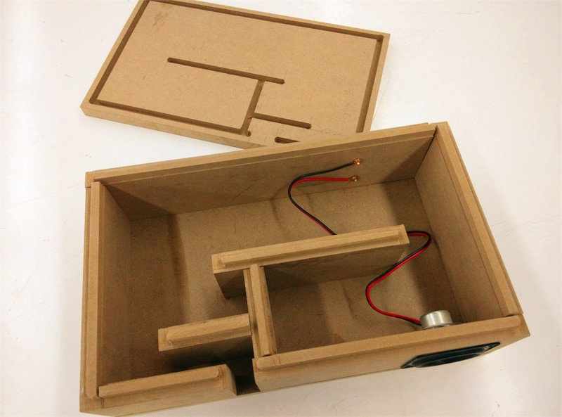

I completed one Tabaq cabinet yesterday and did a fitting just to see that things were done alright. I hope to complete the second cabinet by this weekend and get the Tabaqs running. I'll post images of the bare bones finish after I finish.
Next month or so, I'll try with 5" drivers. If it is anything like the Cornu, where bigger is better, than I should be quite pleased with a larger version! The 3" version is already so nice! 🙂
Those Cornu speakers will be a hard act to beat after this. I'm breaking-in my Founteks in the larger Cornus (21") that I'd built. These will be mounted in the Tabaqs. Judging from what I heard from your clips I hope I get a good listening experience in the Tabaqs, moving on directly from the Cornus. Unfortunately I don't have enough wall space for larger sized Cornus! 🙁
Can you give a link where you found them speakers. ThanksAlso, that same seller seems to have a version of TABAQ folded for sale....

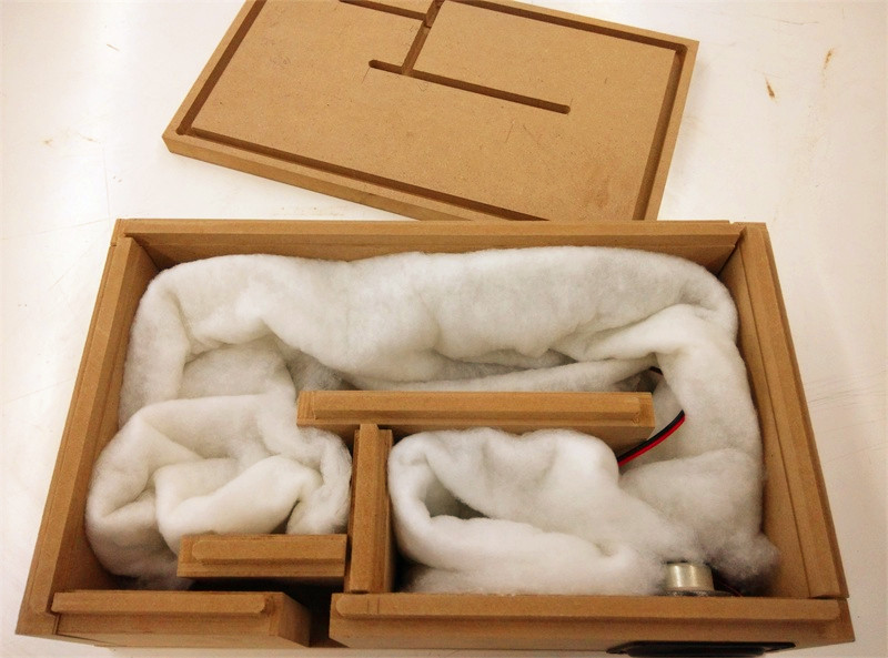

That's a lot of stuffing...
Here is my build
That's an Aucharm?

Someone should try RS100-4 or RS100P-4 in Tabaq

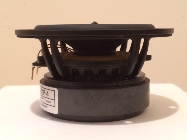

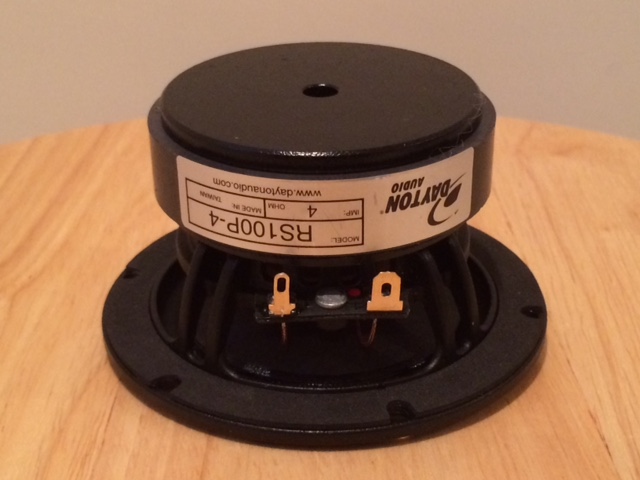

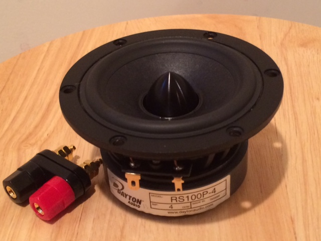

If you are interested in the Aucharm (or sometimes sold as "Air") have a look at Dayton RS100-4 or RS100P-4 (paper cone). They are extremely well built, have a cast metal frame, a nice motor, solid aluminum phase plug, vented spider, low distortion, huge 4mm xmax, built-in foam gasket, a thin bezel that doesn't require fancy rebating to mount, and best of all a Qts of 0.53 - perfect for deep bass on a MLTL (or the XKi 6th order band pass alignment). They are well priced at $29 (aluminum) and $33 (paper) and easy to get in the US through PE. I have not built a Tabaq with them but imagine they might be one of the best performers given the Qts and large xmax (which you won't find unless you go up to a Sd=50cm2 class driver that costs more). Of note, I have not seen anyone use the paper cone version except myself and I have to say I really enjoy their sound. It doesn't have the sparkle above 14kHz, but for most music, I think it sounds wonderful.
Dayton Audio RS100P-4 4" Reference Paper Woofer 4 Ohm
Here are some photos to give you an idea of build quality for a $33.
Here is a sound clip of one from an XKi - note the deep clean bass.
